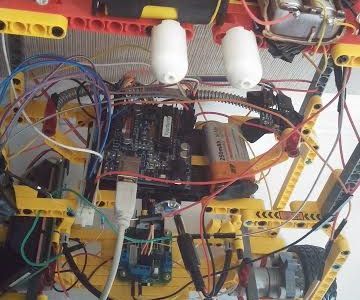

Step 1: Lego Frame
make a lego frame using Lego - Technic - 9398
Step 2: Componants
arduino Uno
DS3231
LCD 1602 x 4 Lines 20x4
Buzzer
4 Push Button
Jumper
Humidity Sensor LCD I2C Arduino
Step 3: Connection
DS3231 _________________________________
Vcc 5 V
GND GND
SDA A4
SCL A5
LCD 1602 _______________________________
Vcc 5V
GND GND
SDA A4
SCL A5
Buzzer ________________________________
+ To 13
- To GND
Step 4: Buttons Connection
Button 1 To D2
Button 2 To D3
Button 3 To D4
Button 4 To D5
