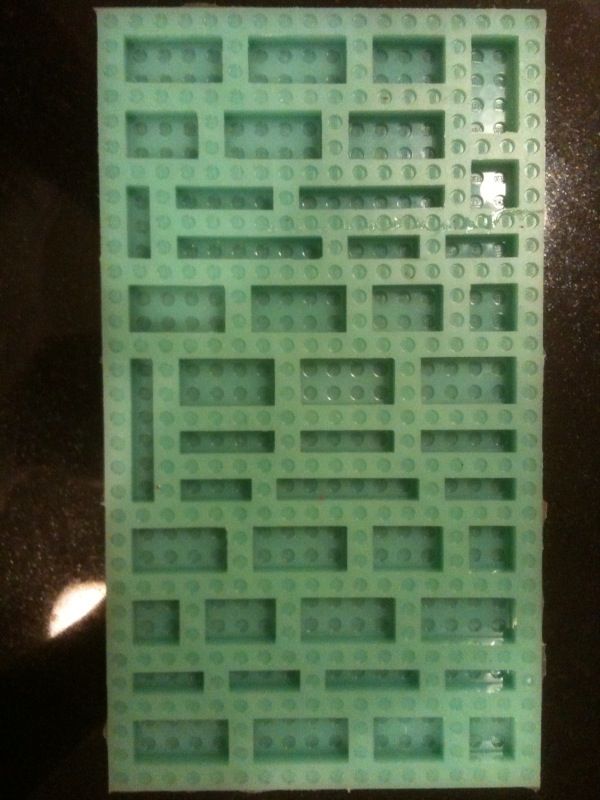

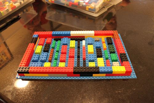

I made a silicone candy mold using Lego bricks. You don't need to make a custom mold. There are many commercially available silicone molds, or you could just skip the mold completely, and cut them with cookie cutters, a knife, or even scissors.

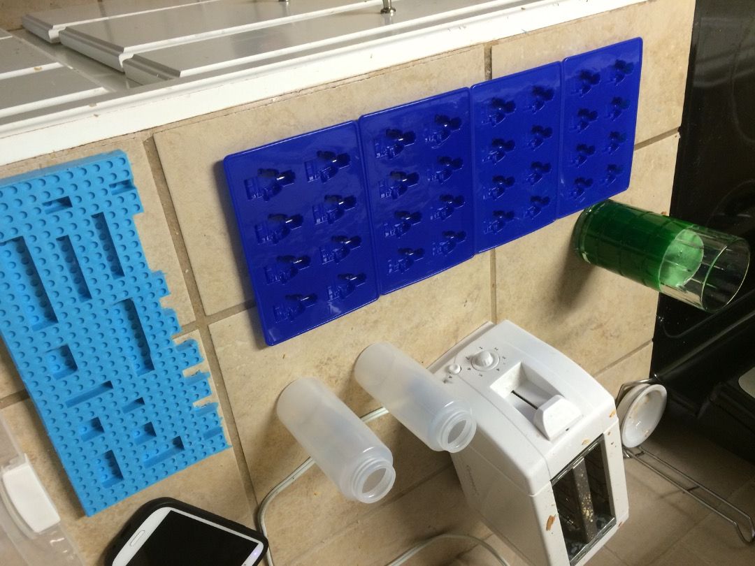

I'll explain in detail how I made the mold in step 4. It really is very easy. UserGabebillings made the mold and documented the process in photos. See the first comment under step 4 to read his experience and see his photos.
User ibeschierumade a "making of" video showing his kids creating Lego shaped gummy candies! http://vimeo.com/36217289

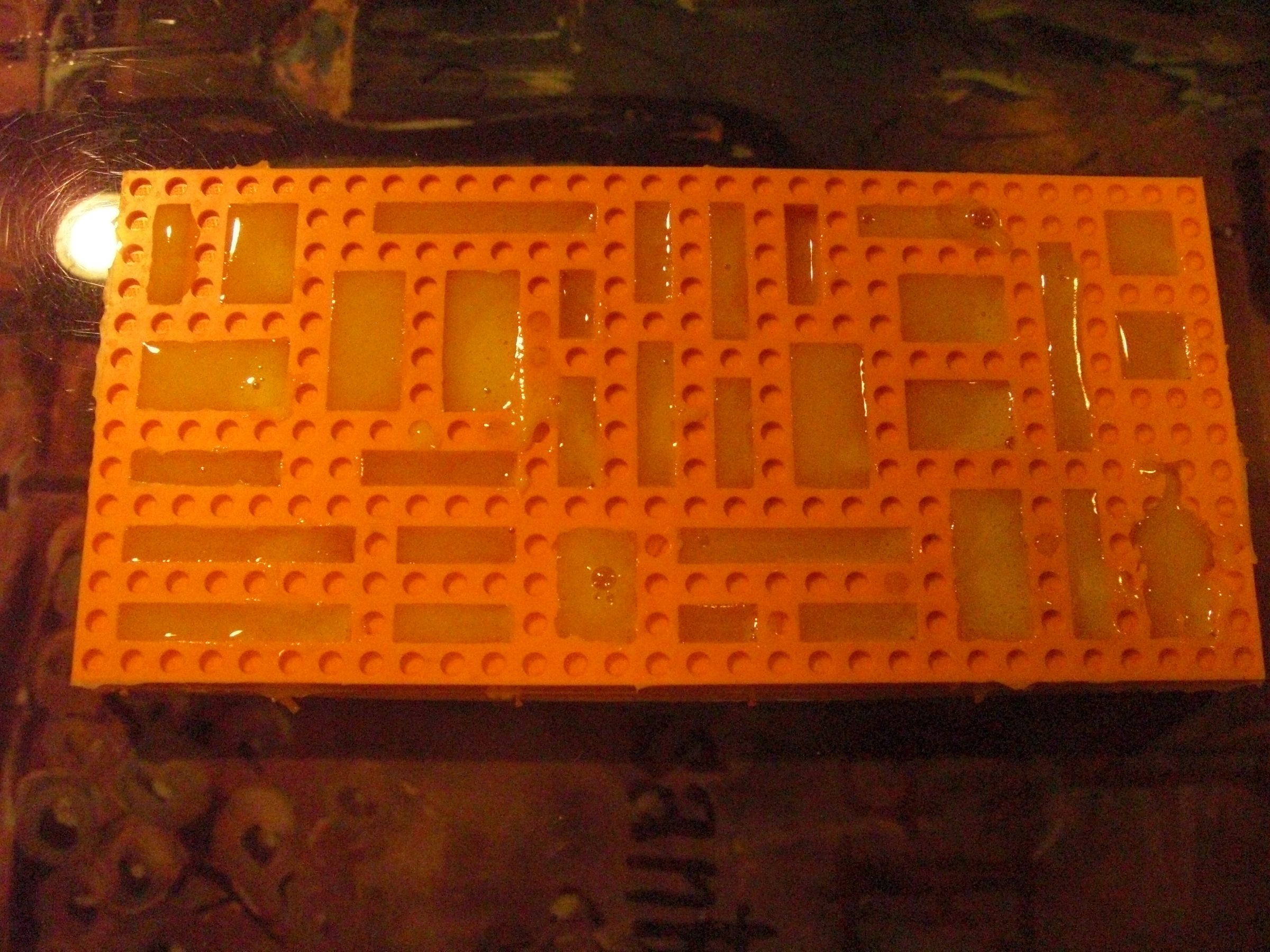

Now I put my syringe into the bottom of the cup and suck up all that clear syrup.
I use the syringe to squirt the candy into my mold.
(Step 4 has other ways of molding the candy).
If your mold won't hold all the syrup you made, turn the heat off and let the cup sit in the water while your first batch of candy is setting up. When you pull the first batch out of the mold, just turn on the stove and melt the syrup that is still in the cup the same way we did it the first time.
You don't need to use any kind of release (no oil or cooking sprays) with gummies. They will peel off of anything that is smooth. If you get some on your stove, floor, or counter, don't bother to try to clean it up while it is wet and hot. It's much easier to just let it set up and peel it off.
Most of the time when you make gummies you will not try to mold them in 360 degrees. The top side (which will be the bottom of the candies) is just left flat. I wanted to mold in little holes on the bottom of in my bricks so I could actually stack them.
The syrup contracts quite a lot as it cools. I had to fill the mold, then go back through and top them all off again as it would shrink way down. When I got them all full, I took the base plate (the same one I used when making the mold) and pressed it on the top of the mold, squeezing any extra goo out of the sides. Then I let it sit on the counter top for a couple of minutes. I do that, just so the stuff that leaked out the sides would set up and it wouldn't get all over my freezer when I put the mold in there.
I put the mold with the lid (base plate) into the freezer. You only leave it in the freezer for 10 or 15 minutes. If you are going to leave it longer, or you think you might forget it, you can just stick it in the fridge. It will be fine there without any worries about leaving it too long.
These candies actually do not need to be refrigerated at all to set up. You can just leave your mold on the counter at room temperature and they will still set up. I use the freezer to get them done faster.
Once they are set up, take them out of the mold. Clean them up if they need it, and you are done.

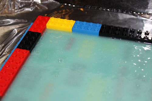

Step 4: Molds

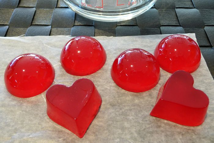

You don't need to make a custom mold like I did to make gummy candies. There are many great silicone molds available. They are used for making candies, baking, molding butter, making ice,...
It doesn't have to be made of silicone either. A regular Ice tray will work too. Any thing that has a flat and smooth surface should work fine. I read a suggestion, by a Mom on some recipe site, to pull the rack out of your toaster oven, put a piece of foil on it, and push the foil down through the slats. She made a gummy worm mold that way.
This stuff is very forgiving.
Pour the candy in a flat pan and after it has gelled, then just slice it into squares, rectangles and triangles with a knife. You could cut shapes out with cookie cutters. You could even peel the sheet off in one piece, and cut it up with scissors.
Whatever you do, I'd recommend you keep them pretty small. If you are using an ice tray, or a butter mold, or any mold with large compartments, don't fill it to the top. Just fill them up to around 1/4 or 1/2 an inch.
You can make Mega-Gummies if you really want to. Ever wanted a gummy the size of an Ice Cube? Go ahead. It will work fine. Want one shaped like a Banana? Go ahead - just don't tell me what you plan on doing with it.

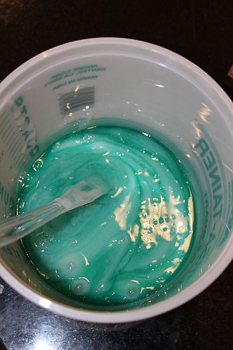

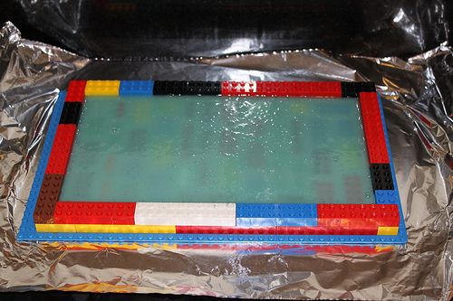

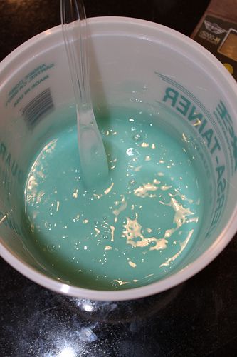

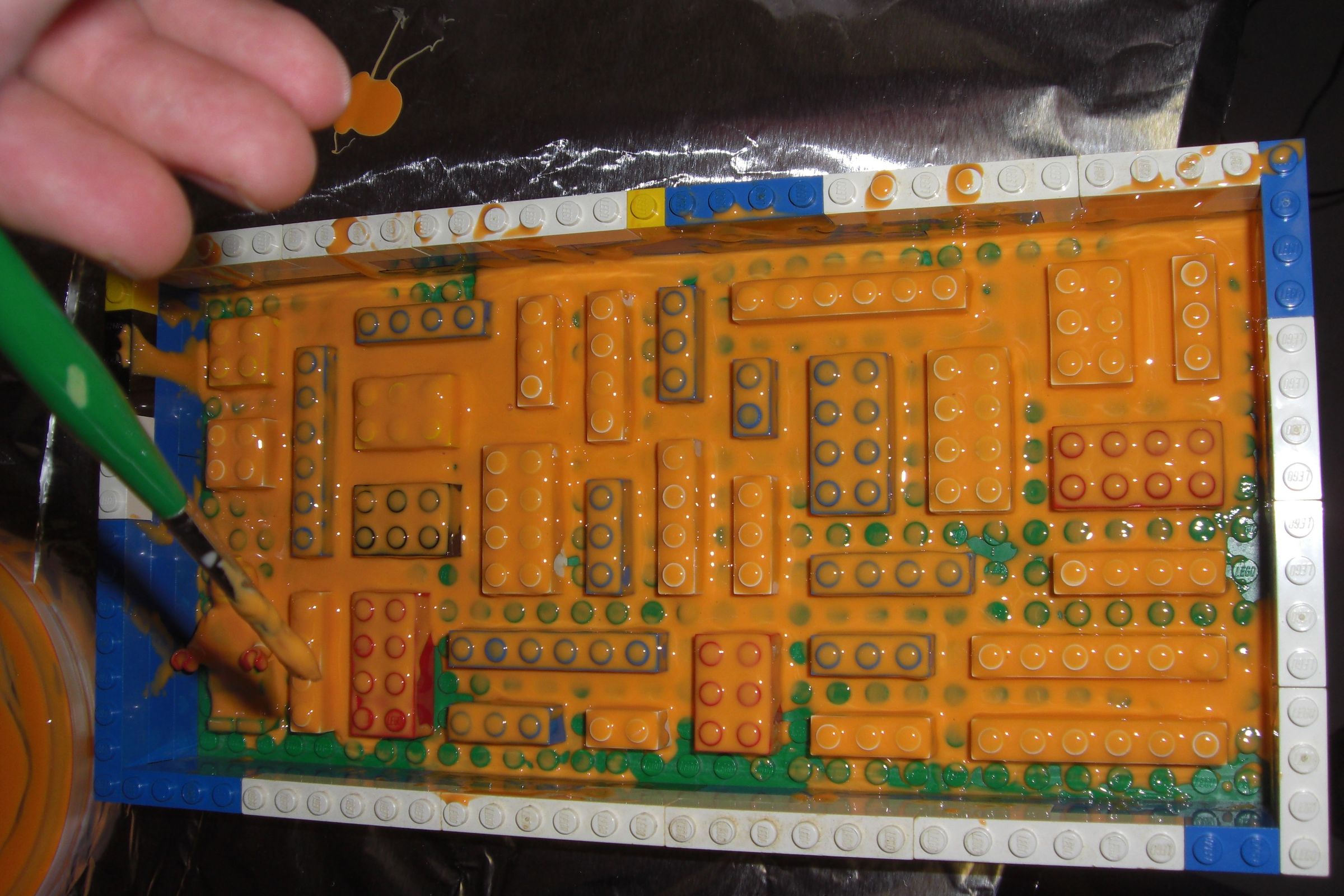

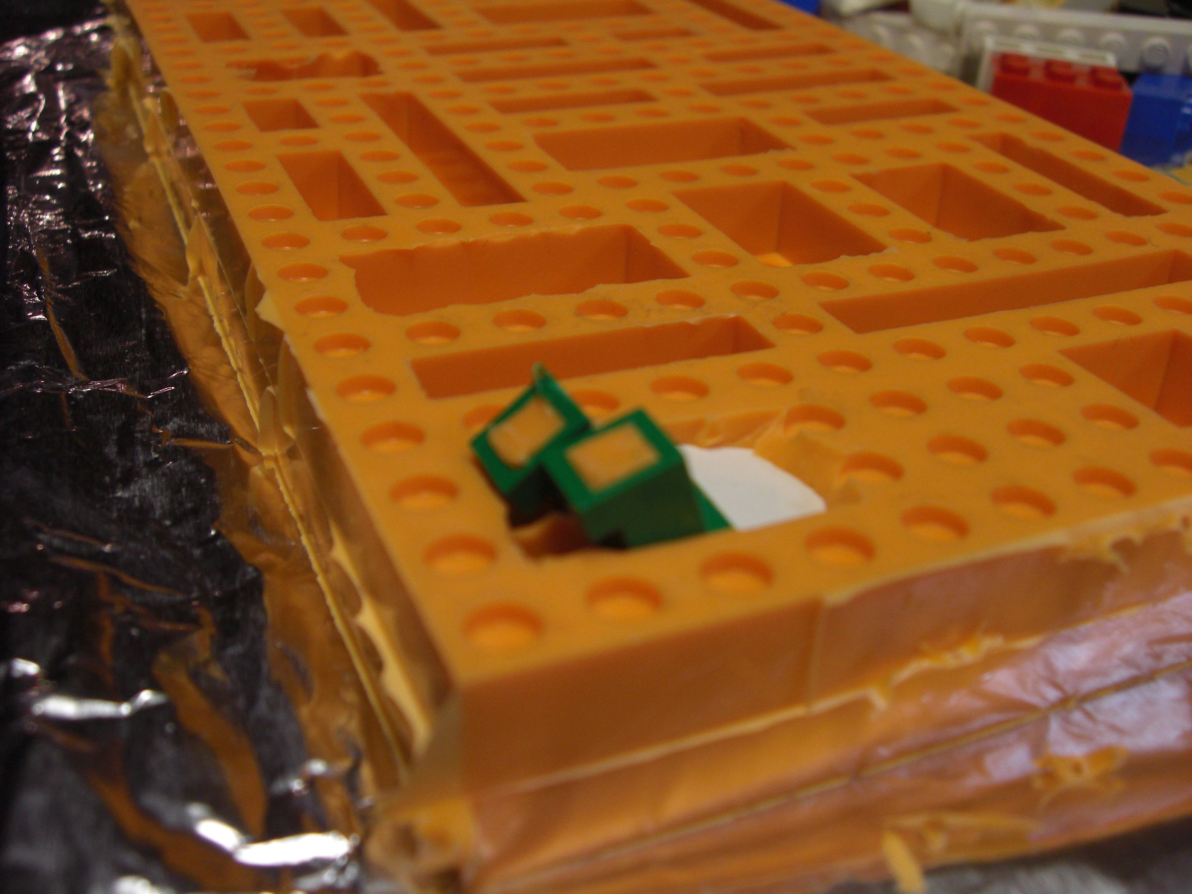

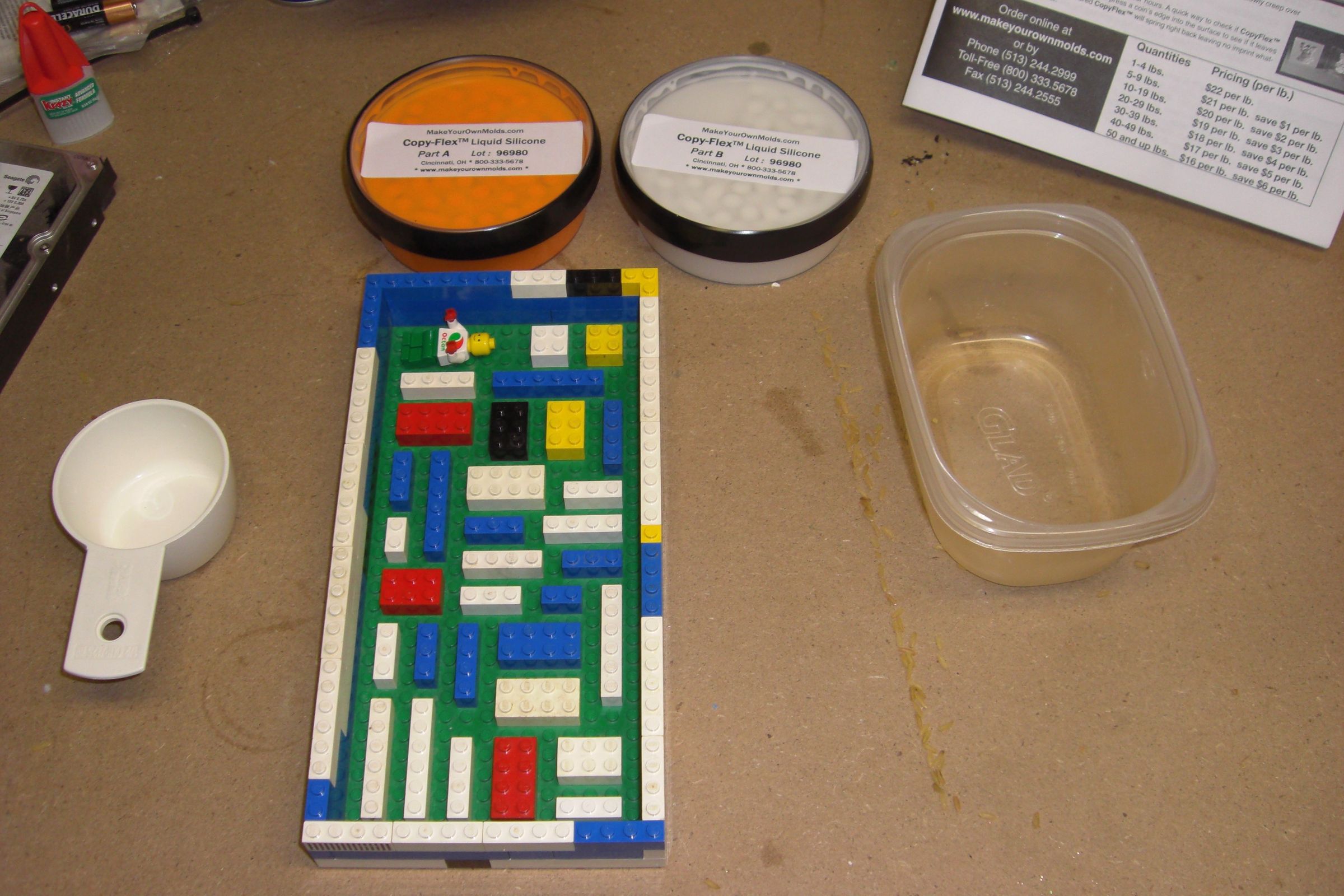

I purchased Food Grade Silicone fromDouglas & Sturgess. They are a Sculpture Tools, Materials and Supplies store in San Francisco. They are really great folks and have some incredible casting materials that you can't find anywhere else. I bet you MythBusters buys their Ballistics Gel there. Well, I guess I shouldn't bet. Where they bought it is probably on the web, and I've already spent enough money on this project.
The number I used is FGS-2237 Food Grade Silicone. (There is a new number MC-1287) Here is a link
You need two parts. Part A is the silicone gel and part B is the catalyst. They sell it as a set. This is a 1 lb. set.

I wanted my tray to not waste any space. If I left more than a single peg between each candy piece I'd be wasting the silicone.
When I got the Legos - I built the Taj Mahal - I couldn't resist! Have you seen it? It's amazing. 5,922 pieces.
So three days later, after I finished the Taj, I started taking it apart to get my candy mold pieces.
I put the pieces on a tray, and ringed the tray edge with a double stack of pieces to act as a wall and hold the silicone in (there is a photo of it below). Legos are made so well, that they really fit tightly together. I found that I didn't have to seal any of the cracks between the pieces inside.
Silicone will not stick to Legos. So you don't need to put any kind of mold release on the positive.
Just stick the pieces in there and make sure you stick them down really good.

Mix your Part A and your Part B with something plastic. The catalyst is blue and the silicone is white so you can tell if you have it mixed. Scrape the sides and bottom as you do it. You want to be careful not to mix any extra air into it. Does that sound familiar? Just like the Gummies!
If you really want to make a perfect mold then you have to "de-air" the silicone. As this involves putting it in a vacuum chamber and most of us don't have one, you can just skip that step. There are lots of tips on the web on how to get the least bubbly silicone castings.
You will pour the mixed silicone over the positive. Fill the tray up until you cover the tops of the pieces.
Pour slowly and don't move the Silicone back and forth like you are drizzling on frosting. That will leave air bubbles in the corners around your pieces. Pour it in a stream that hits the bottom of the tray - not over the Lego pieces, and let it flow around the tray and fill it up. This will help you avoid trapping any air.
Silicone is pretty good about releasing bubbles so you probably will get a pretty good mold.
I'd tap the tray a few times, and I've even held a back massager against it to help it release any air. You need to be very careful, that any of this tapping, or vibrating doesn't loosen any of the pieces inside the mold. I did a test piece and when I was tapping it, one of them floated to the top! I just grabbed my plastic spoon and pushed it back down. The only problem it caused was I wasted silicone, because the inside filled up. Avoid that by making sure your pieces are stuck down really well before you pour in the Silicone.

Let the silicone set at least overnight, then just pull the Legos out of it. They will come out very easily. Let it set up for 24 hours before you use it. I put mine in the oven at 175 degrees for about 15 minutes after it had already been curing for 24 hours, just to make sure. It might not have been the right thing to do (I should have asked Douglas and Sturgess) but I knew they did that with some of the other silicones.
After you get the Legos out, just trim off any of the little bits that squeezed between the pieces. Wash the mold and you are ready to go.
Mold Options

HOW TO MAKE THE MOLD
As I was saying, I never had Legos and I still didn't have any when I decided to make this project. I visited the Lego website and found a set that I really wanted that had enough pieces for my mold and bought that. I planned what I needed with the Lego Digital Designer. It's a free software program you can download from Lego and it lets you build Lego stuff in VR. It will even count up the pieces for you and place an order.
Weigh the Silicone
To measure how much silicone you are going to need to fill the mold, you can measure it a couple of ways. The standard way is to fill the positive with water, pour the water into the plastic cup you are going to mix it in, and just draw a line on the cup at the water line. That is how much silicone you will need to fill the mold.
You can't let any water get anywhere near your silicone before you cast it though. If you measure your mold with water, make sure you allow plenty of time for it to get bone dry before you try to make your mold.
To avoid the water problem I used Lentils - yeah like in the soup - but dry ones. They have some really small black ones at the bulk food store and they don't put out any dust, so they are great for this. Just pour the lentils over your positive, then pour them into your mixing container. They don't mess your positive up at all. Then you don't have to worry about liquid spoiling your mold.
Put your plastic container - with the line marked on it, on your gram scale and set the scale to zero. That way you won't be weighing your plastic cup, just the silicone. Now pour enough of Part A to get up to your marked line. Don't just glop it in there, try to avoid causing any air pockets. Check to see how much the silicone weighs. Let's say it measured 350g. Because you use 10 parts A and 1 part B, you will need 10% of that weight in Catalyst or 35g. Zero (sometimes the button you use to do this is labeled "Tare") your scale out, with the silicone still on it. Then add the 35g of Part B right into the same container.
Mix it up
Pour it in your tray
Let it set up
Don't try to clean up the cup and tools right now. Let them sit overnight. Most of it will set up and you can just peel it off. If you find you have any sticky spots of silicone gel, you can clean those off by dabbing them with a little Catalyst. That will make them set up and you should be able to peel it off.
Now if you will excuse me, I have to go rebuild the Taj Mahal.
Step 5: Addendum: How to Get Really Clear Candies
ADDENDUM: How to get very clear candies
I figured out how to get really clear candies with almost no bubbles.
I started by straining my vitamin C through a paper coffee filter so I got most of the solids out. I ended up with a very sour liquid that looked like water.
The secret to clear candies is to melt it twice.
After the first cycle of heating, let it rest, and cool off in the refrigerator. Almost all of the bubbles will rise to the surface while it is cooling. When it is cool enough to handle, take it out of the cup (the foam layer sticks to the cup, just cut through it around the edge of the cup with a knife). Put some water in the cup to get that foam to soften up so you can clean it out before you heat the candy again.
Now take your lump of clear candy with the foam layer and cut the foam layer off. I found a clean pair of kitchen scissors works well. I call them "kitchen scissors" because I only use them with food and they stay in the kitchen. You can use any kind of scissors. I cut the big piece into chunks, then I trim the foam layer off.
I've also done this with a knife but you have to be really careful. I don't worry about getting it perfect. The bit of clear that remains on the foam can be melted down at the end to make some candies for the cook to eat after the main batch. When you melt the foamy chunks, you will probably find the clear part melts into a very clear layer. You can siphon that out with your syringe if you want. I just pour it in to about spoon sized circles on a silicone baking mat. Then I peel those dots up when they solidify and put them in a baggy for me to eat. They taste just as good.
Melt all of those clear chunks. No real need to stir it while it is melting. I leave it alone so I don't add any bubbles. I just give it a gentle stir at the end before I suck it up into the syringe.
This technique makes amazingly clear candies. I have two pyrex cups so I make a second batch while the first one is cooling, then while No. 2 cools, I cut the foam layer off No.1 and melt it for casting.
