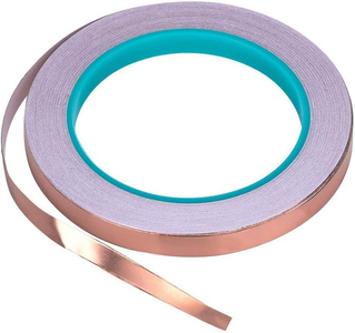

  • Copper tape (I use 5mm width)
Amazon - Copper foil

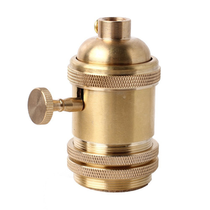

  • E27 Light fitting
Amazon - E27 Brass Fitting

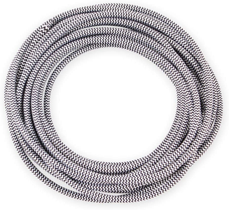

  • Fabric Cord
Amazon - Cord

Peel off the adhesive protection paper and start sticking it on the side of your glass pane, making sure the tape is centred on the edge. I find it easier to do each side separately than trying to stick it around the corners.
Don't worry if you have a tear or wrinkles as the solder will cover the imperfections. The most important part is to make sure all joints overlap or you will be left with gaps in your solder.
With the tape stuck onto the side I take either a piece of leather or cloth to rub down the tape well making sure it adhered well, do not do this with your bare fingers!
Trim any untidy bits with a sharp hobby knife.

I start with the brass screw on nut that comes with your light fitting, then cut four pieces of the brass rod.
Now you want to solder each of the of the four rods around the brass nut spaced out equally. I find it easier to first place four blobs of solder on the nut where the rods will connect and then tin the tips of the rods with solder, that way you can just heat up the joints to attach the rods without needing to add solder as well.
With the rods soldered to the nut you can place it onto your leaded glass pendant, centre it and mark the excess rod and snip it off using some wire cutters.

Start by connecting the cable inside of the lamp fitting (seek advice from a trained electrician if you are unsure).
The cable is then threaded through our 3D printed Ceiling fixture and the fitting is screwed into the finished leaded glass pendant.
