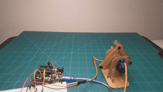

Step 1: Follower Leg Overview
The first component we will build is the follower leg. This leg is controlled by an Arduino microcontroller and moved using two servo motors.
To build the follower leg, you will first construct the leg out of cardboard. Then, you will attach servo motors to the leg that can be controlled with an Arduino. Finally, using the provided sketches, you will see how different servo commands can move the leg along specific paths like ovals and lines.

Step 4: Build the Motor Mounts
Use hot glue to secure the servos into the rectangular holes on each side piece. The servo motors should be oriented as seen in the image. Also glue in the side braces as shown.

Step 7: Attach the Follower Leg
Attach the follower leg assembly to the servos as shown by pressing the servo horns onto the servo motors. The leg should be attached to the motors in a slightly bent position, with the base leg linkages at approximately 45 degrees. The servo motors should also still be at their 90 degree positions. If this step is completed correctly, the follower leg should be able to move freely without crashing into the base mount. Don’t worry if your leg crashes or moves unexpectedly when you first try this step. You will likely have to remount the leg at least once to get the full range of motion. Just keep experimenting!
Step 8: Control the Follower Leg
You have fully constructed the follower leg! To connect it to the Arduino, plug it back in using the same diagram as the servo setup step. Red and black wires to 5V and GND respectively, yellow to PWM pins. Reference the diagram above for a single servo connection (you will need to do this for both).
With the leg connected to the Arduino, download the attached sketch to control the leg. See if you can get the leg to move straight up and down, then get it to move in a circle. The comments in the code will highlight where to make changes. If you cannot figure it out, that is alright. Building the leader leg will provide insight on how to do this.
