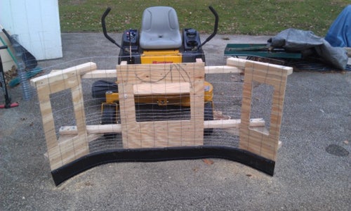

After blowing and raking most of my leaves for the year, I got the idea to add a plow to the front of my new zero-turn mower. I had used the mower to plow some leafs with the cutting deck lowered, but this was somewhat limited in effectiveness.
This was made for a Hustler Raptor, however, I assume it would be easy to adapt to other zero-turns or perhaps a lawn tractor.
After just some initial testing, I very happy with the results.
I hope you find this Instructable useful.

Step 5: Wheels, Plywood Face Pieces and Bracing
I started with 1/4" plywood but had to switch the bottom plywood to 3/4" and make the triangle larger to mount the swivel wheels (later step). The wheels are 8" pneumatic swivel wheel from Harbor Freight and cost $13.99 each. Wheel are secured with 5/16" bolts.
Plywood face panels were secured with wood screws to the horizontal and vertical frame members to provide rigidity. Then center portions of the panels were drilled and cut out to lighten the plow.
Plastic landscape edging was screwed to the bottom of the plywood panels to act as a sweep which can contour to the uneven ground surface.
Wire mesh was added over the plywood panels

Step 7: All Done
Just testing the plow around the yard, I found it was quite easy to plow 3-4 feet high piles of leaves.
See video link below for a walk-around and plow in action.
