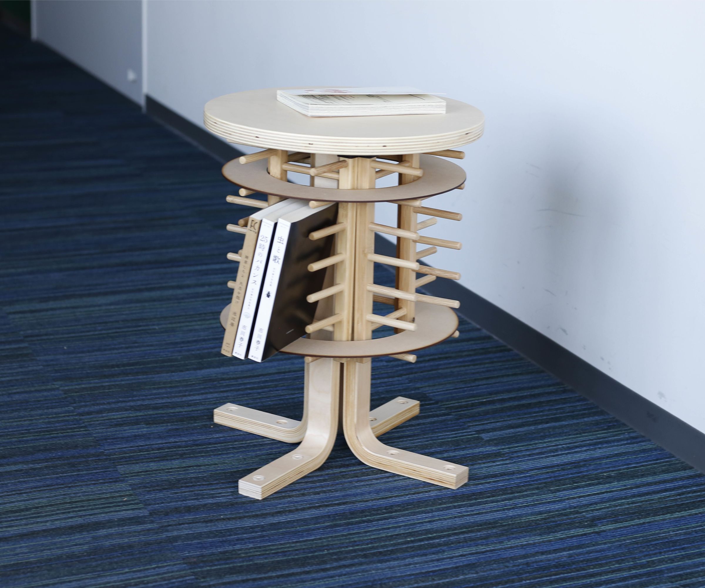

This stool's top board is shaped leaf.
It is easy to carry because this can disassemble when you want.
Materials:OSB(11.5mm),MDF(5.5mm),round wood bar(Φ24*450mm),screws
Tools:rhinoceros,laser cutter machine,CNC,3D printer
This idea is based on my teacher, YAMASHITAKEN's work:
https://www.instructables.com/id/KUMU-Stool/
Step 1: Making the Date
Make the date by rhinoceros.
Step 2: Cutting Materials
Cut MDF by laser cutter machine and OSB by CNC (I used handibot).
After cutting OSB, make wood edge smooth with the electric sander.
Step 3: Making Caps
Make caps for legs by 3D printer.
Step 4: Bonding
After bond MDF and OSB with wood grew, cramp tight.
Step 5: Assembling
Assemble all parts with screws and wood grew.
Step 6: Finish!
