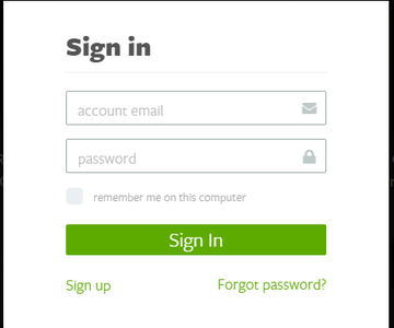

To install it, go to Leap Motion's Orion page and click on the Orion Beta button to download. It will ask you to sign in, so if you don't have an account yet go ahead and set one up. Then hit the button again once you're signed in to download the file to your pc.

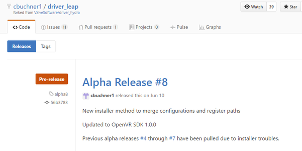

First, the easy part. To install the driver, first go to this page: GitHub Driver Releases and download the latest Leap Release driver (as of posting this it's Alpha version #8. Will probably be updated) to your PC. There are several items, so make sure you download the .zip file.
Once again, unzip the file and use the setup.exe file located inside to install the drivers!

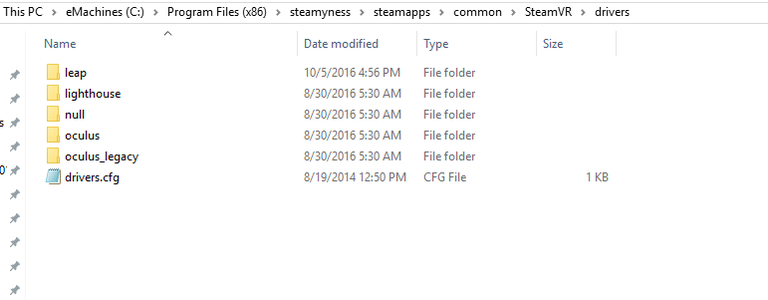

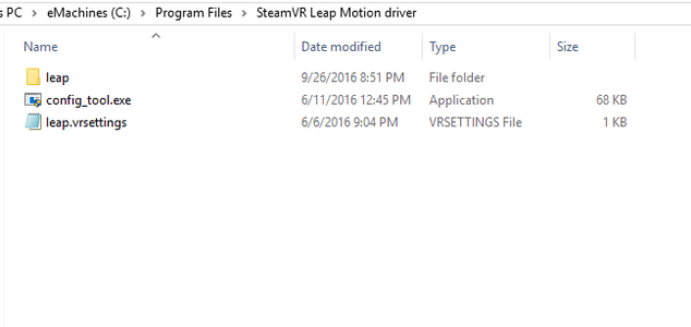

Ok, now for the weird part. So when (at least on machines I've heard of) the Leap Motion Drivers install, it places them in a folder in Program Files, but doesn't actually install them in SteamVR, where they need to be.
So in the first picture above, you can see a folder named leap, right? Copy that. (your C: drive name will be different, no worries. {Yes, I know, my OS is originally from an Emachine. Derp. It's not on an Emachine anymore}). Then we need to navigate to the drivers folder of SteamVR, where all the plugins for Lighthouse tracking and the Oculus Rift go. When we paste it there, we'll gain controls in SteamVR with our LeapMotion! It's pretty simple, just a strange way to go about it.
Up in the second picture above you can see an approximate file path to your SteamVR drivers folder (the steam folder is probably just named steam for you, not steamyness. I installed my Steam twice cause the first one glitched and I couldn't name it the same thing twice for some reason.) Go there and paste in the Leap folder you copied before. Now you're ready!
Simply quit out of and restart SteamVR and you should be able to see your hands as HTC Vive controllers when you put on your Rift! Have fun!
