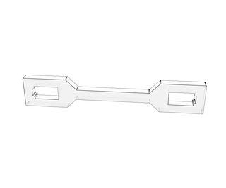

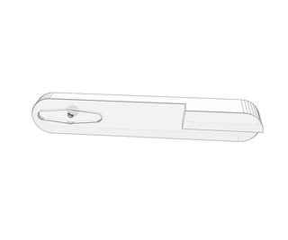

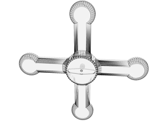

Step 2: 3D Printing
Download the 3 STL files for a robotic arm.
All modelling credits goes to this instructables from which we took the files.
https://www.instructables.com/id/3D-Printed-2-Serv...
You download them there or here.
