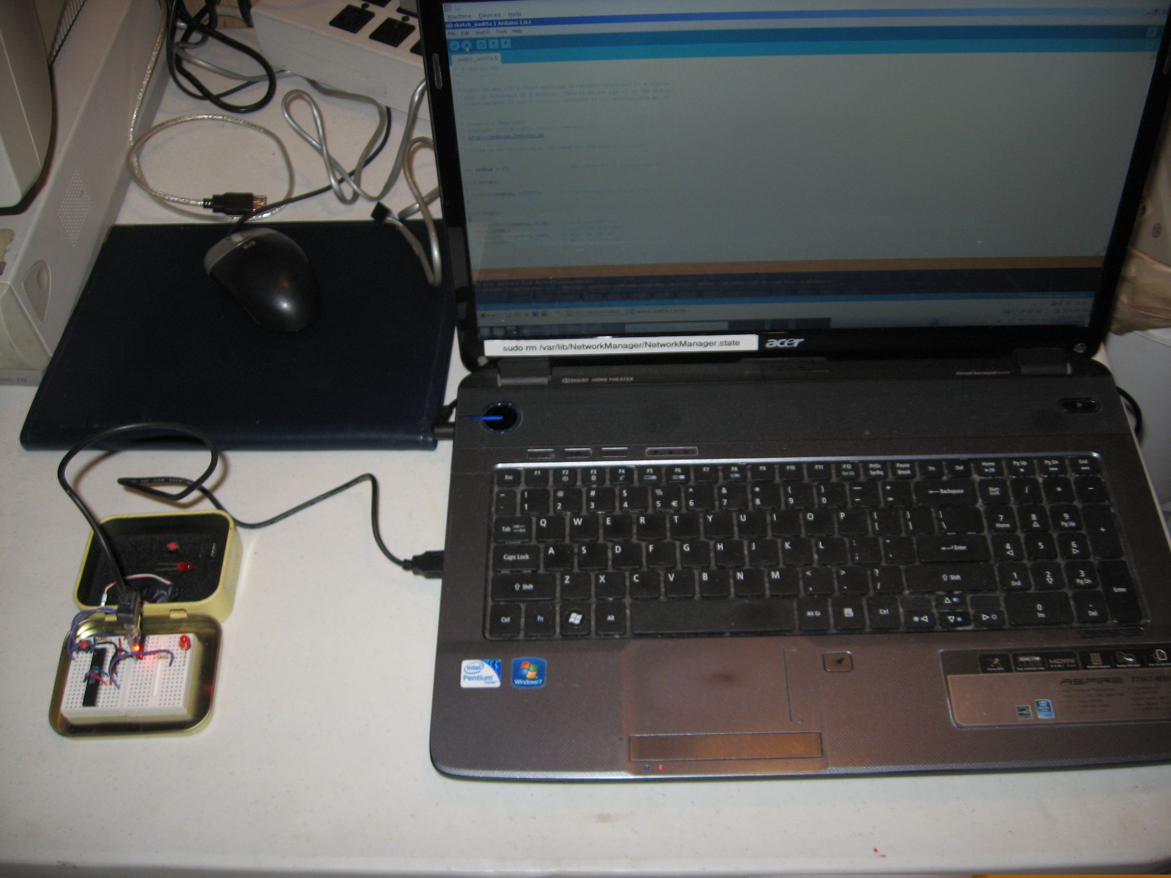

Step 4: Let's Build This Thing.
Start off with a breadboard.
If you do not want to get a kit, you will need to build your own Development Kit (dev kit.) The best start for your dev kit is to use a solderless breadboard. If you do not know what a breadboard is, take a look at my breadboard page: http://projects.granzeier.com/what-is-a-breadboar... (page is being updated - please check back soon.) You will want to use the pictorial diagram above to see where to place the jumper wires. You will only need three components: the programmer connector, the ATtiny2313 itself, and an SPST, normally-open, momentary pushbutton switch for the reset button. I used one of the AVR Breadboard Adaptors (https://www.tindie.com/products/granztronix/breadboard-avr-isp-adapter-kit/,) but you could also use The Real Eliot's USB Ghetto Development Environment (original 'ible was deleted, wayback machine link: https://web.archive.org/web/20130122122222/https://www.instructables.com/id/E5H5UDWB5UEUKIKV8V/, Eliot's updated article is: https://www.instructables.com/Ghetto-Development-Environment/) or any other AVR programming system.
Once you place the components on the breadboard, it's just a matter of connect the dots. You may want to double-check your connections using the AVR ATtiny2313 datasheet (http://ww1.microchip.com/downloads/en/DeviceDoc/doc8246.pdf - the 2313 and the 2313A are very similar, there will be no difference in the wiring. You will just need to make tiny changes to your program (every place that the program mentions Tiny2313A, you will just use Tiny2313 if you use the older chip.)

Step 8: This Little Light of Mine...
Most programmers, when they are learning a new programming language, will start with a program called the “Hello World” program. This is nearly the simplest program that may be written in a language for any given computer. All it does it to output the phrase: Hello World onto the output device. It’s only purpose is to provide a very quick success and show the new programmer that the language does indeed work. In the controller world, it turns out that there are far simpler things to do than output some text. In fact, sometimes it can be downright complex to output text, so we do something much simpler.
The Hello World equivalent in the microcontroller world is simply lighting up an LED. For this Hello World experiment, first study the schematic diagram above. A schematic diagram is simply a picture representing an electronic circuit. At the top of the schematic, we have an arrow pointing to the right. This symbol represents an input (to the circuit) from the Tiny2313’s output pin. From there, we have a line going to the right a bit and then turning down. This simply represents a wire connecting that input to the next component. That component looks like a triangle with a bar across the bottom point, and a couple of small arrows to the left. This symbol represents a light emitting diode (LED); this device, as we mentioned above, gives off light when current flows through it from the bottom (with the bar) to the top. There is another wire from the bottom of the LED to the top of a zig-zag symbol. This zig-zag symbol represents a resistor; the resistor protects the LED and the Tiny2313 from too much current. Finally, there is another wire going to the symbol of 3 horizontal lines; this represents ground, or the negative terminal of the battery.
Now, using the pinout diagram of the Tiny2313 above, you need to connect a jumper wire from Pin PB.0 on the Tiny2313 (top row, second from right,) to anode of the left-most LED. The pictorial diagram above shows the LED wired up with a blue wire. Now, don't laugh too hard - after all, I am an engineering professional, not an artist. Anyway, go ahead and plug the short jumper wire into the breadboard. This is all that you need to do to prepare for your first microcontroller program.
