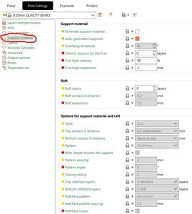

Like the slideshow from earlier demonstrates, we will change our plater into "Expert" mode and go to the "Print Settings" menu. Image #1 will show you where to find both, which are also circled in red.
Once in the "Print Settings" menu, you will click "Support material" which I circled in red, also found in Image #2.

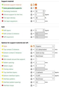

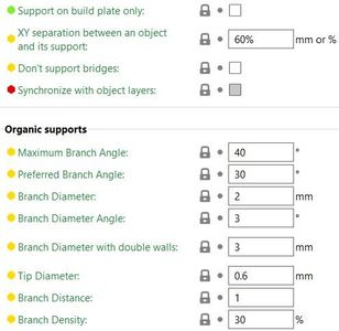

If you are seeking more info about specific settings, please check the slideshow from earlier or go to PrusaSlicer forums. If you just want to move forward with my settings, please just make sure that all of yours match mine in Images #3 & #4.

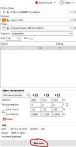

Now that you have updated and prepared your support settings, you need to set your detail and printer properties when you go back to the "plater" screen (There's more info on my powerpoint from above about detail settings, should you need it). For this demonstration, you will use my settings to start the print. These can be found in Image #1. After these are set, click the "slice" button, which can also be found at the bottom of Image #1.
After these set-up steps are completed, you will be met with screen in Image #2.
