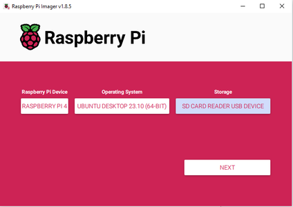

Step 2: Installing Imager
Install and run Raspberry Pi Imager, For the section “Raspberry pi device” select your Raspberry Pi version. The imager can be found at https://www.raspberrypi.com/software/
Step 3: Choosing OS
For the section “Operating System” the Linux distribution select the Linux Distro you’d like to install. I would recommend installing Ubuntu Desktop as it is very user friendly and can be found in the other general-purpose OS section of the imager, the default Raspberry Pi OS is also a good choice.)
Step 4: Choosing Storage
Finally for the section “Storage”, select your MicroSD card reader device or MicroSD card.
