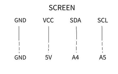

Building the Screen
GND --- GND
VCC --- 5V
SDA --- A4
SCL --- A5
  1. Connect your first wire to the GND space on the screen. Place the other end on the last remaining ground hole on the board (Photo 13).
  2. Connect the next wire to the VCC space on the screen, and since the 5V is being used by the resistor, connect the wire to the same line on the breadboard as the resistor and the wire that is connected to 5V (Photo 14).
  3. Then connect a wire to the SDA port on the screen and the A4 port on the analog part of the Arduino (Photo 15).
  4. Finally, connect a wire to the third and last wrung on the screen, the SCL, and connect the other end to A5 on the Arduino (Photos 16 and 17).
