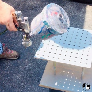

Step 4: Use a Jig
Tip: Use a paint jig to spray on. Hubs makes various sizes of jigs for different paint spraying projects but they all have one thing in common: pre-drilled holes with dowels.
The first jig you see above is totally configurable. Hubs drilled holes with a drill press every inch. Because project sizes vary, he has the option to install the dowels anywhere he wants to accommodate the size of the project.
The second jig (2nd pic) is for larger projects. It only has holes in the 4 corners. The advantage of have your work suspended on dowels is that you won’t get spray-back of paint on the underside of your work.
I’m starting on a small project using a piece of pegboard scrap, so we’re using the smaller paint jig (4th pic).
As you’ll see when you watch the video, Hub covers the actual base of the jig with kraft paper to keep the overspray off of the empty holes for future use. Position your dowels onto the jig where it will best fit the size of your project by pushing them through the paper. He also covers the top of the dowels with masking tape to keep paint off them. That will extend the life of your dowels; with paint buildup over time, they’ll no longer fit into the holes!

Our Devilbiss cup gun has two adjustment knobs. The bottom knob can adjust the trigger to manage the amount of paint that comes out of the gun. The upper knob adjusts how big the fan width is. It can be tiny or as big as 6". Typically if you take the width of your hand, at roughly 6" away, you want the width of a 6" paint brush. Therefore, 6" out, you want a 6" fan of spray. In the second and third pics, my husband is testing the spray on a scrap piece of board before I start painting our actual (pegboard) project.
Paint Gun Technique
Start with air coming out of the gun – off the project – by lightly pressing the trigger. With the paint gun 6″ above the surface, ensure that it is perpendicular to the work – straight up and down, not at an angle.
Then as you move toward the edge, fully press down the trigger to release paint. As you come off the other edge, lessen the pressure so once again only air is coming out of the paint sprayer. Then repeat, spraying back in the opposite direction, overlapping the last pass by 50% to get even coverage.
