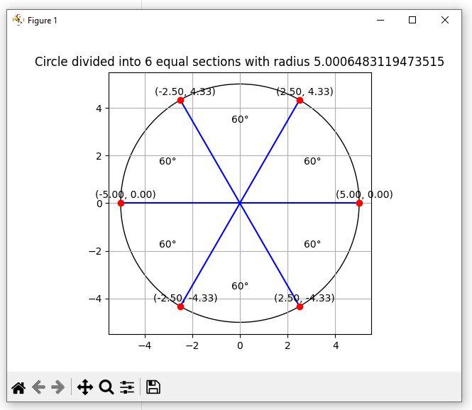

In the Sprit of the contest we wanted to used "Matplotlib" in Python to calculate the points where the lasers angle needs to adjust based on height to create intersecting points. The intent was to have the lasers rotate to their positions to intersect at various heights. Perhaps this will be in another Instructable. We must first install all the python library. A few libraries like Numpy and Math are already installed so there is no need to install them. The below simulation will use Python and PI to locate the points where the lasers would potentially rotate and angle. Happy Constructing!
  1. sudo apt install python3-matplotlib
  2. num_sections - indicates the selected sections provide by user input
# Specify the number of sections and radius
num_sections = 6
circumference = 31.42 # You can adjust the circumference here
The below code takes the number of sections and the circumferences and then determines a series of points surrounding the circle from that location.
num_sections = 6
def plot_circle_sections(num_sections, circumference):
# Generate angles for the sections
angles = np.linspace(0, 360,
num_sections + 1) # Linspace divides the first two parameters evenly by the section numbers
# Plot the circle
fig, ax = plt.subplots()
ax.set_aspect('equal', adjustable='box') # Define the aspect ratio of the Grid
circle = plt.Circle((0, 0), radius, edgecolor='black', facecolor='none') # Define the circle
ax.add_artist(circle) # draw the circle on the Grid
# Plot the sections and their intersection points with the circle
intersection_points = []
for i in range(num_sections):
theta = np.radians(angles[i]) # Use the evenly spaced angled values and covert the value to radians
x = radius * np.cos(theta) # Claculate the x and y of each space
y = radius * np.sin(theta) # Calculate the y and y of each space
ax.plot([0, x], [0, y], 'b-') # Plot line from center to circle boundary
intersection_points.append((x, y)) # put each point in the array above
# Annotate with angle measure
angle_diff = angles[i + 1] - angles[i] # Calculates the angle diffrence
angle_text = f'{angle_diff:.0f}°' # Format the Text
angle_mid = (angles[i] + angles[i + 1]) / 2 # Formats Angle measure in middle
ax.text(radius * 0.7 * np.cos(np.radians(angle_mid)), radius * 0.7 * np.sin(np.radians(angle_mid)), angle_text,
ha='center', va='center')
# Plot intersection points and annotate with coordinates
for i, point in enumerate(intersection_points):
ax.plot(point[0], point[1], 'ro') # Plot intersection point
ax.annotate(f'({point[0]:.2f}, {point[1]:.2f})', (point[0], point[1]), textcoords="offset points",
xytext=(5, 5), ha='center')
plt.xlim(-1.1 * radius,
1.1 * radius) # add a gap between the edges of the grid and circle(ENSURES FULL CIRCLE STAYS ON GRID)
plt.ylim(-1.1 * radius, 1.1 * radius)
plt.title(f"Circle divided into {num_sections} equal sections with radius {radius}") # Grid Title
plt.grid(True) # Display grid
plt.show() # Show all
radius = circumference / (2 * math.pi) # calculate radius off of your pie using pi
