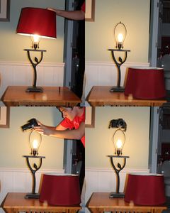

Step 1: Supplies Needed
For this project, you will need:
- Camera (does not matter what kind,)
- Tripod or a lamp with a lampshade- almost all lampshades are attached to the lamp with a 1/4 inch threaded bolt which is the exact same size as a camera tripod mount. So, no tripod no problem!
- Computer
- Lawnchair
- Intervalometer (helpful, but not necessary)
- A big chunk of time (at the very least, around an hour, otherwise, there might not be a whole lot of motion in your scene)

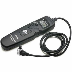

Step 2: An Intervalometer Is Helpful
An Intervalometer is a device which counts intervals of time. They are commonly used to signal, in accurate time intervals, the operation a device.
You plug it into your camera (if your camera has an input jack) to send a signal to take pictures at any specific interval of time that you want.

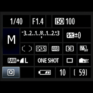

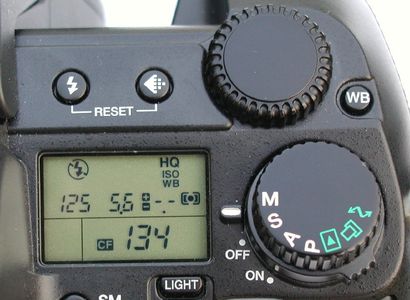

Step 5: Camera Settings
I'll start off by saying this: No matter what camera you use, you can set it to full automatic settings with no flash. If you don't have or want to use manual, you can skip the rest of this step. This is the easiest way, but if you have manual control, you can make your time-lapse more dynamic.
One thing that you will definitely want to do is to reduce the photo quality instead of using the highest resolution. If you don't do this, your memory card will fill up quickly and your computer will take longer to process large images.
For a point and shoot, your best option is to take advantage of the "scene" options that are almost always built in. Pick one that best describes your time-lapse subject.
Here is what you can do with manual controls on your camera if you have them and want to use them:
Make sure that you use manual focus, otherwise, your camera will try to focus before every shot and most likely miss shots because the camera doesn't know what to focus on.
For clouds, sunset, and sunrise, you will want to:
Set your aperture to f/11. Use the lowest ISO possible (usually 100). Change the shutter speed and review pictures until you you are satisfied with the brightness of the picture.
Take pictures with an interval between 5 seconds and a minute (the interval determines both movie length and how smooth your final product will look.)
For stars, you will want to:
Set your ISO to around 400. Set your aperture to a low f-stop (should be under f/7). Use long shutter speed that is at least 15 seconds. Take pictures at an interval of your shutter speed + 5 seconds.
If you have an Intervalometer, set it up with your chosen interval.
