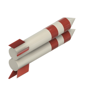

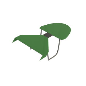

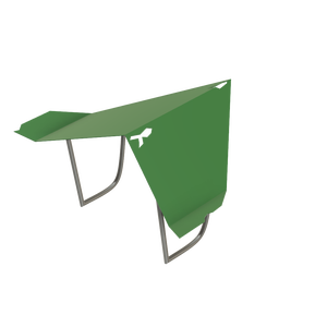

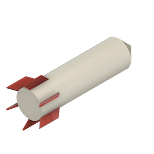

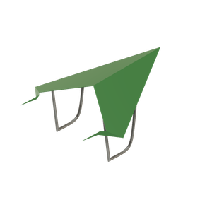

Step 1: 3D Models
A 3D game needs 3D models to go with it, so all of them need to be created first in Autodesk Fusion 360. I created models for all of the following:
  • Snow pile ramp
  • 3 gliders
  • 3 rockets
  • A penguin
  • Block letters for the title screen
It seems logical to keep the appearances of items similar while expanding them to 3 dimensions, so the way these models were designed involved looking at the art included in the original Learn to Fly game and designing the 3D assets accordingly. The penguin was assumed to be 1.3 meters tall, and everything else was sized according to match the appearance of the penguin such that the size proportions of all items were similar if not identical.
Attached are the f3d files of all of the models I used in my game. Open them in Autodesk Fusion 360 and export them as FBX files to use later in Unity.

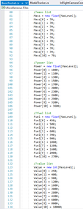

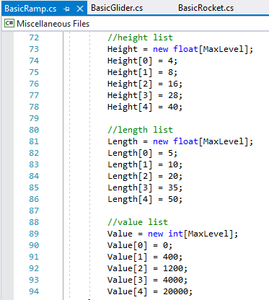

Step 6: Attaching Data to Items
One of the core gameplay features of Learn to Fly is the ability to buy a glider and rocket as well as upgrade them. Obviously, the more you upgrade, the better your items should be. Recalling the Thrust, Al, Cd, and Ac variables from earlier, they can be affected by attaching stats to the gliders and rockets that we have made. Stats should vary in some form with upgrade level on the items. My method of choice was to make a list for each variable that varies with level, and manually input a variable for every stat for every level - doing this gives me the greatest control over the item's stats in case any changes are needed. (It is also the slowest, though, so there are other valid methods of assigning stats as well.)
Learn to Fly features 3 gliders and 3 rockets (hence the requirement for the models in the 3D Modelling section). However, for simplicity, I have elected to merge them such that there is only one glider and one rocket that can change appearances depending on how many upgrades it has. Of course, this decision is entirely optional - the requirement is to make a data script for every glider and every rocket and use them to assign stats to the Thrust, Al, Cd, and Ac variables in flight. Also, make one for the penguin, as it is possible for the penguin to fly without anything equipped (albeit, not particularly well).
The snow pile ramp also requires a data script as it is possible to upgrade. Rather than flight variables, the stats being changed are the ramp height and length, which together enable our penguin to get a head-start on their flight.
Programming with Interfaces
(No, I don't mean the interface the player will use. I mean the interface syntax.)
Interfaces act as a class of sorts where any script can carry it, and the script can be called using this new "class". This bypasses a slight restriction in calling functions from other scripts where the other script has to know the target's class in order to make a reference and call a function. Simply declare the interface in any script and it can be used anywhere.
I have gone ahead and attached the data script for the "Basic Glider" item so you can get an idea for how it is structured. Instructables does not allow CS files as a valid file type, so you will need to change the file extension or copy-paste the text as code.

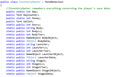

Step 7: Tracking Player Save Data
Some player data is required to be persistently stored. A script should be created with the variables to hold this data. This includes:
  • Money, as an int
  • Day Counter, as an int
  • Glider the player has purchased, as well as its level
  • Launcher the player has purchased, as well as its level
  • Rocket the player has purchased, as well as its level
  • For the previous three items, use a string for the name of the item, and an int for its level
As this is a rather short game, it is fine to reset the game data every time the game boots up. A completely clean save should have:

Programming with Interfaces (2)
Perhaps you were wondering why I felt the need to be able to call a function from any item data script regardless of its name. This enables our save script to declare a common class that all of the item data scripts share, which enables our save script to remember them inside a variable.
Attached below is the save data script used in my project. Instructables does not allow CS files as a valid file type, so you will need to change the file extension or copy-paste the text as code.

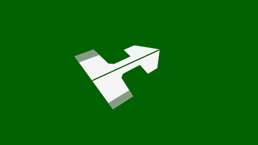

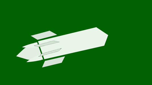

Step 9: Interface Art
Though much of the novelty of this project lies in the fact that it is simulated in 3 dimensions, it is still required for the GUI to be flat, which requires 2D art. Artwork appears inside the purchase pane and main window of the shop, as well as other places. GIMP was used to create the artwork for this project, although any vector art program will do. Every red box outlined in the large picture above is a spot filled with an image created for the interface.
That being said, not every piece of 2D imagery was created with GIMP. The thumbnails of the items seen in the colored panes are actually screen captures taken inside Autodesk Fusion 360.
