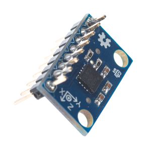

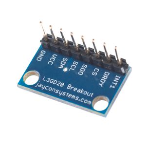

The L3GD20 Gyro sensor is soldered with 8 straight pins.
The soldered sensor will look like the two images above.

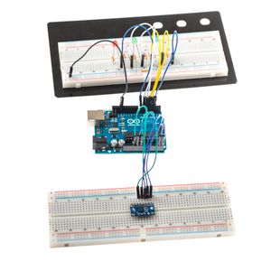

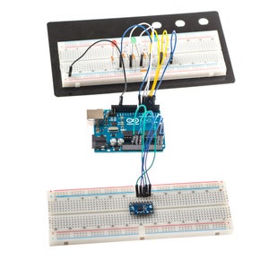

Step 3: Connections
  • VCC – 3.3V
  • GND – GND
  • SDO – GND
  • CS – VCC
  • SCL – A5
  • SDA – A4
  • Red LED – A7
  • Green LED – A5
  • Blue LED – A3
  • Yellow LEDs – A2, A4, A6
  • Use resistors to ground the LEDs' cathodes
The complete connection should look like the image above.

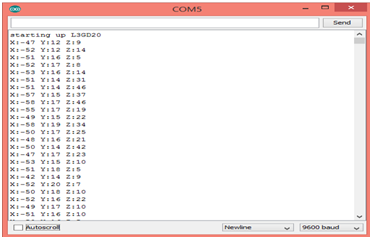

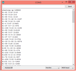

Step 12: Output - Flat
Once the code is uploaded, the output can be viewed in the serial monitor. When the sensor is kept flat, without any rotation, we get the following values shown above.

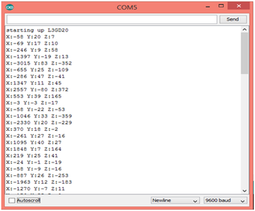

Step 13: Output - Z-Axis
When the sensor is rotated along the z-axis in one direction, the values of z will be negative and higher, and the red LED will turn on. When the sensor is rotated along the z-axis in the opposite direction, the values of z will be positive and higher, and the yellow LED will turn on.
The values are shown in the image above, and is demonstrated in the short video.

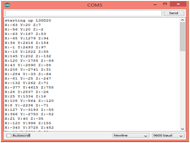

Step 14: Output - Y-Axis
When the sensor is rotated along the y-axis in one direction, the values of y will be negative and higher, and the green LED will turn on. When the sensor is rotated along the y-axis in the opposite direction, the values of y will be positive and higher, and the yellow LED will turn on.
Step 15: Output - X-Axis
When the sensor is rotated along the x-axis in on direction, the values of x will be negative and higher, and the green LED will turn on. When the sensor is rotated along the x-axis in the opposite direction, the values of x will be positive and higher, and the yellow LED will turn on.
