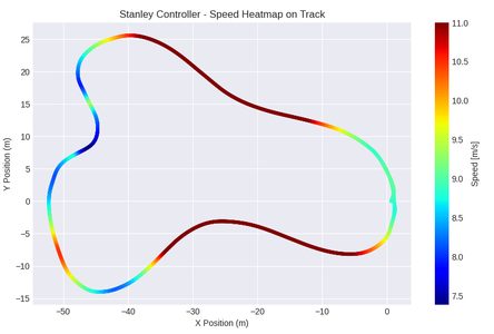

Step 4: Generating a Speed Profile From Curvature
What’s a Speed Profile?
A speed profile assigns a target speed to each point along the trajectory.
It allows the car to:
  1. Cruise fast on straights
  2. Slow down intelligently before sharp turns
  3. Smoothly transition between different speeds
Without it, your controller either uses:
  1. A constant speed (too dumb), or
  2. Reacts to turns too late (too dangerous)
Physics Behind Speed Limiting
To prevent the car from losing control in a turn, we use the centripetal force equation:
refer the table from this section above
Higher curvature → lower max speed
Lower curvature → full throttle
Smoothing the Speed Profile
Raw curvature-based speed may look jagged — and cars hate sudden acceleration or braking.
So we smooth it using a Gaussian filter or spline:
from scipy.ndimage import gaussian_filter1d
# Assume curvature is already computed
speed = np.sqrt(a_lat / (curvature + 1e-4))
smoothed_speed = gaussian_filter1d(speed, sigma=2)
You now have a smooth, safe, and fast speed plan for the whole lap.

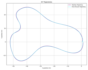

Trajectory Comparison
  1. Plot the baseline path vs the actual path driven by each controller
  2. Shows tracking accuracy and overall smoothness
plt.plot(x_baseline, y_baseline, '--', label="Baseline")
plt.plot(x_actual, y_actual, label="Optimized Run")
plt.legend()
Speed Profile (Planned vs Actual)
  1. Shows how closely the car followed the target speed
plt.plot(t, speed_planned, label="Planned Speed")
plt.plot(t, speed_actual, label="Actual Speed")

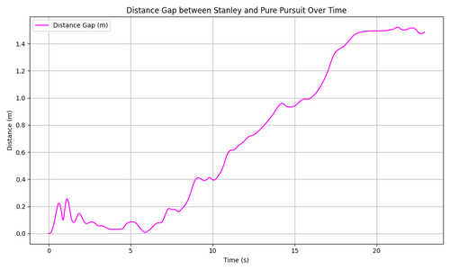

Distance Gap (Optional)
  1. Track how far the car deviates from ideal path (cross-track error)
6.3 What the Results Tell Us
These graphs and metrics help answer:
  1. Did our controller follow the optimized line well?
  2. Did the car slow down properly in curves and speed up in straights?
  3. Was Stanley smoother than Pure Pursuit?
  4. Where are we losing time — poor path? poor speed profile?
