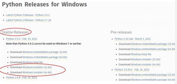

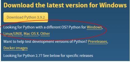

Step 1: Going to Python's Available Downloads
Travel to this link: https://www.python.org/downloads/ to download python on your system. Depending on your operating system (Windows, Mac, Linux), you will have to download a specific version of python. You should see this towards the top of the page. Click the “Windows”, “Linux/UNIX”, or “Mac” depending on what you are using. Since most people have a windows device, I will show the steps for that one specifically, but don’t worry because it’s the same regardless. Once you click the system you have, look for the title, “Python Releases for Windows”. Then a little below that you will see a subtitle that says, “Stable Releases”. This is where we are going to find the download we want.
Step 2: Figuring Out Which Installer We Need

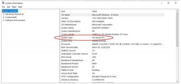

Now, we know the version of python we want, but we still have two options, the “windows installer (32-bit)” or the “windows installer (64-bit)”. This is easy to find out what one you need. Just hit ‘WINDOWS KEY + S’ and the windows search bar will pop up. Type “System Information” and hit enter.
You don’t have to click anything, the information is right there. Look 8 items down, and you should see
System Type” and then to the right you will see either a “x64-based PC” or a “x32-based PC”.
Depending on the number of your system type, that will be the python installer you will download. In
my case I will be doing the 64-bit version. Now just click the download button and wait for it to be done.

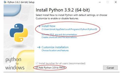

Step 3: The Installation Process
Once you download the installer, its now time to actually unpack python on your system and install it. The installation process is very simple, all of the settings will be kept at the default settings, and all you have to do is check one box, and choose where you want to house python on your computer if you don’t like the spot it suggests. Its not very big so just choose anywhere you feel is sufficient.
Start the Python Installer in your downloads file, or click the download at the bottom of your chrome tab to open it. Follow the red circles below to install Python. Make sure you select add Python to PATH, its optional but if you enjoy python you may need that feature selected in the future to install other software that enhances python development.
Once it says the installation was successful, we are in business. Close the installer.

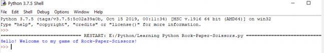

This is so exciting; you now just finished your first python line of code. To see if your program works so far, you must compile it. This is commonly referred to as “run”-ing your program. This is the step where the computer reads through the program and looks for any grammatical errors or values not initialized. These errors are called “compile-time errors”. You can now run the program and it will type that out. Let’s see if it worked!
Click the “Run” tab at the top of the window, 4th tab down. Then click, “Run Module” which means compile the program. You will have to save the file first and since this is our first save, we will have to select where we want to save it. Make sure to make a new folder called “Python Programs” or something to keep all your programs together. You can also just save the program to your desktop so you can find it easier later and then move it to a folder when you’re done developing the program. You can name the program whatever you want but just don’t change the save type, it will default to “.py” or “.pyw” which is the one we want. I named my program: “Learning Python Rock-Paper-Scissors”. Once you click save, it will take you back to the Python shell, where we were before we started a new file and changed the settings. This is where you can actively interact with python and where the output of our program will show.
You can see the above image and that's what it should look like.
It worked! We can see it prints out “Hello! Welcome to my game of Rock-Paper-Scissors
