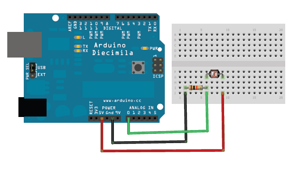

Hi there! Today I will be talking about using a photocell with programming, But first we have to Bread board all the components into the right places. do so like the photo below, or buy the Photocell kit from Aarons Robotics and read the manual in the package.

Step 1: Programing
We can now start taking about how we program this unique tool to sense light! Be sure you have the Arduino software downloaded on your computer! This can be found at : http://arduino.cc/en/Main/Software
Next Upload this code given below

Step 2: Hacking!
Test it out! The Reading will show up under the serial monitor under “Tools” at the took on the arduino editor screen . You can Hack this code a Little and have it buzz with a piezo speaker! (you can put this up also at Radio Shack!)
Plug the piezo into pin 4 with the black wire or change the pin it at int piezoPin = 4;
Plug in the Photocell Circuit in at Pin 0 or change it at int photosensorPin = 0;
