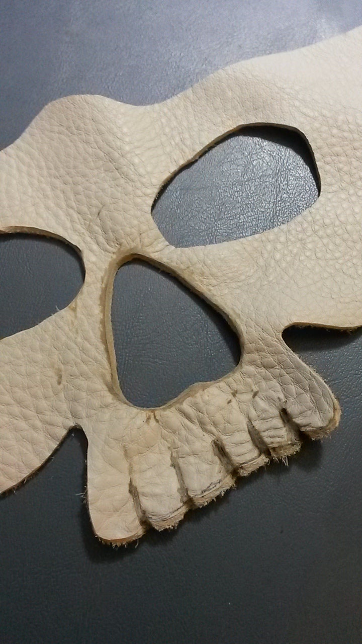

Draw your skull design on the back of your leather. If you're worried about symmetry, draw one side first on paper then cut it out and trace it onto your leather one side at a time.
I love to burn leather. The way it curls and scorches is always interesting, so I decided to use a soldering iron/wood burner to draw in the teeth. This is optional and could just as easily be done with paint later in the process.

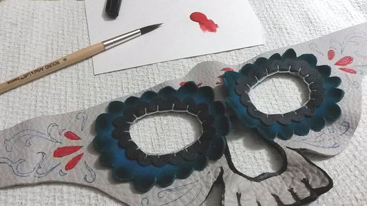

Use a blanket stitch and waxed thread to sew the two eye pieces to the skull base.

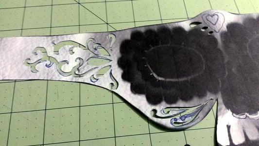

Step 5: Paint Details

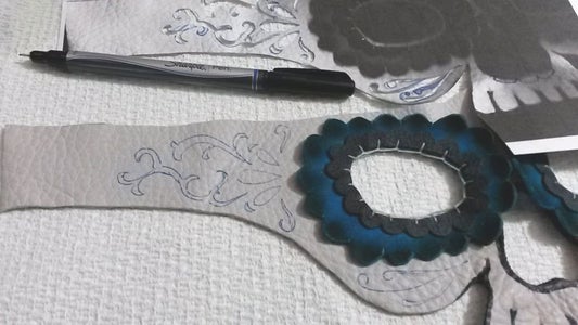

To draw out your design for the details, I recommend copying the mask on a printer and drawing your design on half. If you don't have a printer/scanner, trace the mask base onto a piece of paper before drawing out your design.
Cut out the design with an X-Acto knife and trace the first half of your design onto the leather.
Flip the paper over and trace the other half.

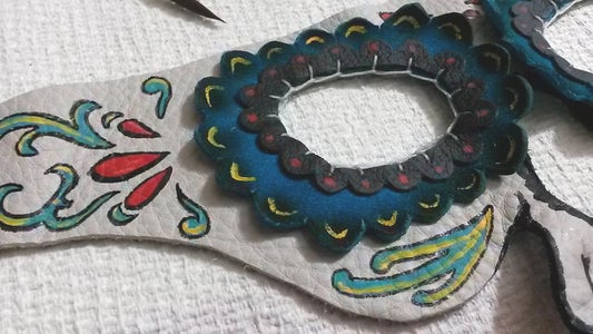

Paint the designs. I used acrylic paint because it's flexible, bright, and it was what I had lying around.
When the paint is dry, trace the designs with a fine tip permanent marker.

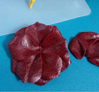

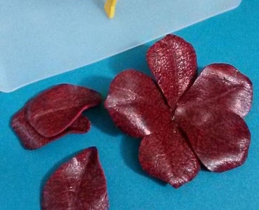

Step 6: Flower Petals
Draw and cut out a pattern for your flower petals. The shape of your petals can vary greatly depending on what type you want to emulate. You need a large and a small petal pattern.
The number of petals you need is really up to you, but I put 5 on each tier with three tiers. I traced the large pattern 10 times and the small pattern 5 times.
Trace your pattern, and cut out your petals.
Again, I love how the leather curls when hit with a lighter. Scorch the ends to make them curl.
Dampen the petals and use a ball pointed modeling tool on a soft surface, like a folded up towel, to create a center "vein" in each petal.
Further shape them as desired and lay out to dry.
Step 7: Flower Construction
You need a base for your petals. I used some metal jewelry hardware I found at my local craft shop, but you could use a piece of leather as well. I wanted the metal to curl up more, so I cut each petal apart to allow me to bend them up.
Use hot glue to stick your first tier of large petals onto the base.
Stagger the next layer of large petals as you glue them.
Stagger the final layer of small petals as you glue.

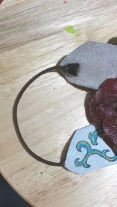

To cover the center, I used another metal piece and a glass bead.

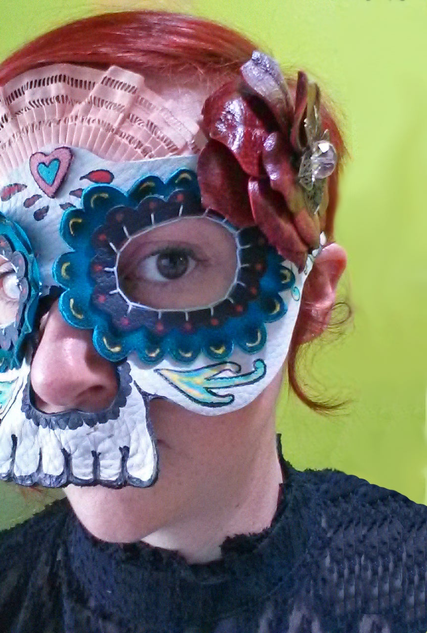

Step 8: Final Details
Hot glue your flowers on the front and cut a small piece of leather to glue on the back. This will help support the flower.
Add a bit of lace to the top.
Hot glue an elastic strap to the back.
