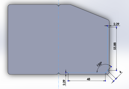

Step 2: Cut Pattern
I created this pattern through trial and error. There's a screenshot of some dimensions I have in my design for a start. I can create drawings if y'all want some!
