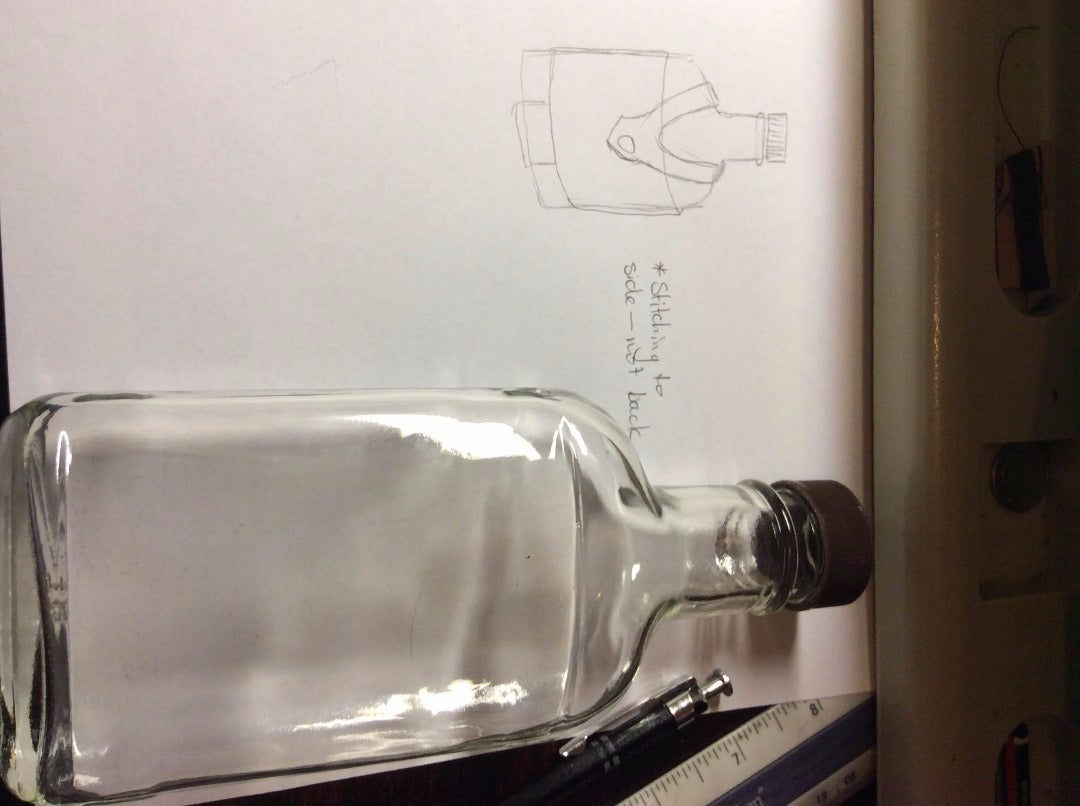

Step 2: Patterns
In microsoft word, or similar program, draw a rectangle and follow the prompts outlined in the images to produce a scaled pattern. Measure the scale bar after printing to double check the scale.

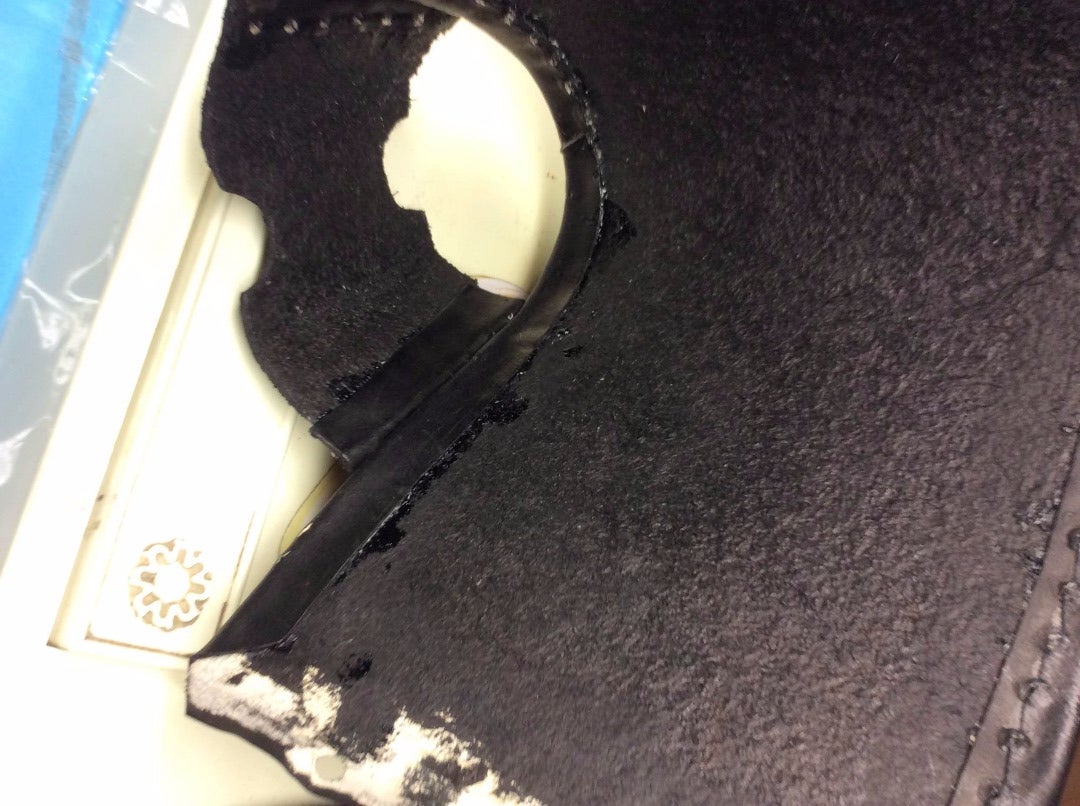

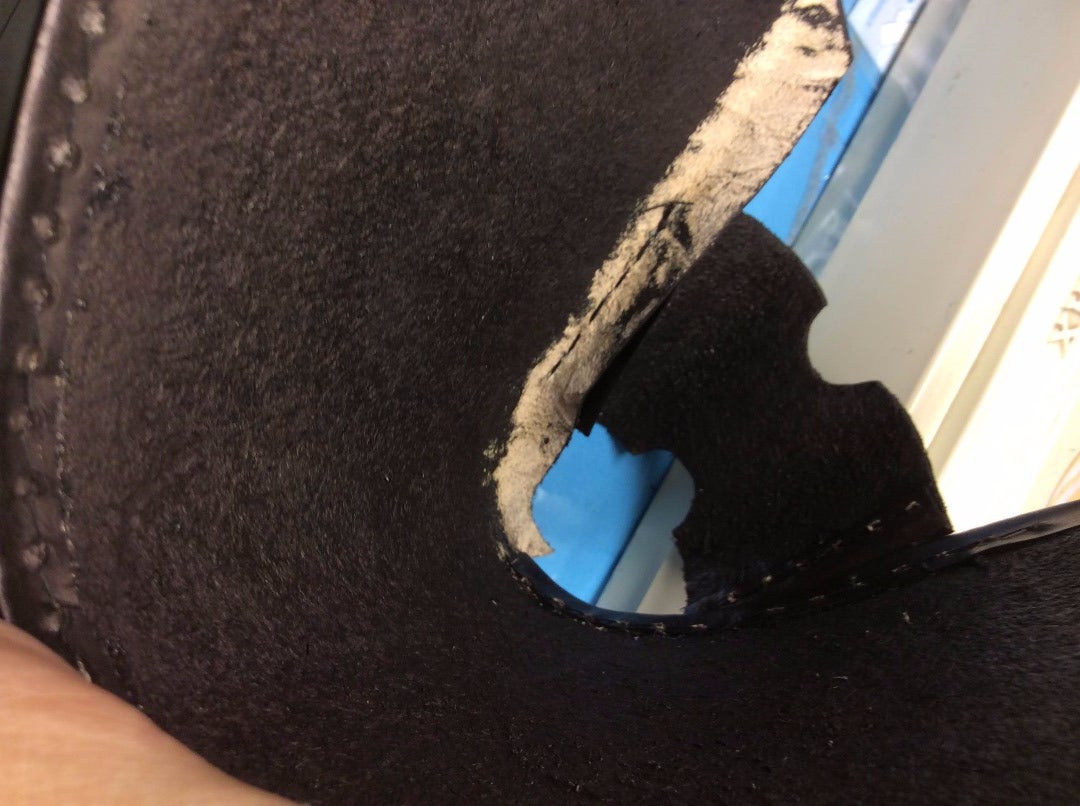

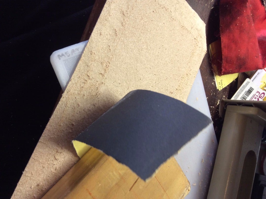

Step 3: Skiving & Bevelling Leather
On the flesh side of the leather thin with a skiver till it is pliable, if the you don't have a skiver or need to thin the leather a little bit more you can finish it with 800p sandpaper.
Leather edges that have been skived do not need to be bevelled. I only bevelled the edge of the strap.

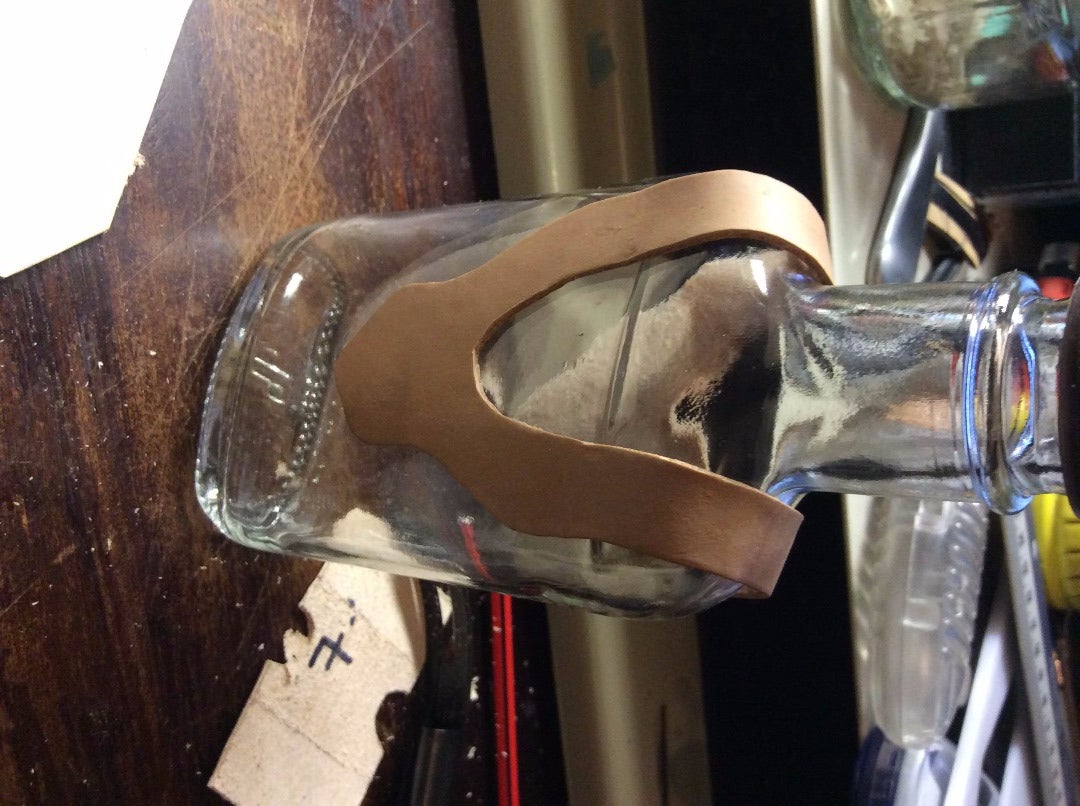

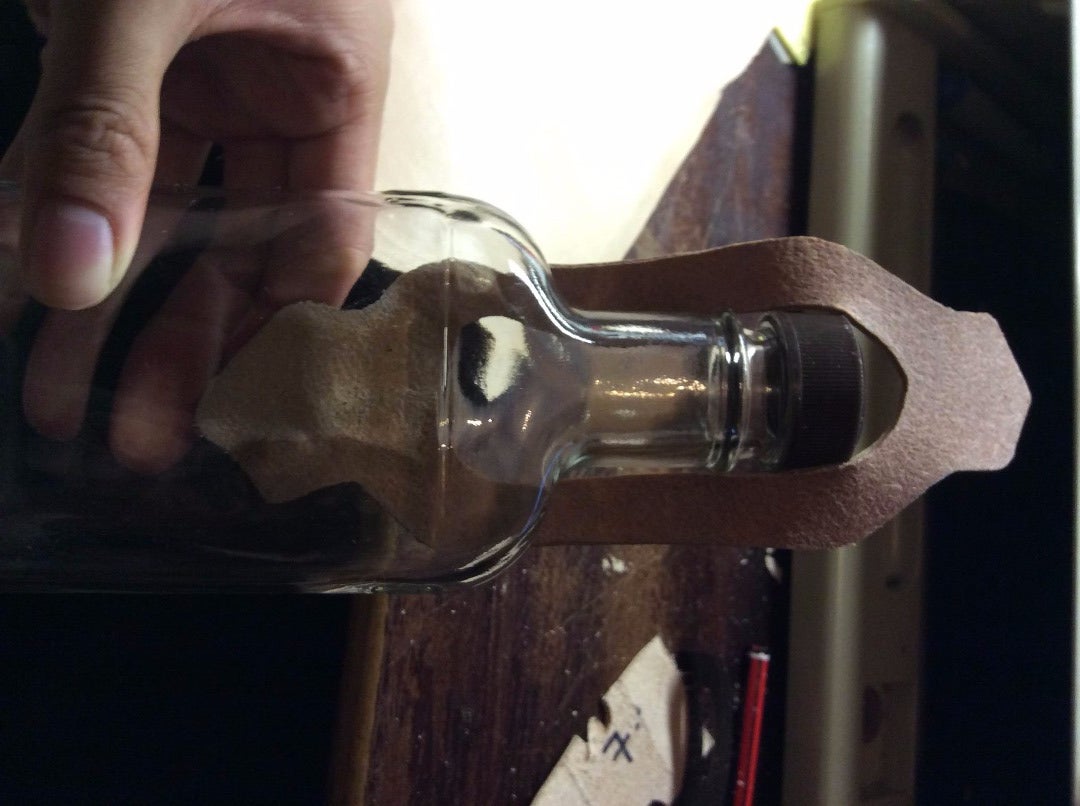

Step 4: Shaping Leather
To shape the strap simply submerge in lukewarm water for 10-15 and drape over the glass flask to dry. At this point you want to check for proper alignment, if it dries crooked simply submerge and dry again. Make sure it can open over the lid.

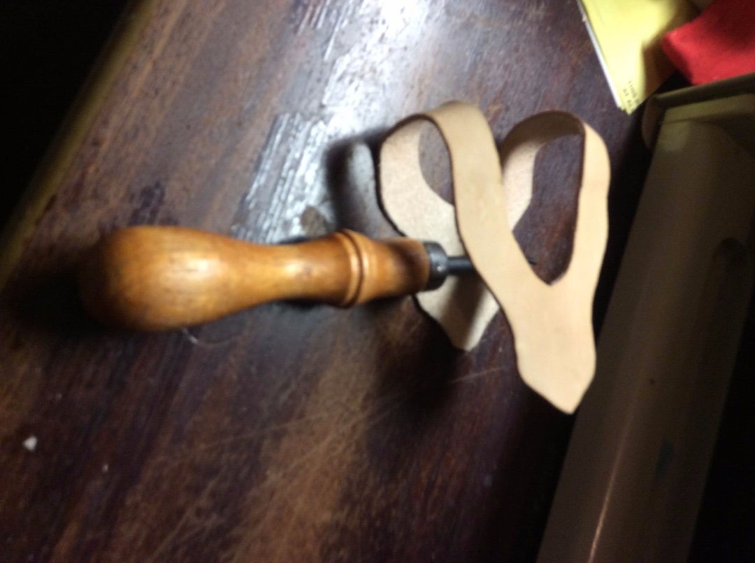

Mark the rivet and press stud holes on the strap and punch the holes, mark on the base where the strap will connect to the base.

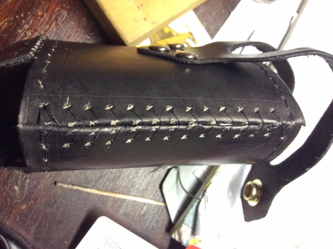

Step 8: Stitching
Before stitching glue down edges with epoxy resin use the diamond pricking fork to punch the desired stitching holes. With this step you'll be juggling stitching and gluing edges. After applying epoxy resin do not immediately press together, allow them to air and get tacky before pressing together to allow for a stronger adhesion.
I followed the tandy stitching method, the video has both single and double needle stitching.

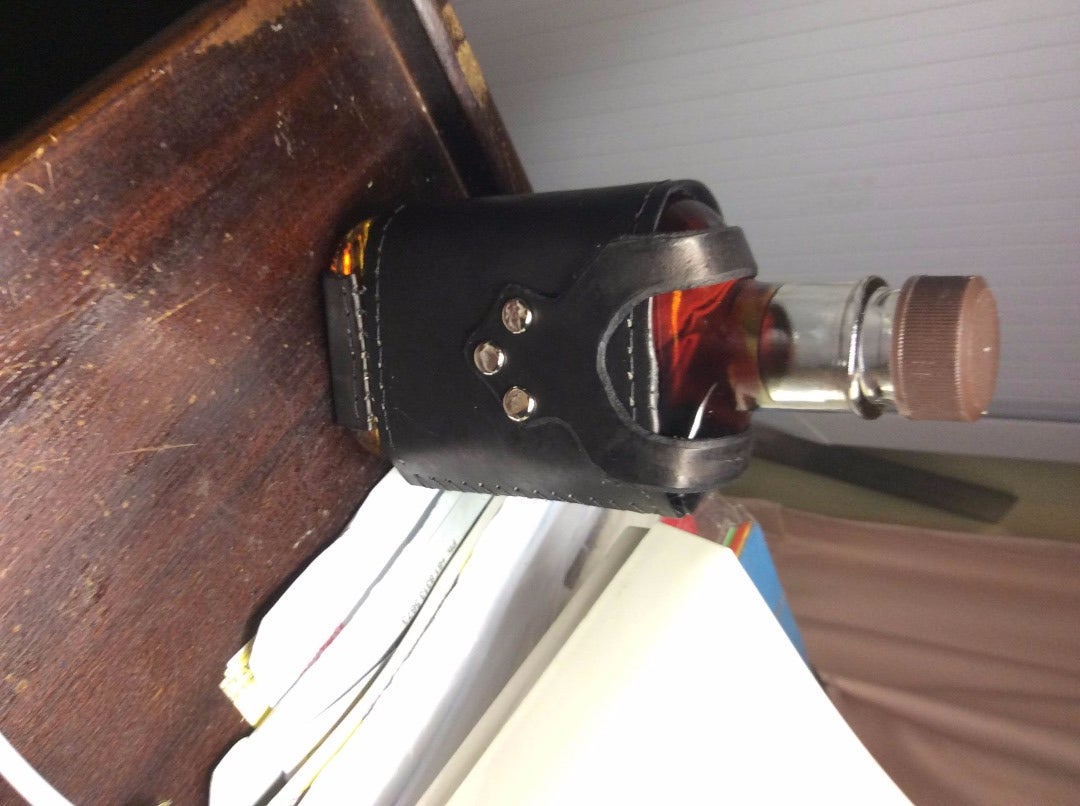

Step 9: Final Mentions
Usually I take the flash out of the cover before filling. You can pretty much put any liquids in the glass, it doesn't have to be alcohol.
