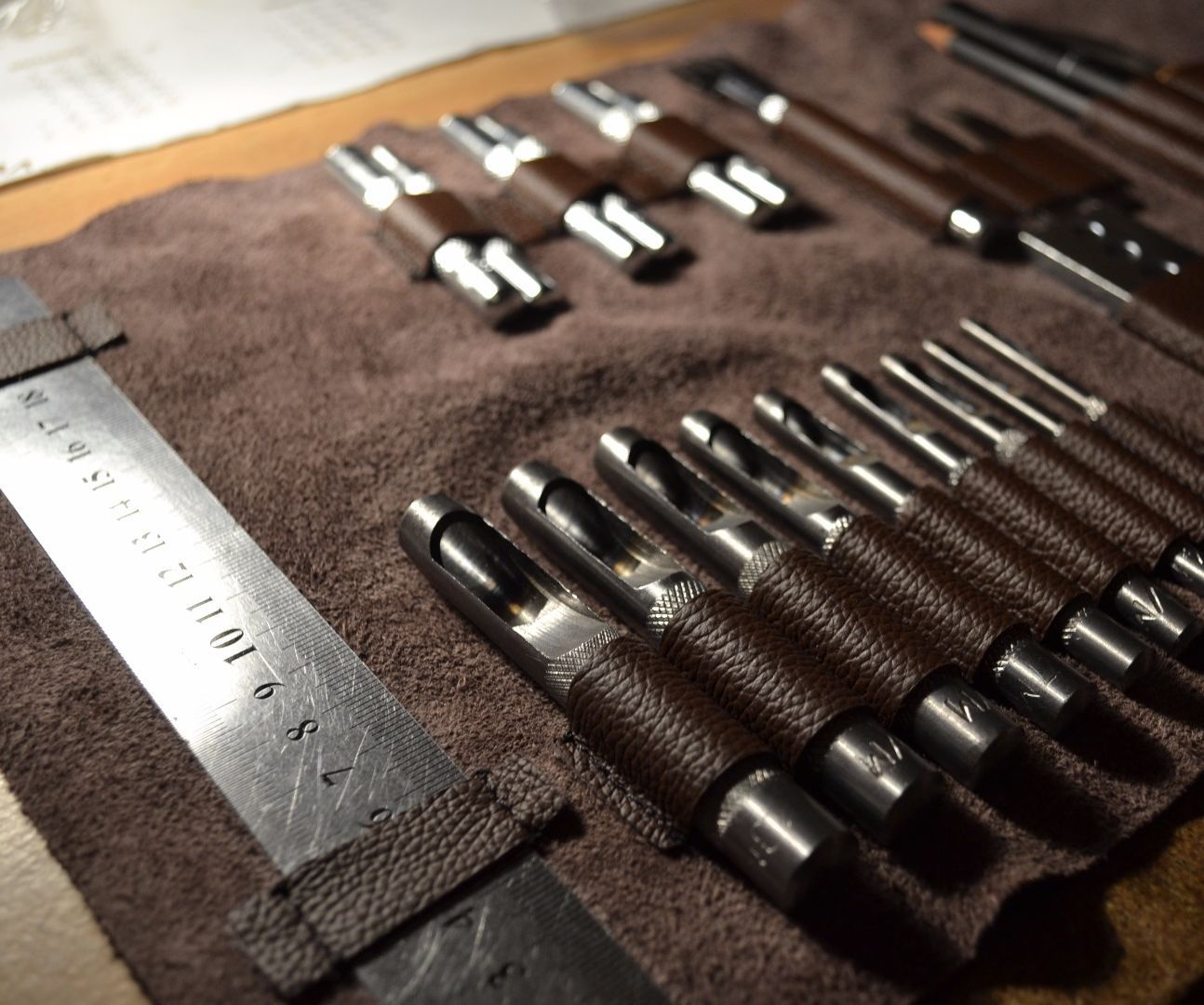

- Hole puncher,
- Hammer,
- Scissors,
- Paper knife,
