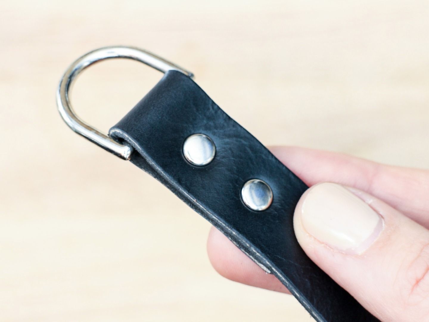

D Rings
D rings are shaped like a D with one flat side and one curved side. They are usually attached by looping a strap around the straight side and riveting or sewing it to itself. Then another strap or piece of hardware such as a clip, can be attached to the curved side. D Rings provide less movement because whatever is attached to the flat side can't swivel as freely around the whole ring.

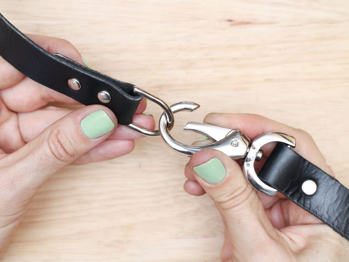

Gate Rings
Gate rings are round rings that have a swinging latch built in much like a carabiner (but not nearly as strong, so don't take one rock climbing :). Gate rings can serve as both a clip and a ring that lets you attach a strap in a very modular way. They can be very easy to lose however because there is nothing to hold them in place when they're open.

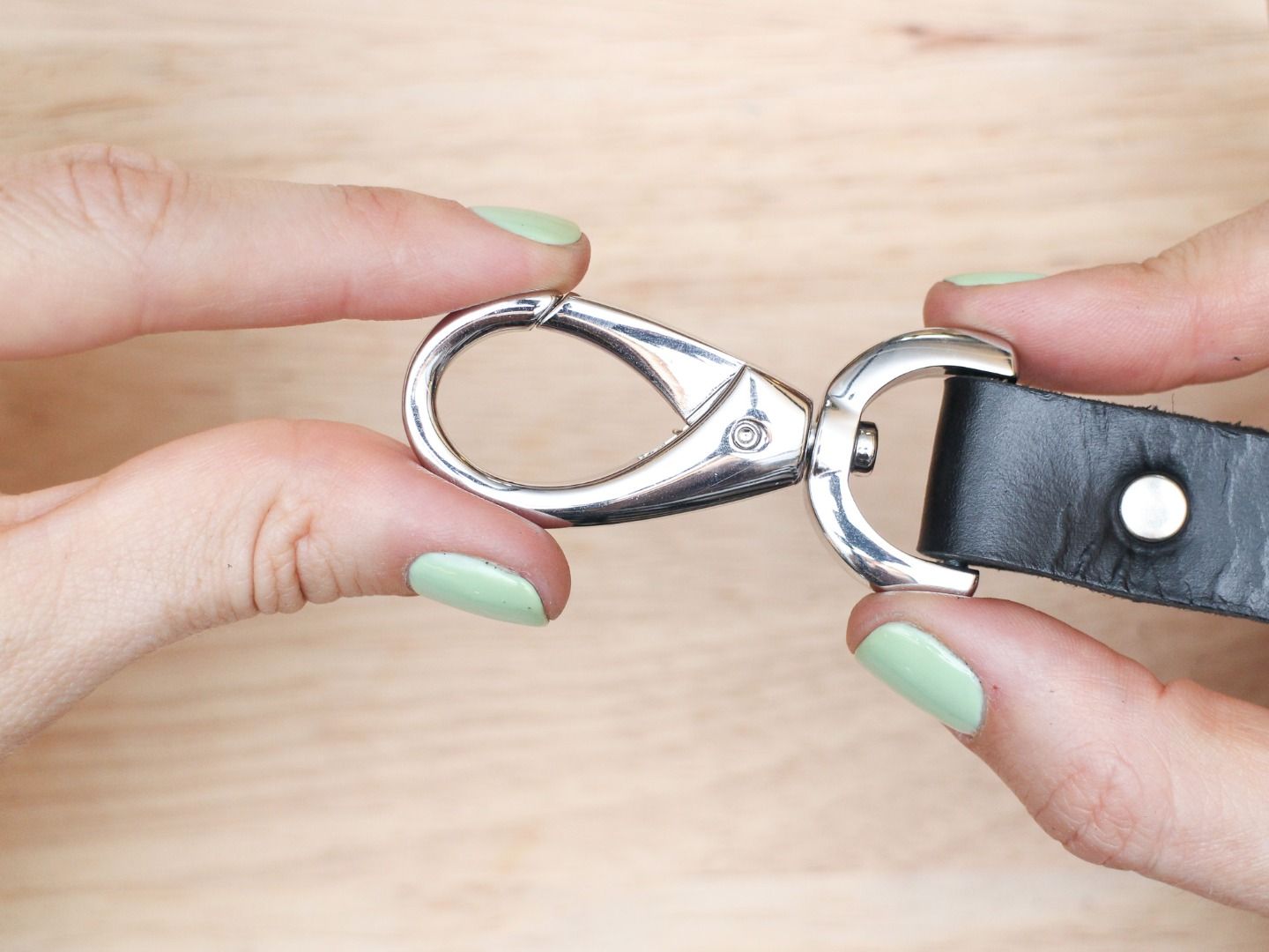

Swivel Snaps
Swivel snaps have a spring latching mechanism that swivels in relation to point of attachment for a strap. Unlike a gate ring, a swivel snap won't get lost when it's open because it will always remain attached to the strap on one side. Swivel snaps are often used in conjunction with O or D rings to attach straps.

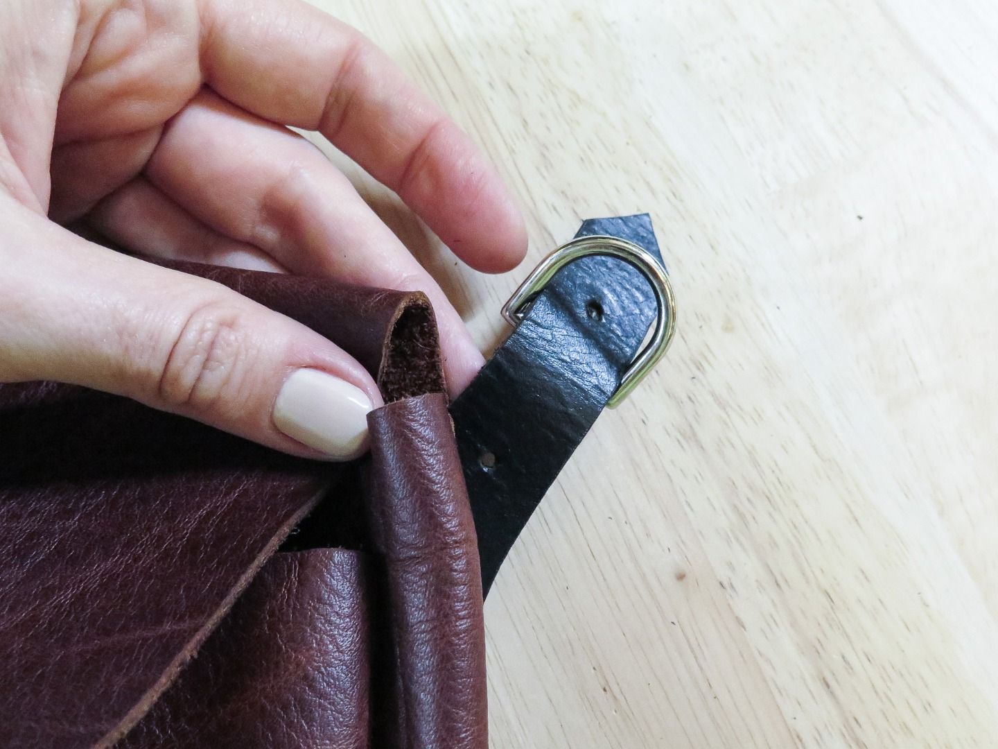

Step 5: Add D Rings to the Small Bag
Now to let's add the D rings you've chosen for your bag. You could also use O rings or swivel snaps here, but I think D rings look nicer.
To do this on the small bag, just take your two D rings and attach them to the strap loops at the top of the bag. Slip the D rings onto the straps and then rivet the straps onto themselves with quick set rivets, a rivet setter and mallet.

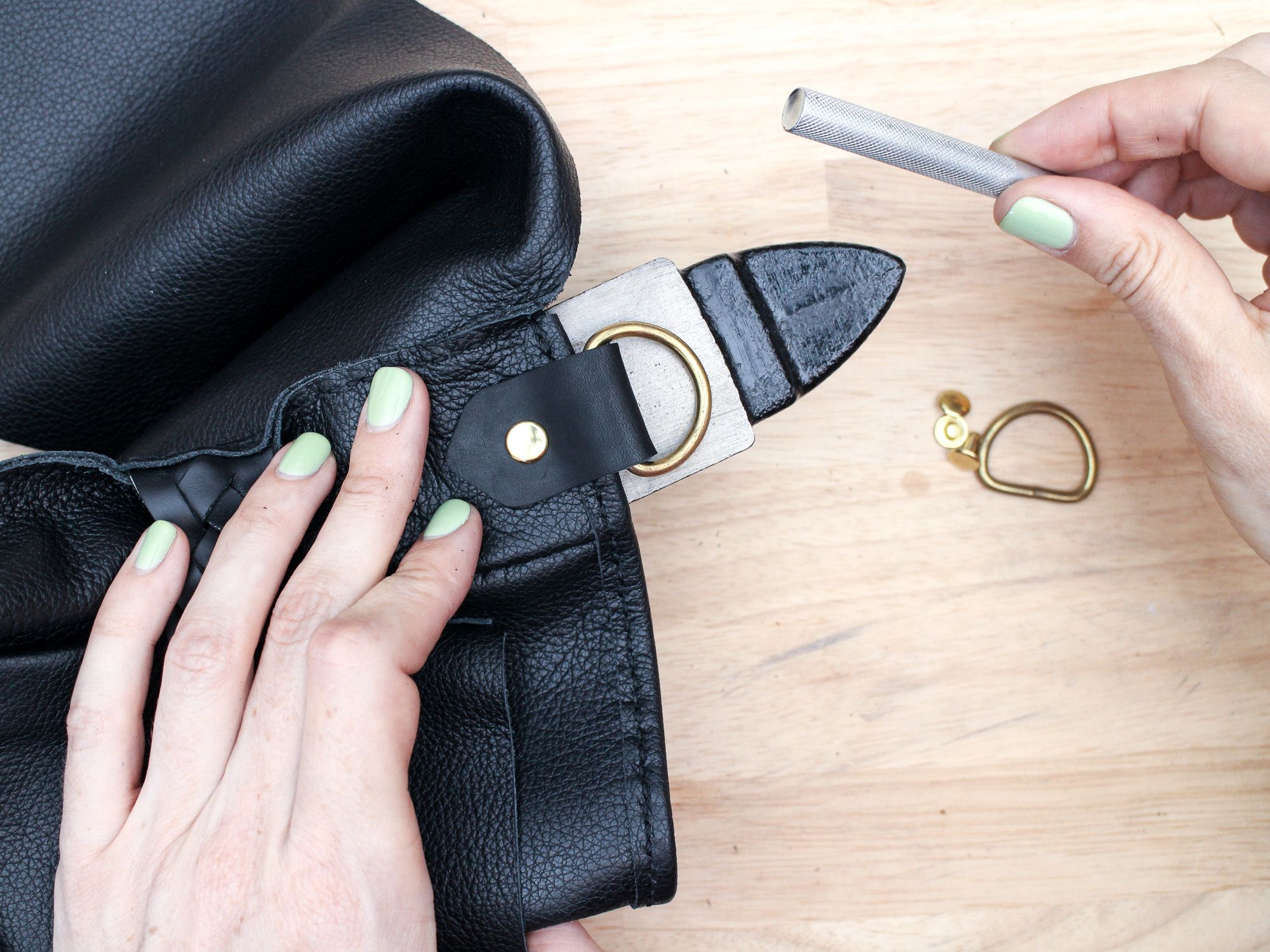

Step 6: Add D Rings to the Large Bag
I added D rings to my large bag in a slightly different way. On a bag like this that is going to hang from a shoulder strap as a purse, it's better to have the strap attachment on the sides so the weight of the bag is balanced and hangs straight down. Therefore, in this case, I attached the D rings by riveting leather loops onto the gusset of the bag rather than sewing these loops into the back seam as I did with the small bag.

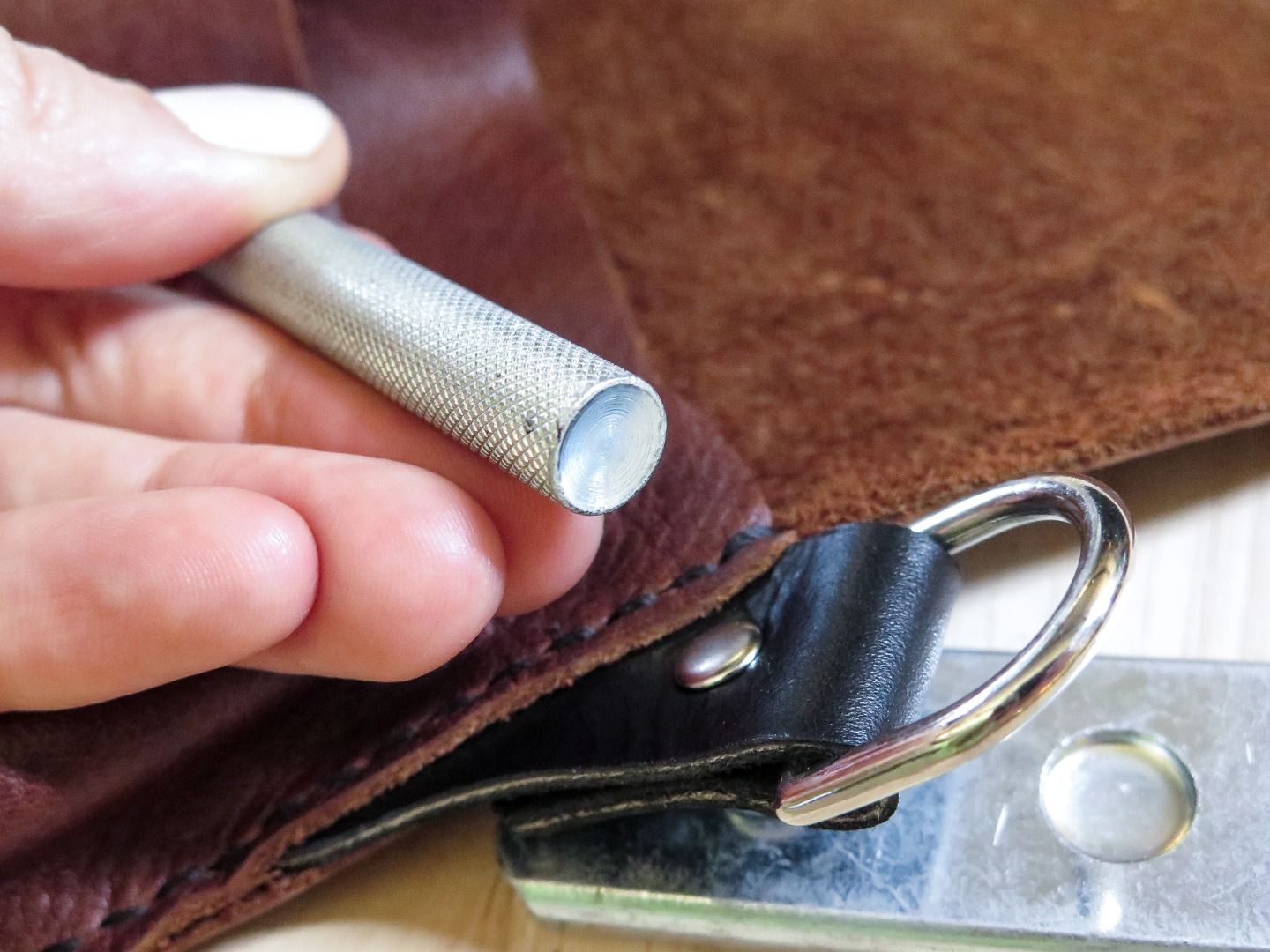

I punched a hole just below the edge binding on the sides of the purse, and two corresponding holes in the leather strip that will form the loop.
I situated each leather loop with one end on the inside of the bag and one end on the outside, and then slipped the D rings onto the leather loops. I inserted a medium rivet through all three layers, and then riveted the loops to the edges of the bag with my setting tool and mini anvil.

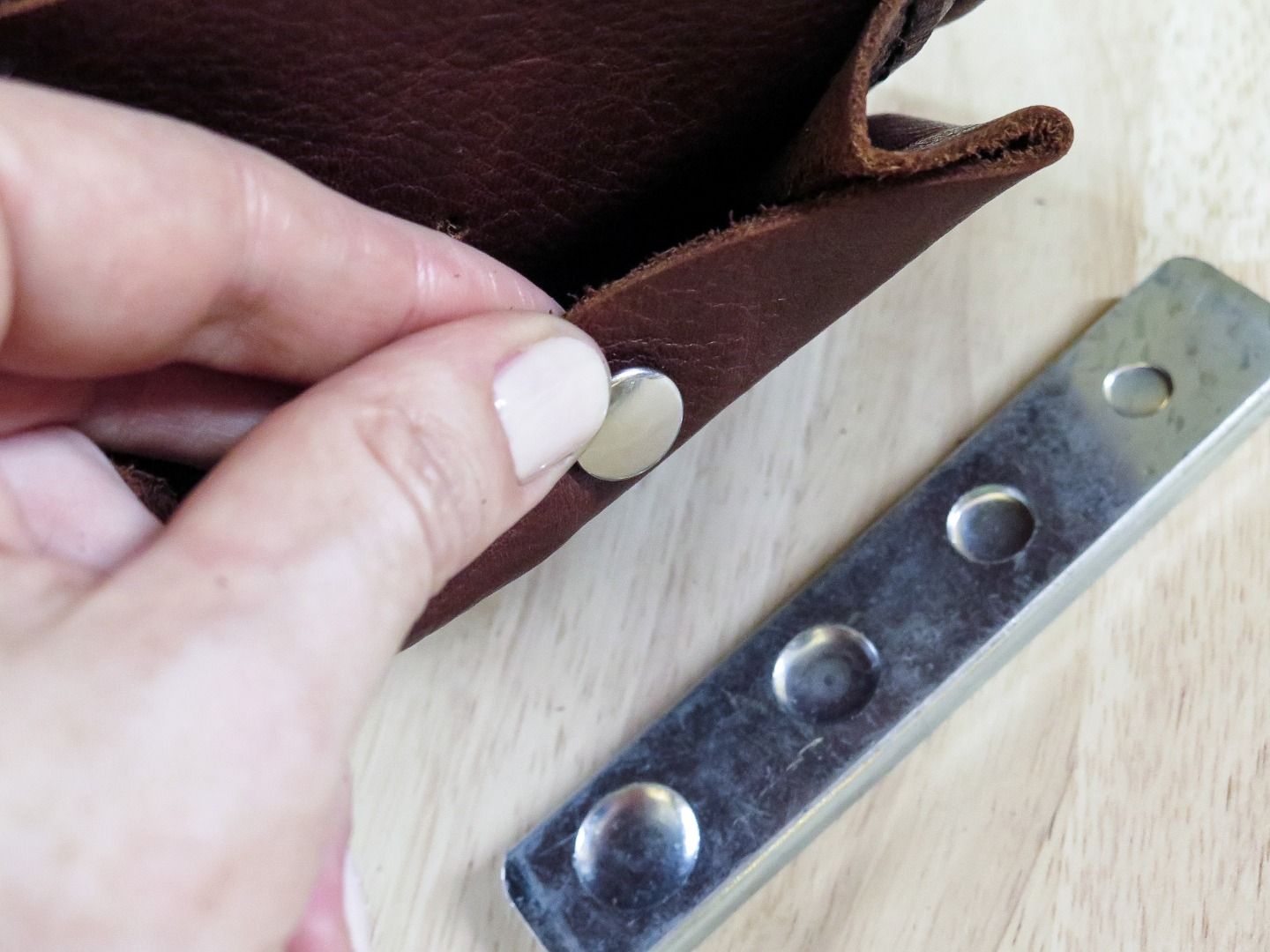

On the small bag I used line 20 snaps and their corresponding snap setter and attached them through the holes I had already punched in the leather.
Sometimes when you are working with relatively thin leather, the posts of your snaps will be a bit too long and they won't attach right when you try to set them. A good trick here is to make a leather "washer" by cutting a small circle of leather and punching a hole it it. You can slip this over the post of the snap before you set it, and it will make your leather the right thickness for the snap!
When you set the back section of this snap, you are going to have to put the metal rivet setting base inside the bag to create a base to punch on. This is something you have to do relatively often when you are adding hardware to an already assembled piece, and the rivet setting base and mini anvil can come in very handy at times like these.
