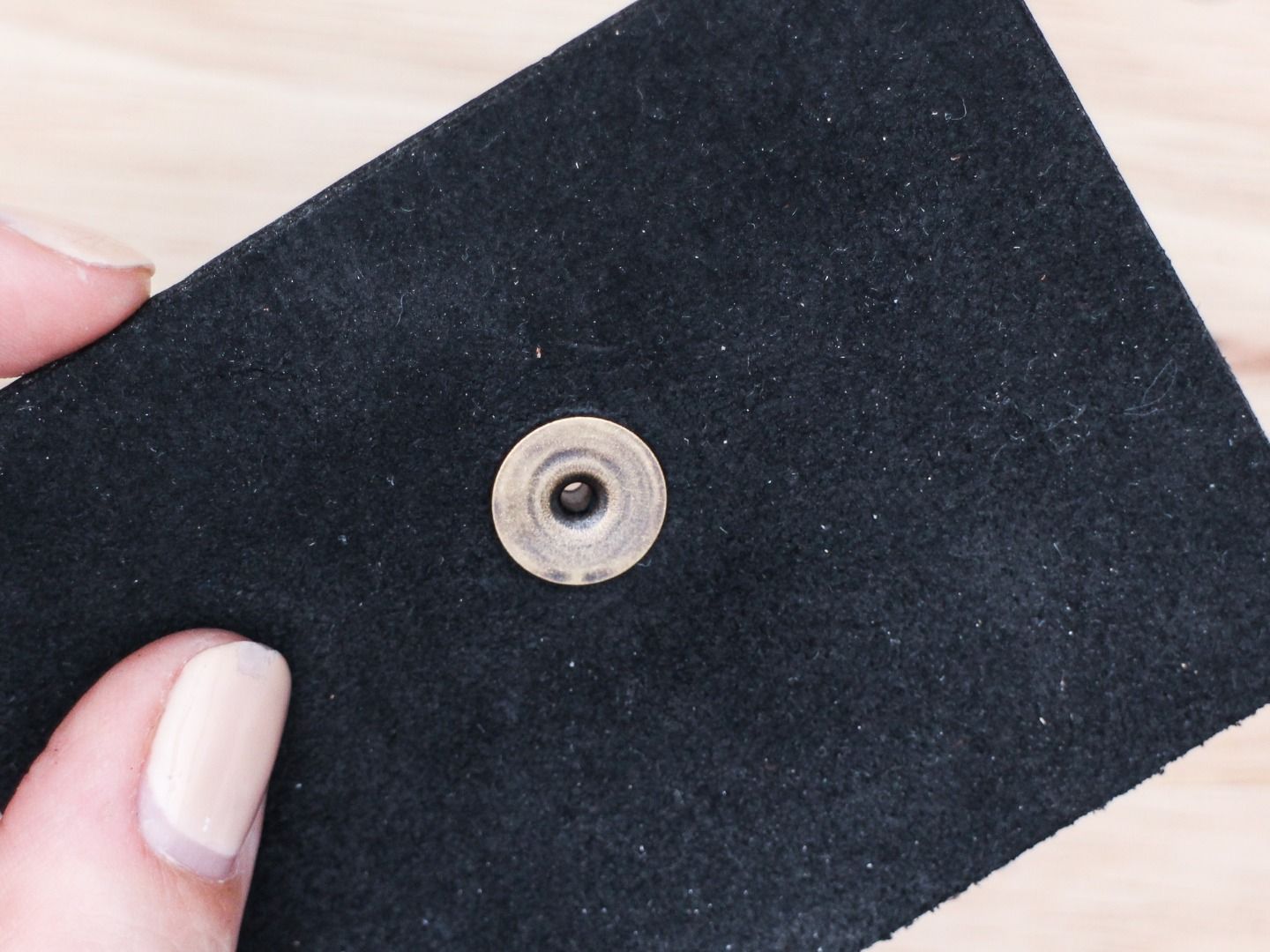

Line 20 and 24 snaps have 4 parts: The cap and the socket, and the post and the stud. You set the cap and the socket together on one piece of leather and the post and the stud together on another, and then the socket and the stud snap and unsnap to each other create the closure.
To set line 20 or 24 snaps, first punch two corresponding holes in your top and bottom leather pieces. The holes should be the size of the snap post. Sometimes, to be sure I get the snaps aligned correctly, I will set one side and then use it to get the exact placement for the other side before I punch a second hole (you'll see what I mean when we assemble the wallet).

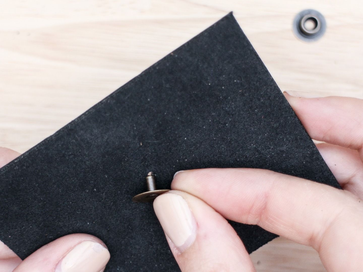

To set the cap side in your top leather piece, slip the cap into the hole from the grain side. Then slip the socket down over the stem of the cap from the flesh side.
Take your setting base and place it under your leather so the cap sits in the appropriately sized divot. Use your line 20 snap setting tool to set the snap by hammering it together with a mallet. Tap lightly with the mallet at first so the snap aligns properly, then pound harder to secure it. When your snap is set right it shouldn't spin around in its hole.
To set the post side, stick the post through your bottom piece of leather from the flesh side, and slip the stud down over the post from the grain side.
You don't need to use the divots on the snap setting base here because the post is flat on the back. Just place your leather over any very hard flat surface. The other side of the snap setting base works well. Again, use the snap setting tool and mallet to set the stud onto the post. Now you have a complete snap pair.
Snap the two sides of your snap together to test if they connect and hold well.

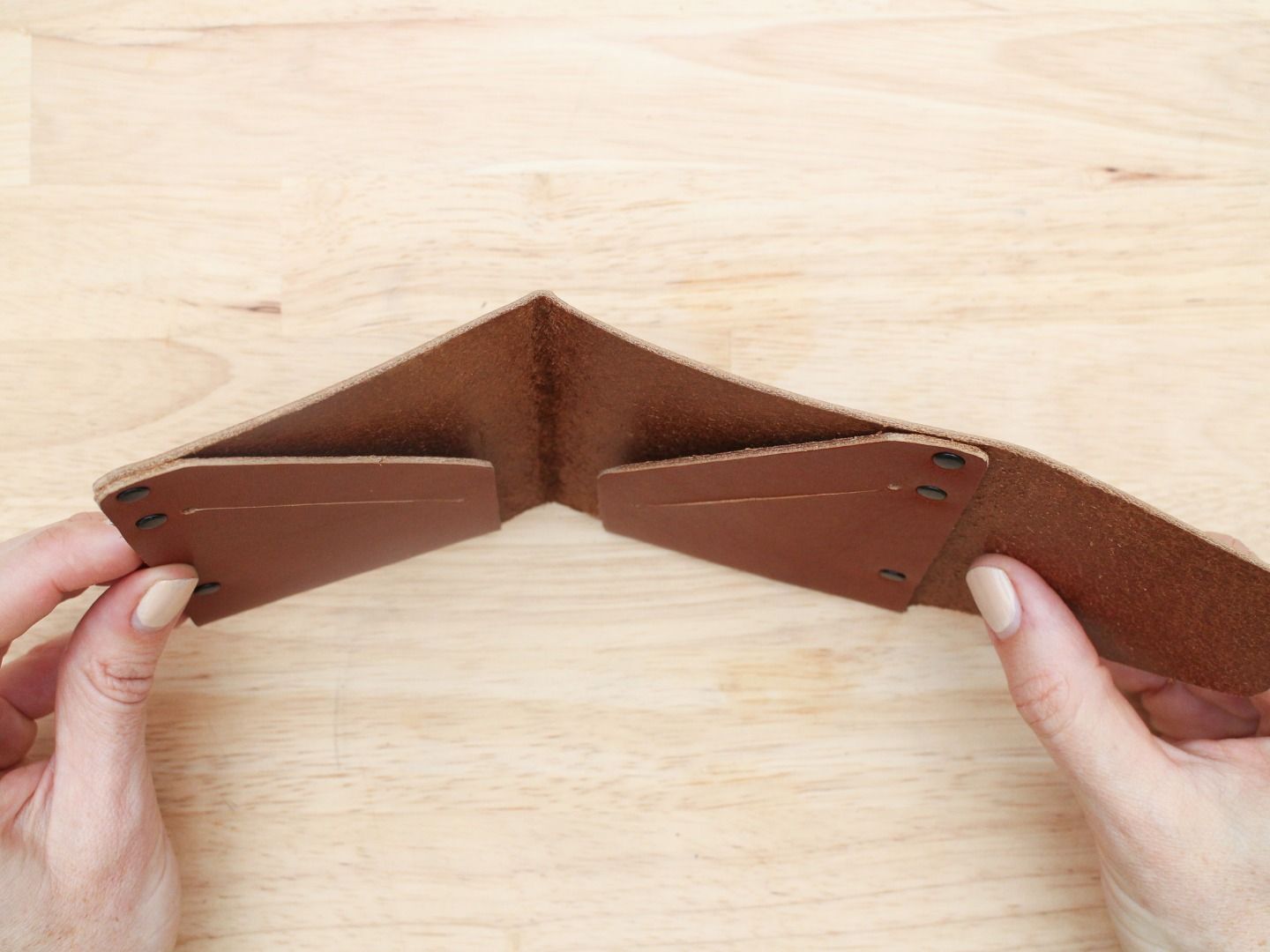

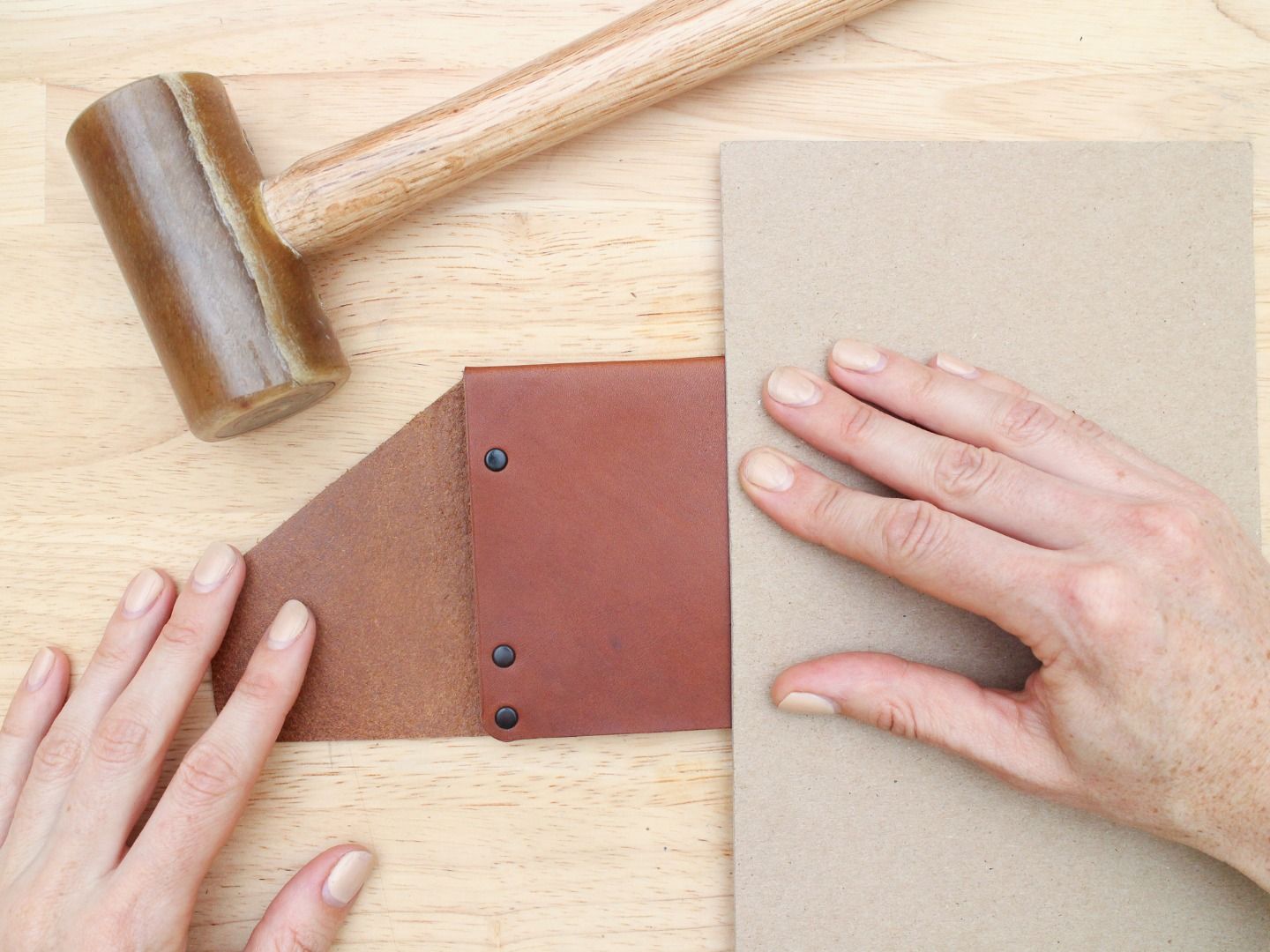

Before we put a snap on the wallet, we need to define a center crease where the whole thing folds over on itself. This crease will develop naturally over time from the pressure of the wallet being folded and used, but we want to establish it in the right place so we know exactly where to put the snap.
For this fold, we aren't going to use the V gouge because we don't want to weaken the leather at this point of repeated motion, or make an unsightly mark. Instead, fold the wallet closed so it's lined up just right. Press down on the center fold with your fingers to define where the crease goes.
Now take your sponge and dampen the leather along this line, inside and out. Fold the wallet again, cover the fold with cardboard, and pound to create a crease with your mallet.

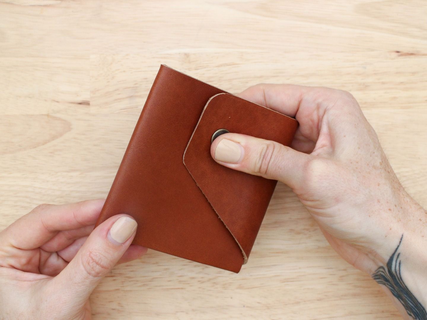

Finally, to finish our wallet we are going to add a snap closure on the front flap.
Punch a hole near the end of the flap, 5/8" in from the edge, and 1" down from the top.
Stick a snap cap in from the outside, then nest it in a divot on the snap setting base, add the snap socket, and set the snap with your setting tool and mallet.

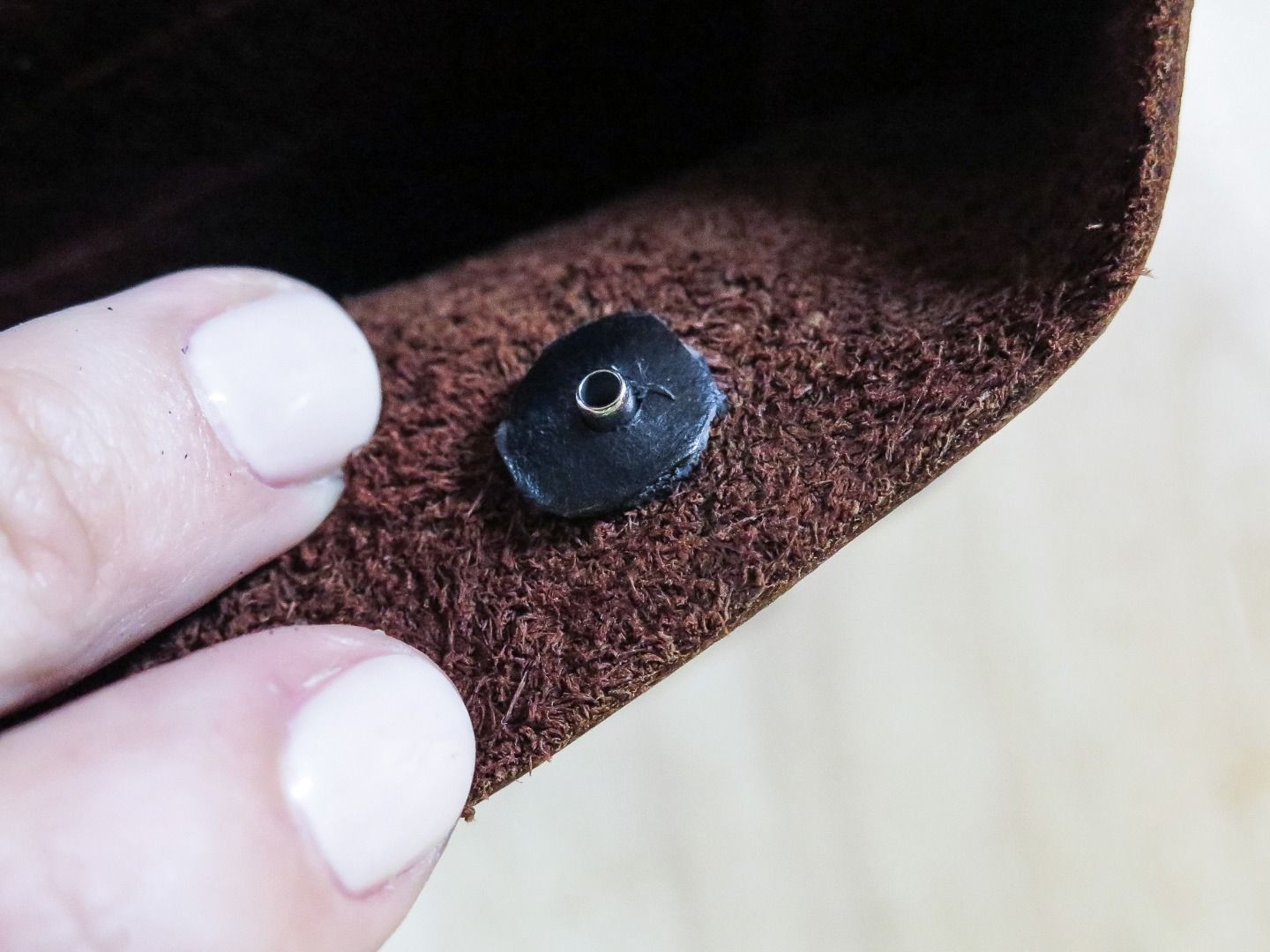

Fold the flap over onto the wallet, lining it up exactly where it should sit and press down hard on the snap with your fingers. When you open the flap, you should be able to see the faint impression of a circle on the leather beneath, this is where the bottom half of your snap should go.
Now punch a hole in the center of that circle, and set the post and stud half of the snap in this hole, using the flat side of your snap setting base. You will need to slip the base inside the flap of the wallet so you are pounding directly on the metal of the base not the leather of the flap. Otherwise you would damage the leather.
