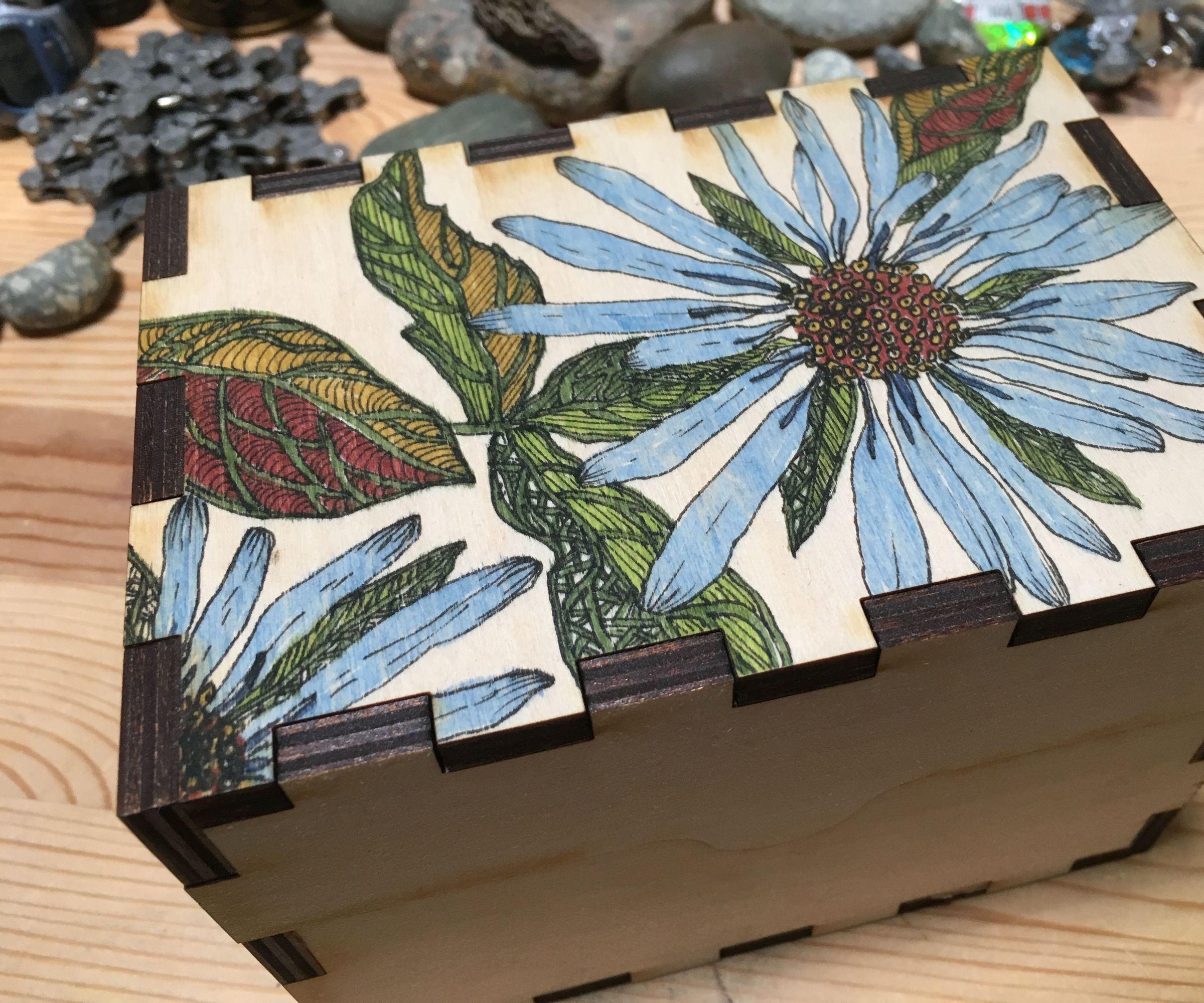

Step 5: Glue the Box Together
Start by dry fitting your pieces together - this is always a good thing to do before glueing, to be sure everything fits, you have all the pieces, and you know where they need to go.
Lay out the pieces in two groups, with the top and the bottom pieces together (photo 1).
Use a small paint brush to apply a bit of glue to the top surface of each of the finger joint tabs on the sides of the pieces you are joining. Work your way around one group at a time, applying glue and adding one piece at a time.
Once all sides of the top and bottom are glued, use clamps or thick elastics in both directions, to apply pressure and keep the joints in place (photos 2-6).
Let the glue dry.
Once glue is completely dry, remove elastics and/or clamps, and lightly sand the edges of your box.
