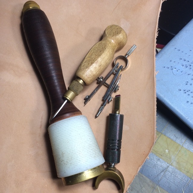

Step 1: Tools and Supplies Needed
my tool list is but not limited to
razor knife
awl
ginsu scissors
stylus
sandpaper
various bevelers and leather stamps
sheeps wool
harness needles (blunt ended)
tiger thread
swivel knife
maul / mallet
diamond chisels
French edge skiver/beveler
adjustable 'V' gouge
stitching groover
contact cement
4-5 ounce veg tanned leather
gel antique stain (tan)
satin shene acrylic sealer
carnauba crème wax
beeswax

There are a ton of gizmos and gadgets to make things easier, you just gotta know when to say ..OK I have enough
Punches are one, I don't do a lot of lacing but my I have a small set of chisels for that just in case
I did learn early that a good set of diamond chisels are essential if you want your stuff to look great not just ok, instead of having a $500 box of them I opted for a set with interchangeable heads and I never looked back, just remember a new cutting board is waaay cheaper than a new chisel so always punch on a board to save those fine tips,
Needles, there are also a slew of needles for every job, I use mainly harness needles, the eyes are smaller and there is less bulk to pull through the holes, harness needles are blunt ended so you wont catch the inside of your hole and make a mess in there
Threads, I have used everything to sew with in the past, waxed linen to real sinew to artificial sinew and even dental floss, I needed white and it worked pretty good, I learned of a product called tiger thread or ritza, this stuff is braided and strong as braided fishing line, I don't think I can break it and I know I can cut the leather with it if I pull too hard, its expensive but well worth the price,
The Awl, my most important gadget is my awl, I have it in my hand when sewing most of the time to open holes, beware. it will go clean through your finger without slowing down and the resulting blood will permanently stain your project

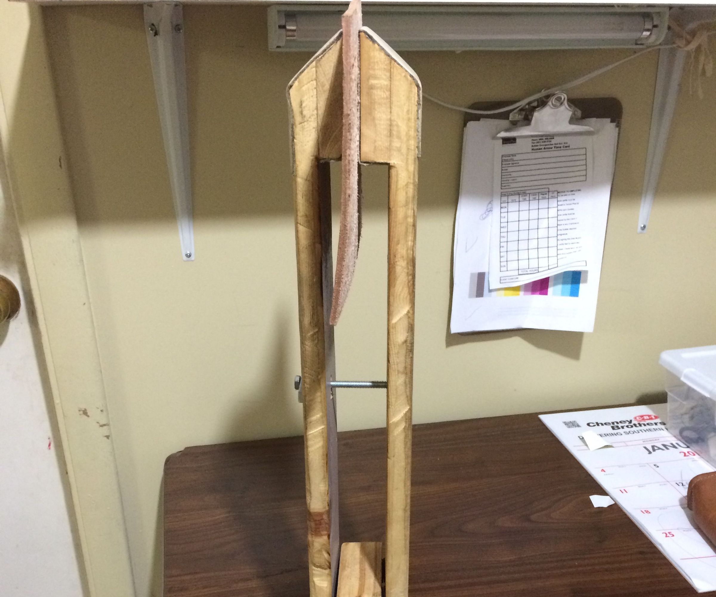

Saddle stitch or the 2 needle method, there are excellent saddle stitching videos on the web, watch a bunch of them, punch hundreds of holes in your scrap leather and practice until you get used to the needle and awl work the rewards are gratifying, believe me. Basically its threading 2 needles with 1 thread, 1 needle on each end, then going through every hole 2 times, once in each direction, this is the strongest method of sewing because if one thread fails you always have the one going in the other direction left to hold the bond together. there are several precautions to take while doing it so do watch a video.
The stitching pony, an extra set of hands, I made an instructable on the one I built a while back, I use it everywhere and with almost every project, its not necessary but it sure comes in handy, I can put it away and leave my project in it while at work and the grands cant get to it and turn my 30 hours of work into a sand box shovel, again. (gotta love em though)
