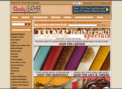

The most daunting part of leather working is where to even start looking for materials and tools. Thankfully there are a number of great websites where you can find what you need at an affordable price.
The site TandyLeather offers everything listed previously on the intro step all at a decent price. This is where I buy all my leather as i cant seem to beat the prices. They also have several outlets around the U.S where you can find nearly there entire inventory. However they're tool prices can be a bit high if your on a budget. When buying leathers keep in mind what your looking to make with it. Pouches are made best with 4-5 oz shoulders while armors are made best with 6-7 oz or higher.
Tandy Leather is where i buy all my dyes, conditioners and cements. When purchasing dyes the best and most user friendly are the waterstain dyes and conditioners. They are easily applied with high density sponges. If you want the highest strength bond when gluing your best bet is Leather Contact Cement, don't confuse it with rubber cement. Barge cement is also a popular choice but I find it harder to work with since it doesn't come with a brush.
