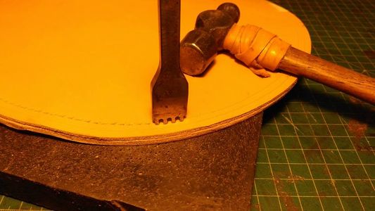

Use a dividers to draw 2 sewing lines.
Use punch to make holes (this punch can be found on ebay, a cheap one from China).
Wax the threads with a piece of candle or bee wax.
Hand stitch all around the edge (it took me 1 hour to complete this process)
Stop the stitch at the masking tap, save threads for later process.
