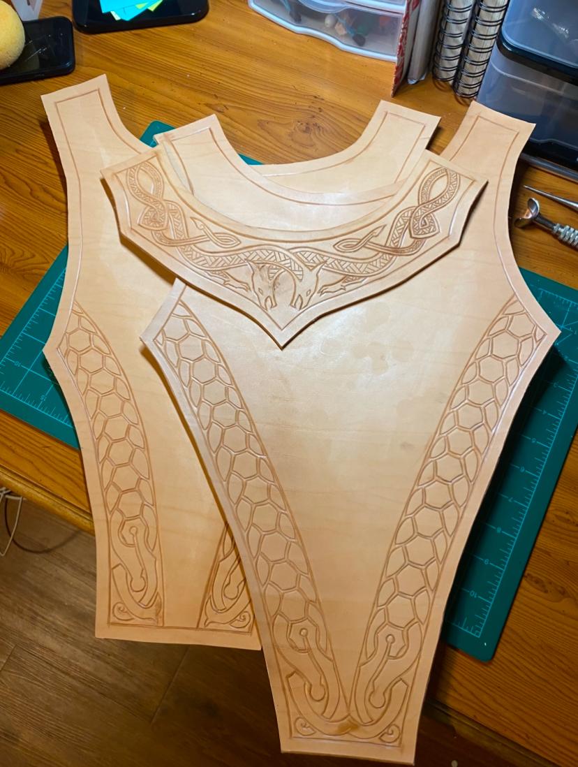

Step 2: Cutting & Carving

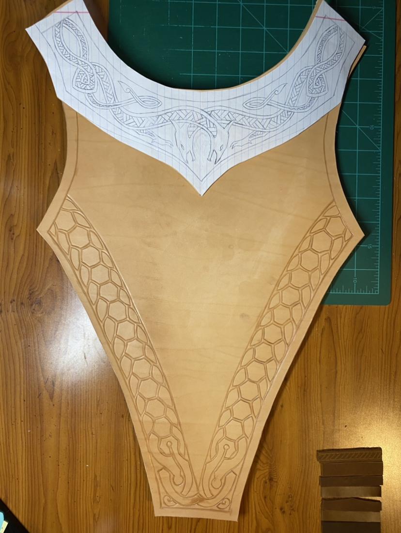

Using the duck tape patterns, I traced out the front and back panels onto the veg tan leather, tracing one half and then flipping it over to get the exact mirror image for the other side. I traced the front, back and collar piece, then cut out all the shapes with a fresh blade on my xacto knife. It usually takes several passes to cut through the leather, so don't rush and make sure your blade is sharp.

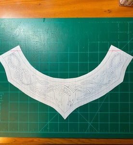

With all my shapes cut, I applied water to the entire front panel until it was mostly saturated, then put my paper carving pattern on top of it and lightly traced on the design with my stylus. I did this on both edges of the front and back panels, then did the same for the collar piece. If it becomes hard for you to press down on the leather, you probably need to add more water and wait a moment for it to sink in. I like to apply water to the entire piece I will be adding carving to, just so I don't risk discoloring it by only putting water on the area to be carved.
Finally, it was time for carving. With the patterns traced onto the leather, I reapplied water to the surface, then carefully followed the tracing with my swivel knife to cut in the pattern. Once I had all the lines cut, I added more water as needed and deepened and beveled them with my tooling spoon. I like to add the bevel to the outermost lines of the design, to make it pop a bit more. This step can be difficult, so I recommend practicing on a test piece before doing the real thing, because there's no way to erase here.

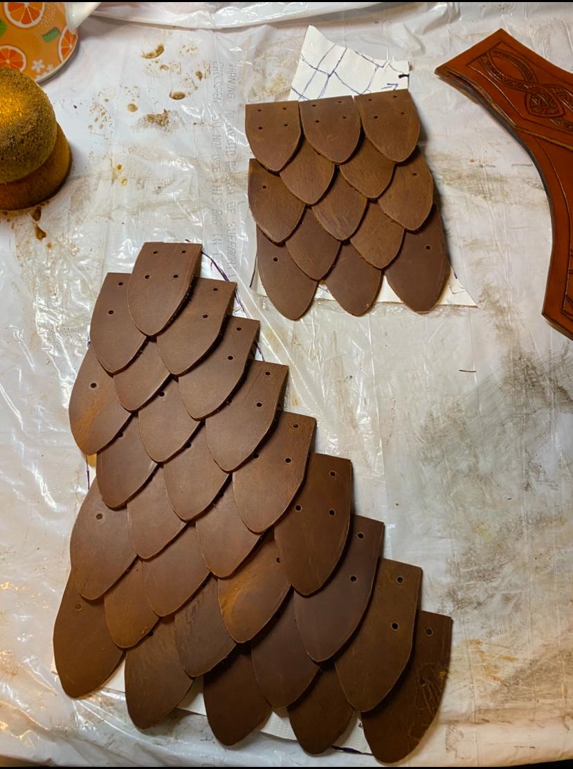

Step 4: Scales

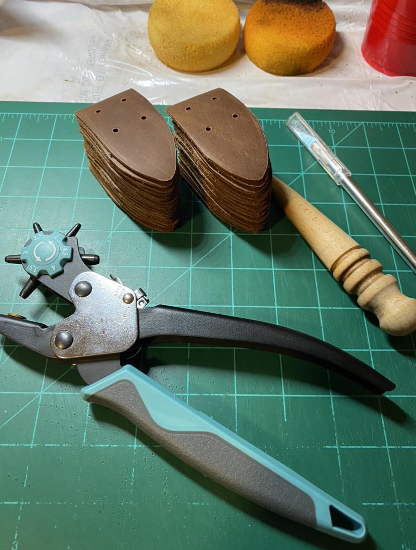

At this point nearly all the Veg tan leather was complete, and the next step was to trace and cut out all the scales for the sides. I chose this construction, because it made the sides very flexible and I have surprisingly good range of motion with the cuirass on. I grabbed my scale template from my pauldron project, and drew out 120 of them on the oil tanned leather. The number here will depend on your duck tape pattern and your design, but this was how many it took to fill those side spaces front and back for me. I cut out all the scales, and slicked the edges with a burnisher.
The 2nd image is a diagram of how to punch holes for this style of scale armor, scales in the middle will have all four holes and ones at the sides and bottom will only have two or three. Don't punch holes until you've decided where each scale goes. I did this by arranging them on top of my duck tape pattern pieces, then used the scale template to get the hole placement correct. I started assembling the scales with the bottom row, using brass rivets and a setter to get them secure. Sometimes the setter will push them sideways which is frustrating, so you can also use pliers. Think about where you will likely add the straps, and don't rivet through those holes or you'll have to pick them out later.
When I had each scale panel assembled, I set them out on a flat surface with the middle panel to determine placement. I attached the front with 4 evenly spaced rivets along each edge, and back back with 3 along the edge. Some of the holes I punched in the middle panels lined up with ones in the scales, but where they didn't I just punched new ones in the scales. This is also where I attached the collar to the front panel, but I'd wait on that step until later if I did it again.
As a final measure, I took and awl, needle and waxed thread and sewed down the topmost scales on each side, because they were sticking out and looking funny. This is optional and purely aesthetic.

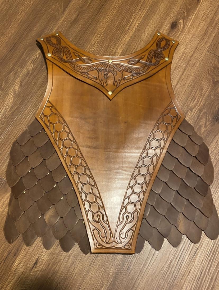

Step 6: Finished Armor
The first time I put the cuirass on, let me tell you, it felt epic. Since it's made to me, it fits like a glove and is remarkably comfortable. I've been using it for three years at an immersive event, and I've felt absolutely awesome and been comfortable and protected. Years ago, I dreamed of making this set but never thought I'd be able to. Through this process, I learned how to pattern armor, carve and dye leather, and be confident in trying ambitious new projects.
