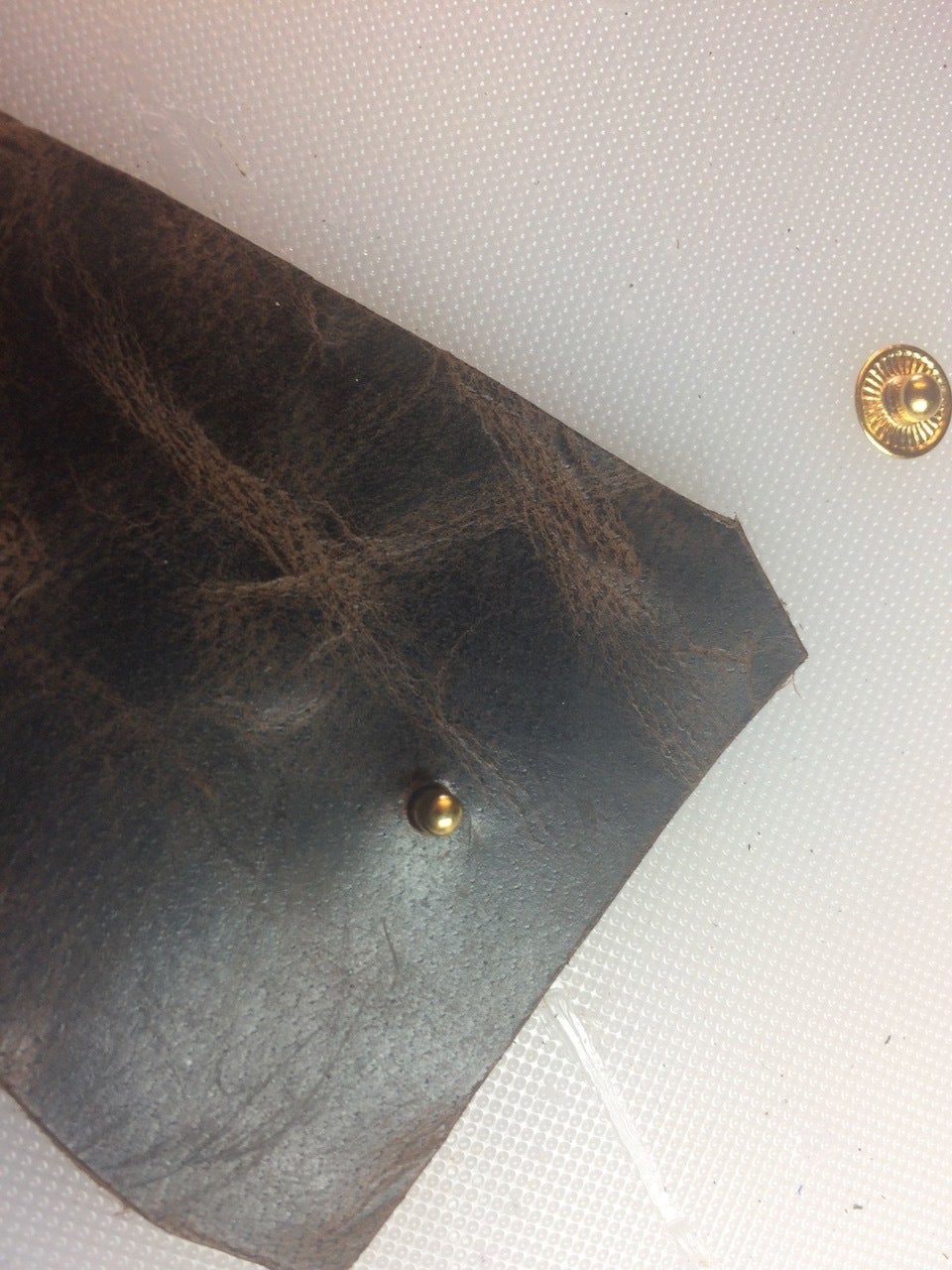

Step 8: Adding a Popper
We need to add a popper to our case so that the flap can be closed properly this needs to be added before the two pieces are glued together.
We first need to mark the position for the placement of the popper. This should be placed in the center approximately 12mm (1/2") below the top of the front of the case. Mark the position using an awl.
Step 9: Fixing the Popper
Having marked the position for the popper.
We use a punch to create a hole for the stud of the the popper to pass through.
Place the stud in then fix the popper.
When fixing the popper to the stud, make sure to hammer the tool on to a hard surface.
When I first started making leather items and using studs and poppers I had all sorts of issues with them coming detached. The issues stopped when I started using a solid piece of granite under the tool.
If you haven't used poppers before It might be worth practicing on a bit of scrap leather with some spare ones first to see how everything comes together.
