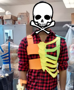

Step 4: Creating a 'Mock-Up'
This is where the art takes over for science - you'll want to take a lot of time cutting the foam to make sure you have shapes as close to your vision as possible. You can cut them all out at once in rectangles and then trace bone shapes over top to cut out later, or you can go ahead and trace bones and then fit them on the form. This is also the time to decide how the armor will be taken on and off - I chose to do a side closure with velcro because of time constraints, but you could do a lace-up or snaps if so inclined.This is where I spent the most time of the project, because you're creating what will soon be pattern pieces that will be traced onto your leather. You can keep referring to your images for reference, or you can let your imagination take over. I decided to add an epaulet to one shoulder, which isn't anatomically correct but turned out pretty funky.
I used a stapler and masking tape to secure the pieces of my pattern together enough for it to be tried on. This doesn't have to be very secure, as you'll probably have to make adjustments when it's on a real body. It's a great idea to have scissors, extra foam and tape on hand so that you can shorten and lengthen the 'bones' as needed. I decided to add a few support pieces at this point to keep the parallel pieces from shifting around and hitting each other too often. If you see any aesthetic changes that need to happen, such as trimming that needs to be done or scale that should be adjusted, go ahead and draw directly onto the foam with a sharpie or pen. This is a great opportunity to put marks on the armor that you can check later to ensure things are lining up.
Pay special attention to how the person moves in the armor - if they have a lot of action planned then you might have to give them more space at the waist, arms and neck than you originally thought. Don't be frustrated if foam tears or comes loose, that's a great way to tell where the leather will have to take a lot of strain. Things that are seen now are issues that you can prevent later.
Step 5: Refining Your Pattern
At this point you should start refining the foam pieces before cutting out of leather. For me this meant making some of the bones much thinner and more curved, as you can see by where I cut and stapled the foam piece back together. Pay special attention to any notes you've made or markings you've put on the foam! At this point I did an intense round of tracing anywhere that foam overlapped (the CF 'sternum' piece for example) so that I could refer back to it if I got lost. I also numbered all of my pieces to avoid bones getting mixed up or attached in the wrong places. After I had everything thoroughly marked I dismantled the foam mockup and used it as my pattern. I made sure to clean up my lines so that they would be very clear as I was cutting them out, and transferred all of my markings, from numbers to connecting lines.
