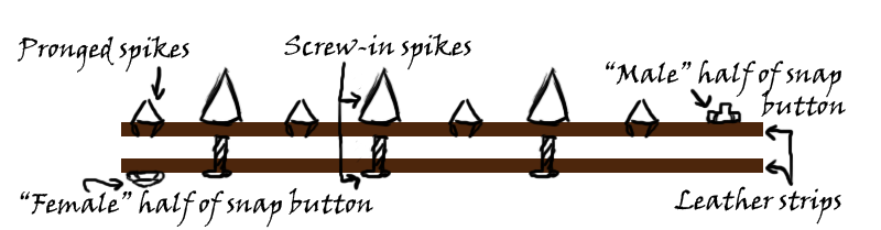

Step 2: How the Spiked Cuff Is Laid Out
This diagram I drew should be clear enough for you (those cones are spikes, the smaller cones are the studs), but if you have any questions I have included a brief explanation of the cuff layout.
There are two layers to this spike cuff, the top layer, which you can see, and the bottom one. These two layers are superglued together to add strength and durability to the cuff. It is attached by snap buttons which are sewn on. The pronged studs and male half of snap button are attached to the top layer, and the female half of the snap button and the screw of the spikes go through the bottom layer.
Why two layers? And why this odd attachment of studs and buttons and two layers of leather?
This is to give the spike cuff a seamless look, so that the pattern of studs and spikes flow together without an awkward button in the way. Where the female half of the snap button is, above it is a stud. When the cuff is worn you will not see any buttons, just the studs.
The studs are attached to the top layer because the prongs were not long enough to go through to the bottom layer. Likewise, the spikes go through both layers because the screws were too long to go through just one layer. It was more snug with two layers of leather instead.

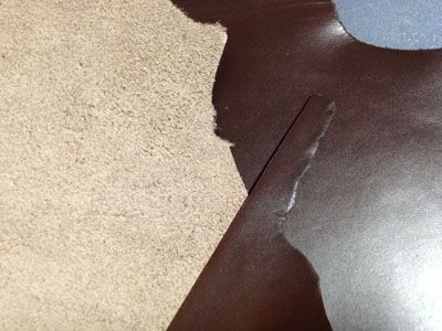

Step 3: Cut the Leather Strip
Measure your wrist, making sure to have allowance for where the buttons will go. Decide how wide you want your cuff to be.
With a gel ink pen (make sure you can rub this off the leather later!) and a ruler, draw the outline of your cuff lightly on the shiny side of the leather with your measurements.
I made this for my friend Jean, so I used his measurements.
Place the ruler on the lines you drew, and use your razor or craft knife to score along the lines. Make sure your blade is perpendicular and cutting the leather at a 90 degree angle. You do not want to end up with a cuff with slanted, scruffy edges.
Then use your scissors to cut the leather out, again making sure to cut at a 90 degree angle, and cut out along the scored lines.
It is vital you make the edges of your leather straight and at 90 degrees. It would look very awkward later when you glue it on the other piece of leather and the edges aren't matching up. This is why I scored the lines with a razor first, partially cutting straight through the leather makes it easier for my scissors to follow a straight line.

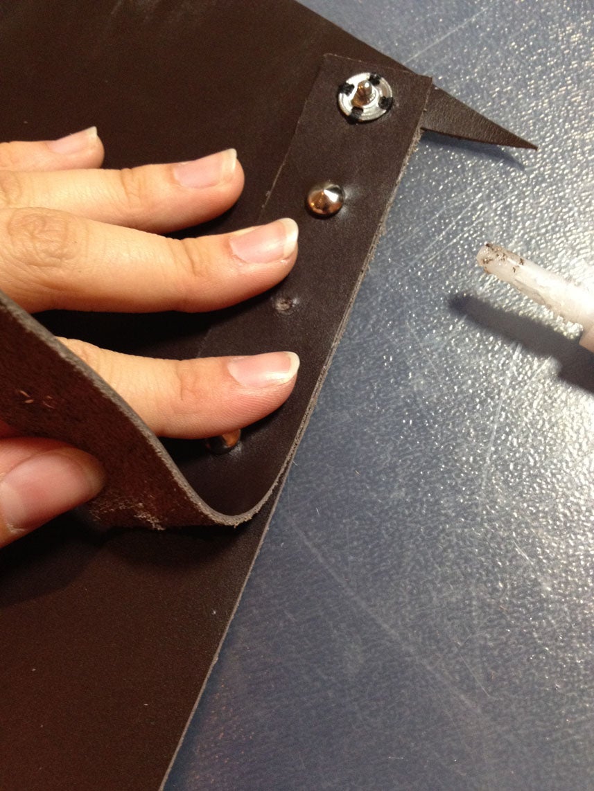

Step 9: Glue the Leather Strip on Another Piece of Leather
Now glue the leather strip on the piece of leather that you had originally cut out from. If you had cut it in a straight line, the edges of the strip should match up with the edges of the cut leather.
Glue everything, but DO NOT GLUE THE END OF THE LEATHER STRIP WHERE THE STUDS END. You may glue the end of the strip where the male snap button is, but do not glue the opposite end! You will sew the female snap button to the underlying leather strip, so please do not glue this area. Refer to the pictures to see where I am talking about if you are not sure.
Hold the edges together with binder clips while it dries. Bear in mind that the binder clips may leave an indent in the leather if left for too long, though.

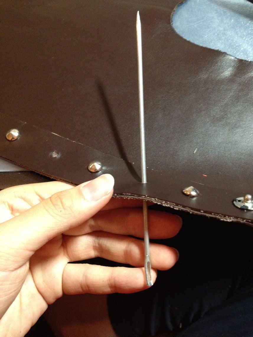

Step 10: Poking Holes and Attaching Screws Through the Bottom Layer of Leather
Now you see the holes you poked for your spikes/screws earlier? Using your needle, poke holes through the holes you have made earlier through the bottom layer of leather. Then you may put the screws in. Again, be careful with the needle. You may get frustrated pulling it through, it's okay, but be careful not to pull too hard and rip the leather or poke yourself.
When putting the screws in, don't just push them in, make a twisting motion with them so that it goes into the holes snugly.

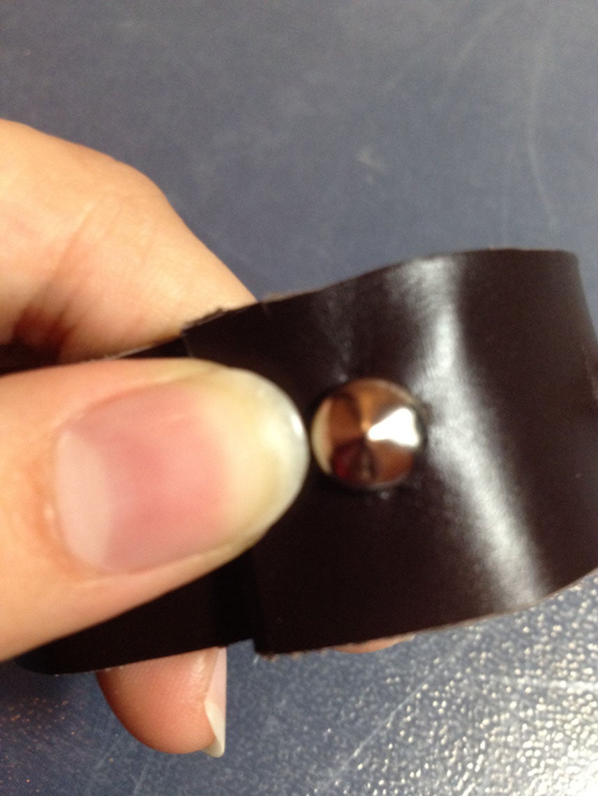

Step 12: Marking the Placement of the Female Snap Button
Now we will attach the other half of the snap button. We need to line up the buttons very carefully, so that we don't end up with a cuff that doesn't overlap the other edge properly when it is worn.
Affix the female snap button temporarily to the male one. Fold the whole cuff over into a circle, with the end that you have not glued over the buttons. Make sure the overlapped edges line up nicely. Press the point of the buttons into the leather - hard. This is so you make a visible indent in the leather so you can have an easier time attaching the female button accurately. Then before the indent fades, mark it with your pen. The pictures can explain better than I can, please refer to them if you are not sure.
If you don't do this and simply sew the buttons anyhow, you will end up with a cuff that does not overlap properly, with one edge partially overlapping the other and the rest sticking out over your wrist.

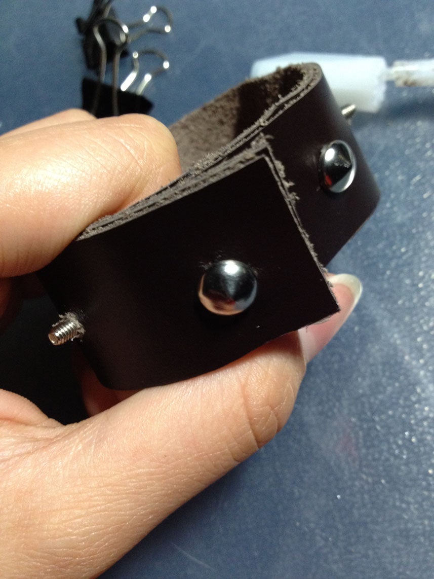

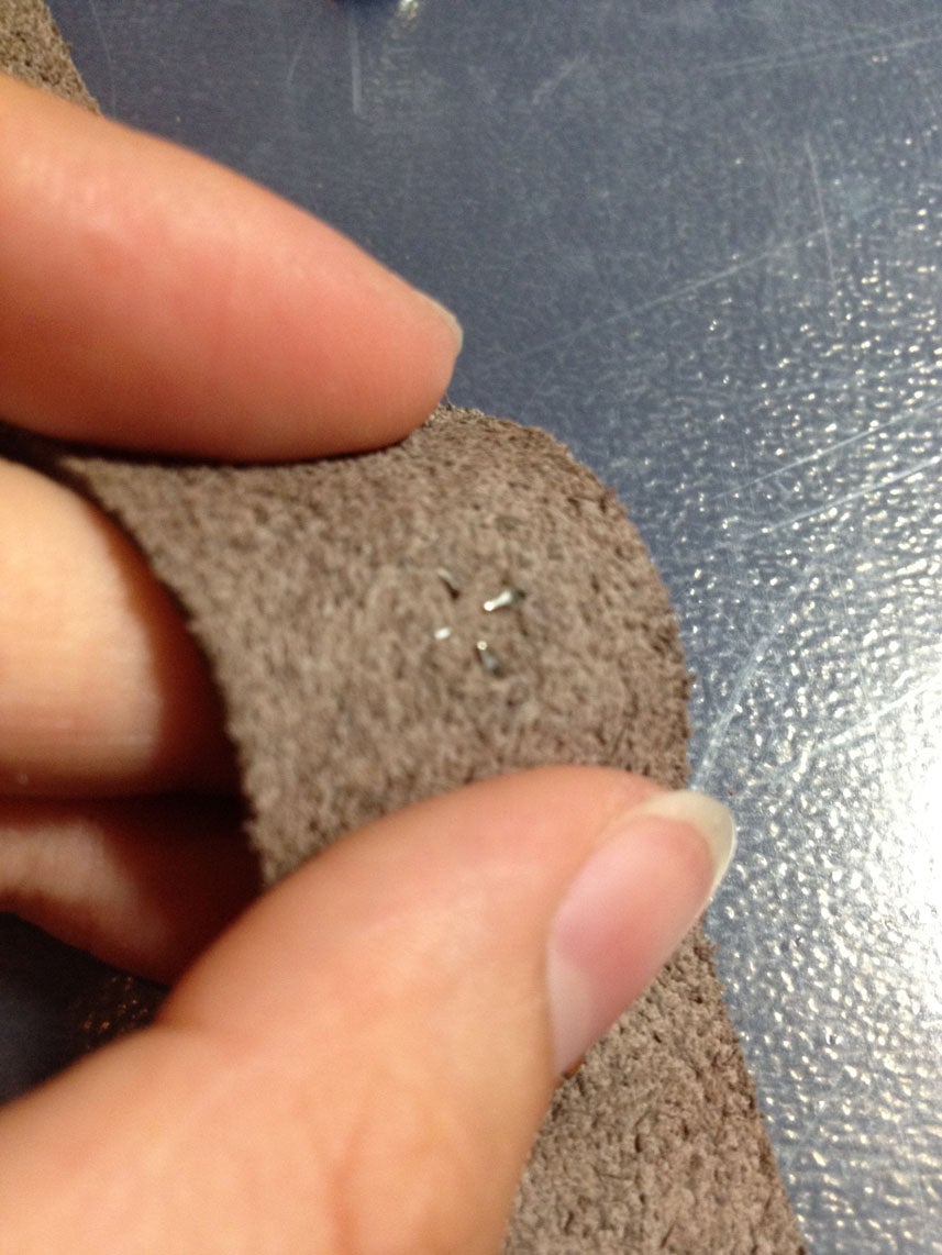

Step 14: Fine-tuning the Edges
When I curled the cuff around, I found that the edges of the cuff were not glued down properly and so it kind of scrunched up on itself. This is easy to fix, just add more glue on the edges. It is a bit more fiddly though trying to get the nozzle of the superglue into the small space, I should have glued it more thoroughly earlier. Pay attention to the corners since they are the most likely places to become unstuck with wear and tear.
It is worth noting that superglue makes the fuzzy side of the leather really hard and scratchy and dark, so try not to get it there. The fuzzy side of the leather will very quickly soak the superglue up, so it is best to place glue on the shiny side of the leather.
You can use a razor to trim down the edges if they are not quite lined up properly.

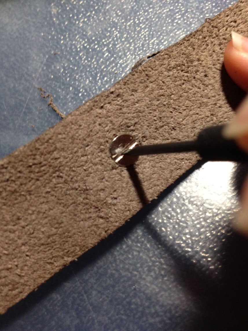

Step 15: Adding the Spikes
Get out your spikes and twist them on to the screws. You can use a screwdriver to help you tighten the screws.

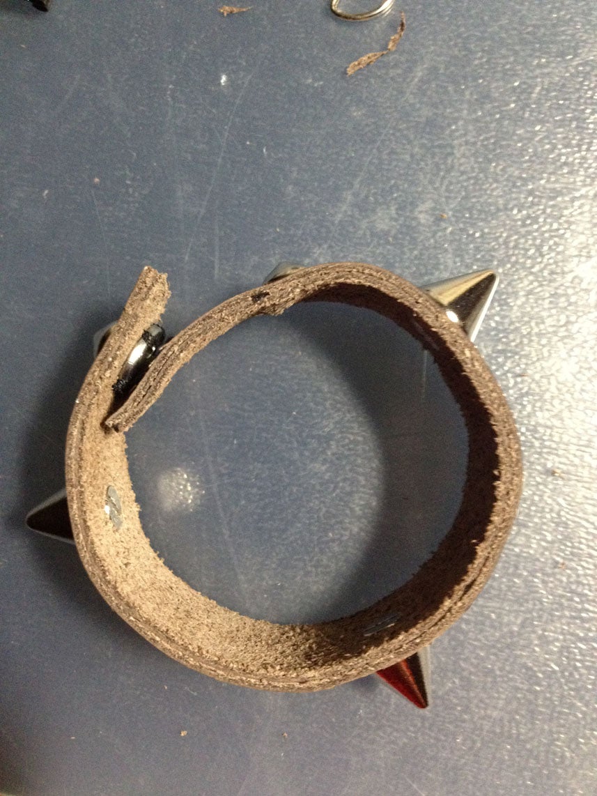

Step 16: Done! Wear Your Cuff!
It is finally done! Put it on and enjoy. :D
This was the first spike cuff I handmade myself, and when I was done I kept it on the whole day not wanting to take it off. :D But I made this as a gift for my friend Jean, for his birthday, so I gave it to him. He seemed to like it, so that was satisfaction enough. :D
Hopefully anybody who wishes to make a spiked cuff out of simple materials and methods can learn from my tutorial. :) If you do make one of your own, please post a photograph, I would love to see how yours turned out. :D
Now looking back, perhaps to improve the design of the cuff, perhaps you could use a heavy-duty sewing machine to make decorative stitching around the edges, and perhaps buff the edges of the leather. I would have done this if I could, but I don't have a sewing machine and I do not know how to buff leather edges. Maybe another time. :D
Thank you for taking the time to read this! Comments would be very much appreciated!
