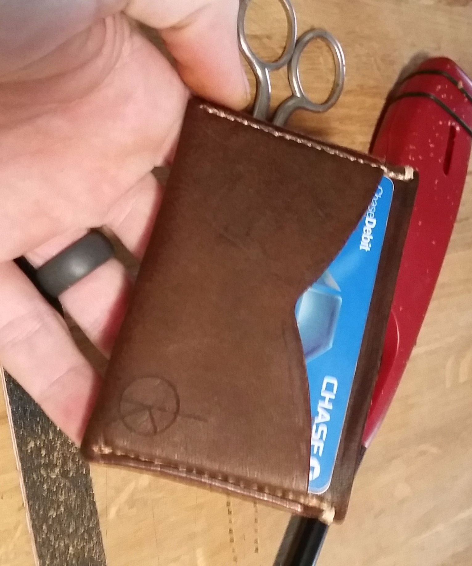

Step 3: A Week's Work of Practice.
Just keep going. Keep researching. I did all this off and on for a week and it was super satisfying. I hope this helps. Steps after this are dying the leather and slicking the edges(maybe some assembly if your design calls for it), but I'm not going into that here. Just follow the manufacture's instructions and check out some Youtube guys. The fellas at Tandy Leather seem to have a few very helpful videos, just a quick search away!
