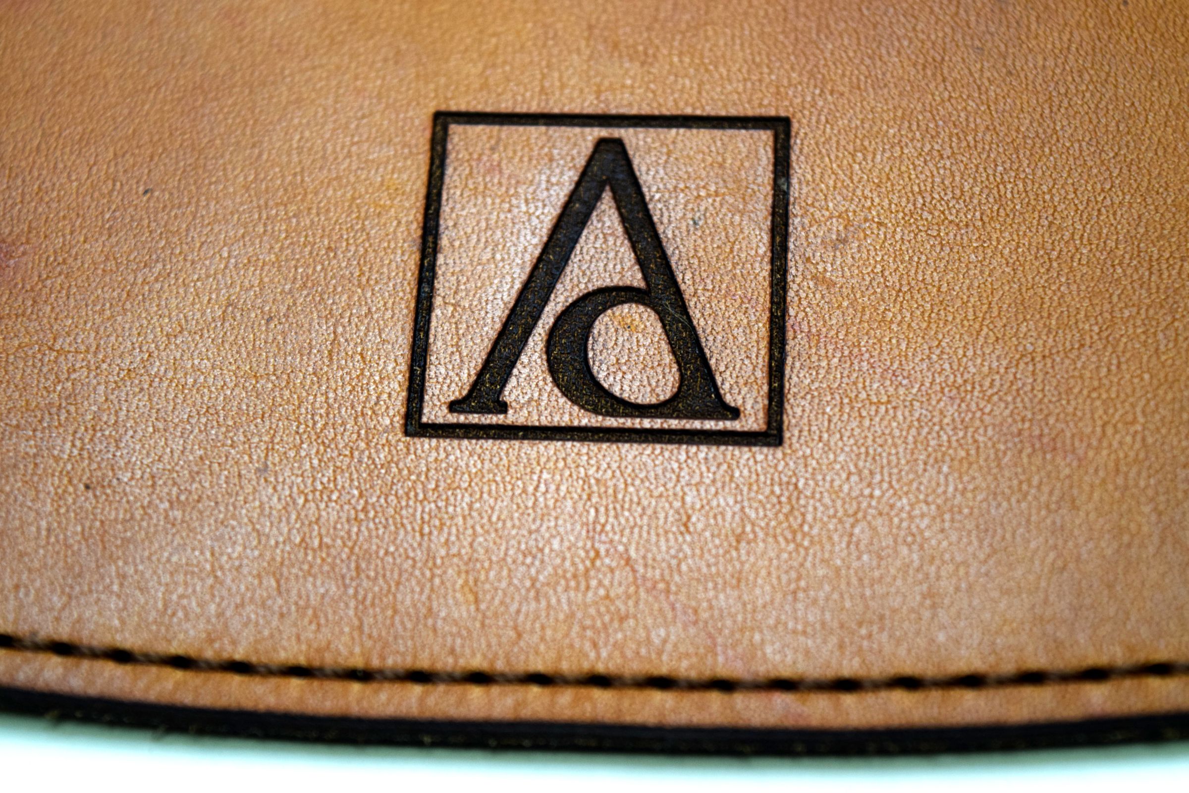

Step 6: Adding the Snaps
The final stage of the process is adding the snaps. This stage is pretty easy, and you should follow the instructions on your snap setting tool for the specifics on how to install your snaps. What I will mention here is the importance of where each particular snap component is placed.
The snaps must be placed so that they can interface with the opposing snap in their same corner while in the "valet tray" configuration, as well as interface with their respective snap on the other side while in the "pouch" configuration.
In order to achieve this, the snaps must be placed in the configuration shown in the images above. One "side" of the pouch will have the "Button" snaps placed on the outer positions, while the "Post" snaps are placed at the inner locations. The opposing "side" of the pouch will have the "Button" snaps placed on the inner positions, while the "post" snaps are placed in the outer positions.
