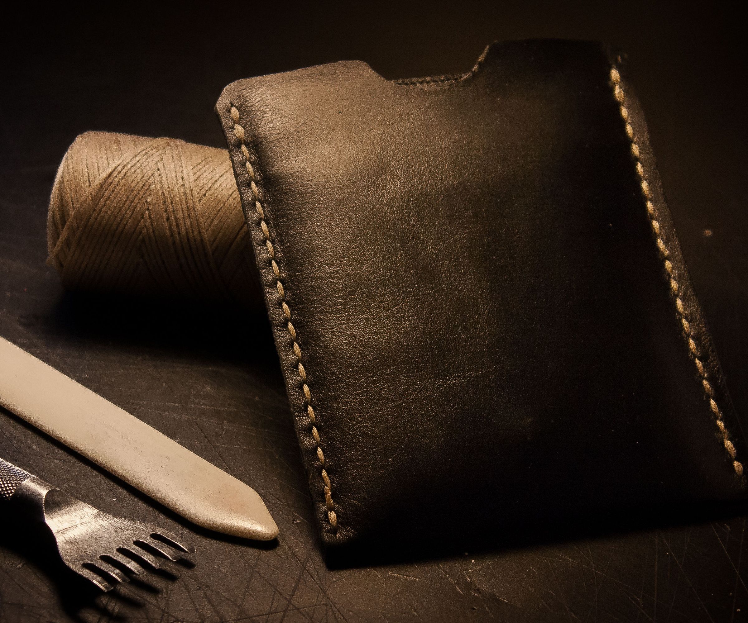

Here we are: the final stage! Glue is already keeping our sheath together, but of course it's not enough, so now we will add the stitching.
First I used a leather groover to make a groove all around the harmonica: why? Because when you make the stitching, thread will be encased in that groove, so that it is not exposed to excessive rubbing, that can wear it down.
Then I marked stitchings every 5 millimeters. I used ruler and pen because I don't have an overstitch wheel, if you have one, use that. Once all stitchings were marked on the sheath I poked holes with an awl.
After that I flipped the sheath over and continued marking and poking stitching holes on the flap too, and then I used the groover again, all around the flap and the back (see images).

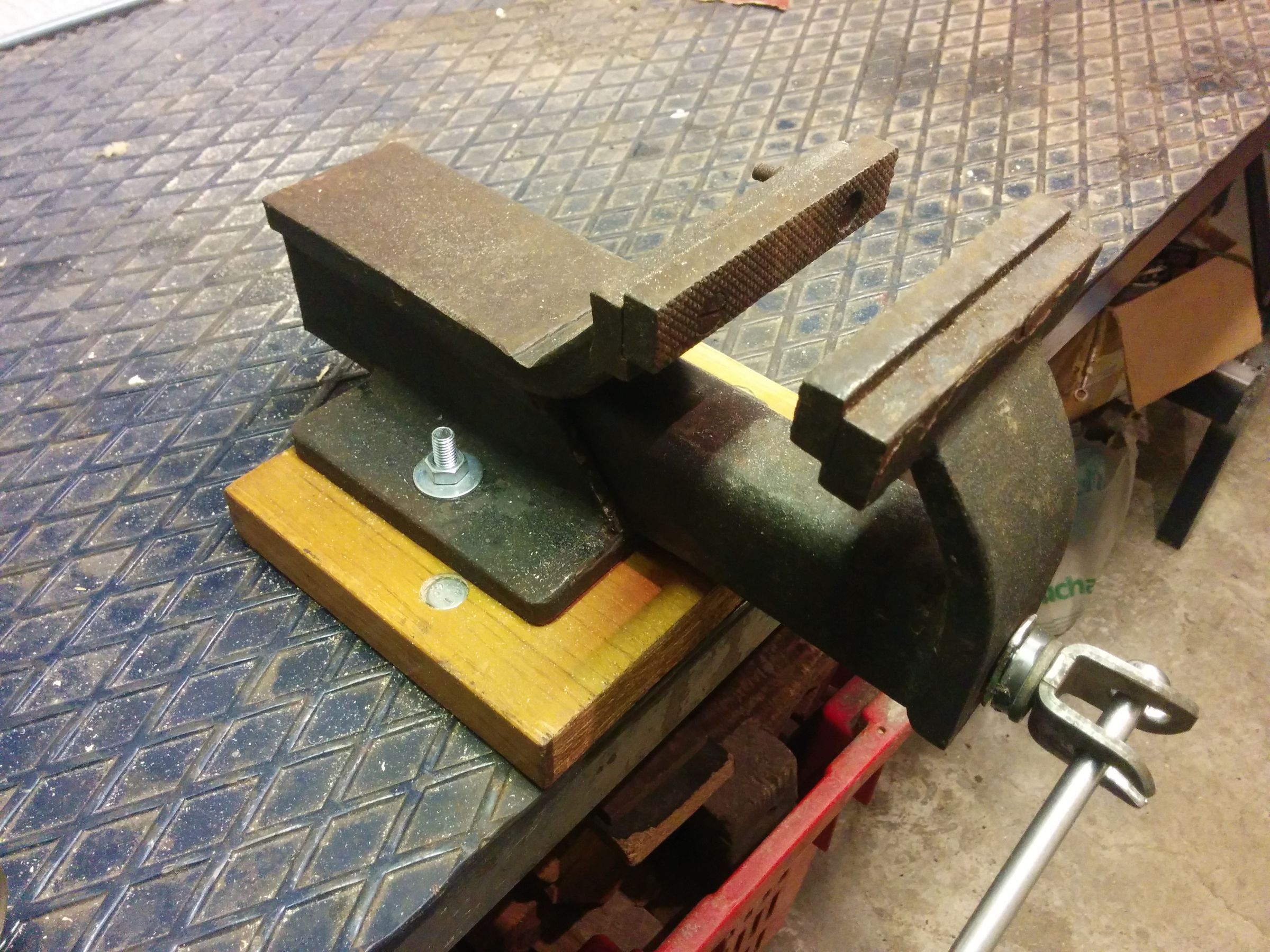

Now the real stitching. I don't have a stitching pony, so I had to improvise with a clamp and a small bench vise, but it worked quite well for me. Clamp your piece into the vise, thread your needles and stitch all around with the stitching technique you prefer. I used saddle stitching. I'll not explain how to saddle stitch because it's quite difficult to do it in a written tutorial, but you can look at Ian Atkinson's video-tutorial or any other explanation video on youtube.
