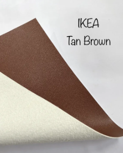

Faux leather (2 colors)

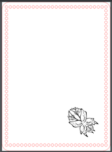

Step 2: Create Acrylic Backing Laser Cut Design
The Everdoodle has a transparent backing acrylic to display art through. This is a piece of acrylic that is exactly the size of the notebook, with 4mm holes dotting the edges to let it be stitched in with the leather.
The acrylic to be used is 3mm, but any thickness thinner will work. Alternatively, using no acrylic works as well, just modify the back design to replicate the front, acrylic-less design.
Create this design through a vector application such as Inkscape.
