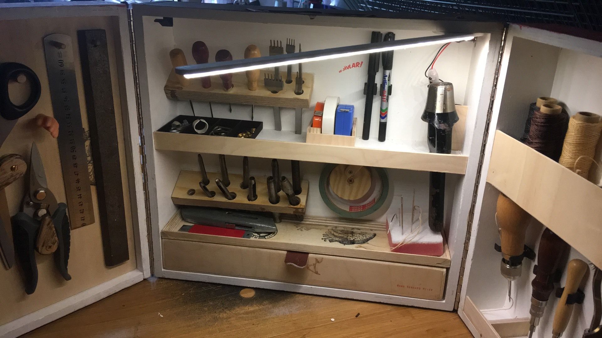

For this project, I brought out my Leatherworking toolbox. So happy I made this because now I know where all my tools are, for a while:-)
https://www.instructables.com/Portable-Leather-Workshop/
