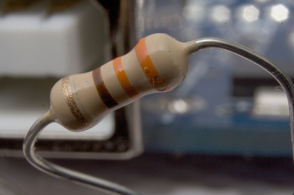

Step 1: Unregulated Capacitive Power Supply
For Red Led
We Use :-
1. 105K/400V Metallized Polyster Capacitor
2. 47E/2Watt Bleeder Resistance
3. 1N4007
4. 220 E/1Watt Resistance
5. 10uf/450Volt Electrolytic Cap
6. 1 M / 1/4 Watt Resistance
For Green Led
We Use:-
1. 474K/400V
2. 10E/1 Watt Bleeder
3. 1N4007
4. 220E/1Watt Resistance
5. 10uf/250 Volt Electrolytic Cap
6. 1 M/ 1/4 Watt Resistance
We Use :-
3. 1N4007
For Green Led
We Use:-
1. 474K/400V
3. 1N4007
