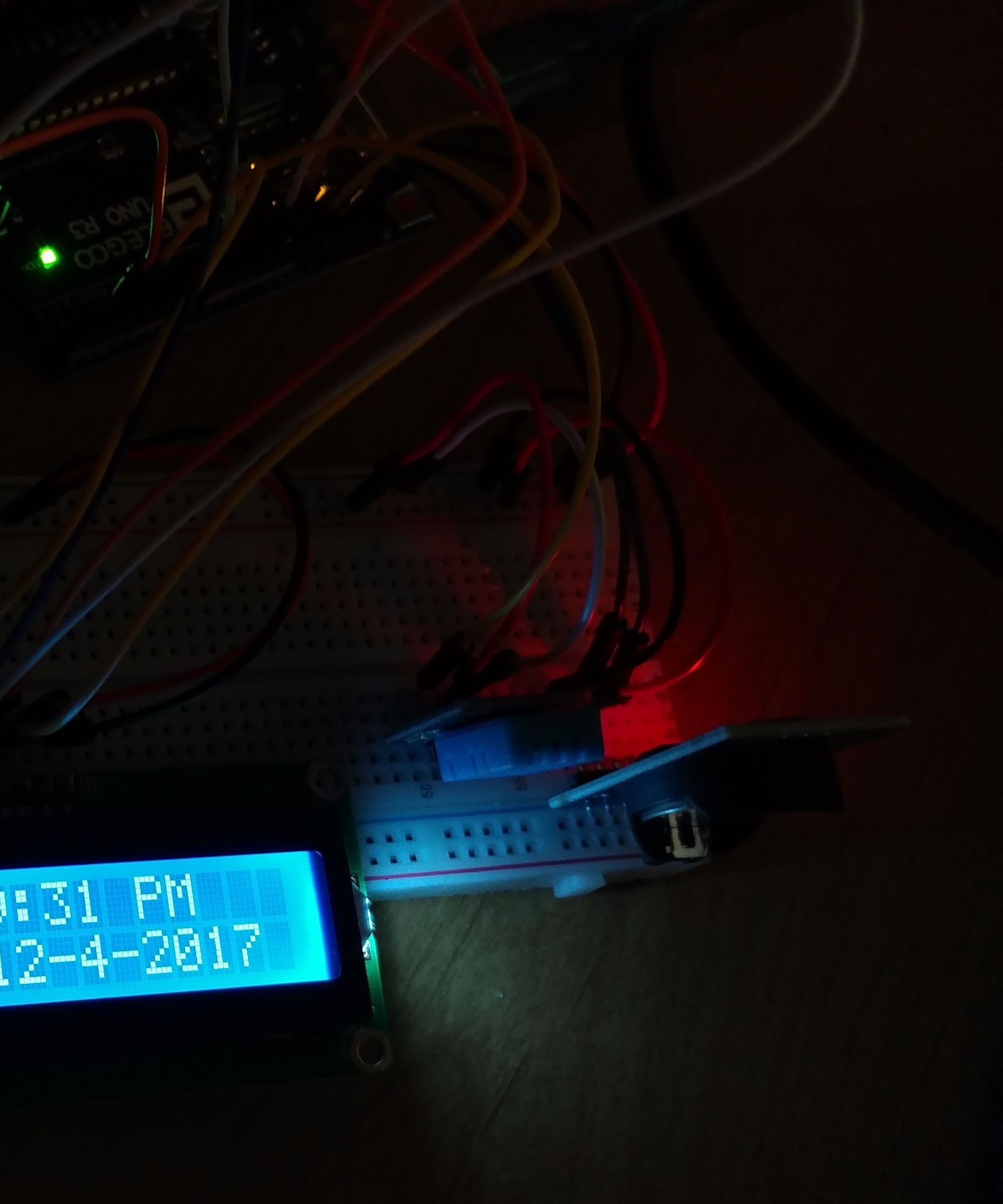

Step 1: Connections
1. First connect the 5V and GND to the power and ground rails on the breadboard.
2. Connect the left potentiometer pin to the hot and the right most to the ground.
3. The middle/top pin should go to an analog pin, I chose to use A0.
4. Connect the led's ground wires to the ground rail
5. Connect the hot line from the LED to a 220 ohm resistor and then connect those to pins 12-8 so the fading is right.
Apply the code and bam. (Code in step 2)
