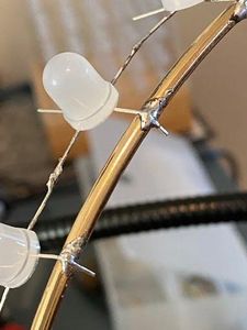

Step 1: Soldering LED's

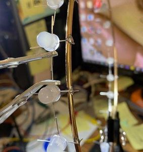

I found some 8 " diameter metal rings on Amazon that I thought would make a good base for my LED ring. It was actually a pleasant surprise when I found I could solder to them easily! The term "easily" is relative - the ring is heavy and a lot of heat is required to get it hot enough, so my 40 watt soldering iron was turned up all the way, and it usually had to sit there for 5-10 seconds before solder melted. I wet the ring with solder first before attempting to solder an LED to it, and always used clip heatsinks on the leads of the LEDs.

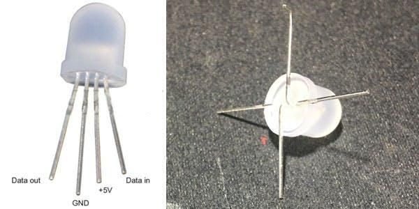

Step 2: Making LED's Rings With Metal Rings

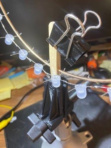

As part of the lead-form operation, I put a small bend at the end of the ground lead. It both makes it easy to identify, and well as making it easier to attach it to the ring.
Another preparation step before soldering LEDs to the ring is to mark off 24 even spaces on the ring where the LEDs will be placed. I also found the need to clamp the ring vertically while attaching LEDs. I ended up using the contraption below to hold the ring in place,
Step 3: Connecting Data Cables
After all the LEDs are on the ring, you should have one data-in lead for the ring as a whole, with the data-out lead across from it ready to go to the next ring above it. At this point, we are ready to connect all the +5 volt leads together with a straightened piece of 22 gauge tinned copper wire. Straighten a 26" long piece of wire by clamping one end in a vise and giving the other end a hard pull with pliers. Then attach it to the LEDs as shown below.

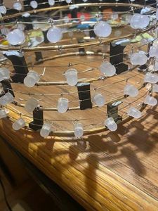

It is important that the LEDs in each ring line up with their counterparts on the other rings. If the LEDs are spaced out perfectly, this isn't an issue, but I had enough small variations in spacing that I found it necessary to use one ring as a template for the others, always carefully placing the open data-in lead (the one not connected to a data-out lead) in the same place. (If you look closely at my tower, the first two rings don't line up with each other very well. But after that, I used this template approach with a much improved result.)
Once you have at least four rings built, you can start the process of assembling the tower. The initial assembly of the lower four rings is probably the most critical part of construction. We don't want to create a Leaning Tower of Pisa! To put rings together, you will need spacers 22mm high to create the 1" space between rings. I used 3D printed black plastic for my spacers, but 1/4" dowelling would work just as well. To hold the spacers in place, I used a little Blue Tack, a temporary adhesive.

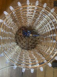

The rings are held together to form the tower using six 12inch long acrylic rods. It is important to get everything exactly in place before applying these rods.. Once the rods are hot glued to the rings, it is nearly impossible to make any changes, so get everything where you want it first. Once you have everything in place, you can turn the tower on its side and hot glue the acrylic rods to the rings. The photo below shows the first four rings with the first three rods attached. Three more were then attached for a total of six. The rods are placed between the LEDs with 4 LEDs between each rod.

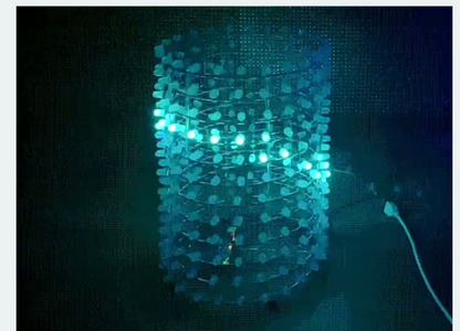

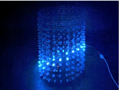

Step 7: Finished Led Tower
So above is a picture of the finished tower. The Arduino UNO is installed at the bottom. I actually used my 4 remaining acrylic rods to suspend the UNO, using hot glue to attach everything together. An alternative approach might be to mount the tower on a base with the UNO inside. There are 4 connections to the UNO, Ground and +5v rails which connect to all 12 rings, and the two data lines to pins 6 and 7.
