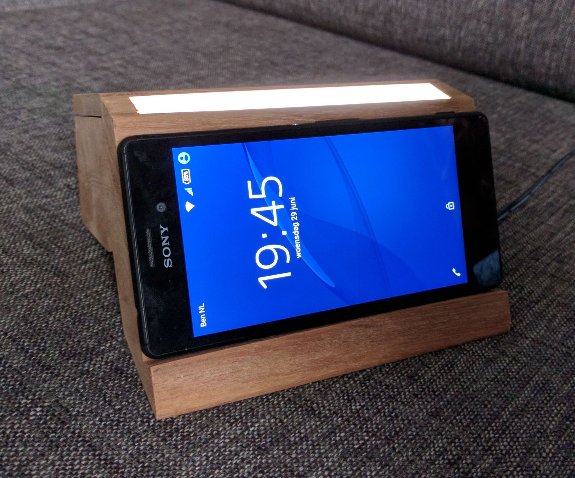

Step 3: Making the Stand
The Wooden stand is made up of 4 identical pieces.
To make this you will need a piece of wood thats at least 520x30x50mm
with this piece of wood you need to saw the profile of the first picture
Now you will need to saw this piece in to 4 pieces of 130mm in a 45 degree angle.
now glue them together with wood glue

Step 5: Putting It Together
if you did everything correctly you now have color changing leds, a wooden stand and a perspex top.
now you will have to hide the arduino in de wooden stand.
To fit the arduino in the stand you will have to screw it onto the bottom plate.
to fit the power supply you will have to make a hole in one of the sides.
glue the bottom plate to the stand where the hole fits the power port
now you can place another wooden plate onto the arduino buit make a little hole for the wires to go through.
i used double sided tape to secure the led inplace you can also do this with hot glue.
now slide the perpex top into the wooden groove.
