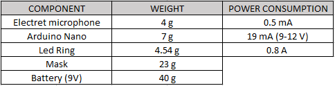

Step 5: Power Consumption and Weight
I am attaching a table with the consumption and weight of the components that I have used in this project. Two very important factors as we seek the balance between weight and battery life.
We also have to take into account the weight of the wires used and the adapter for the battery.
