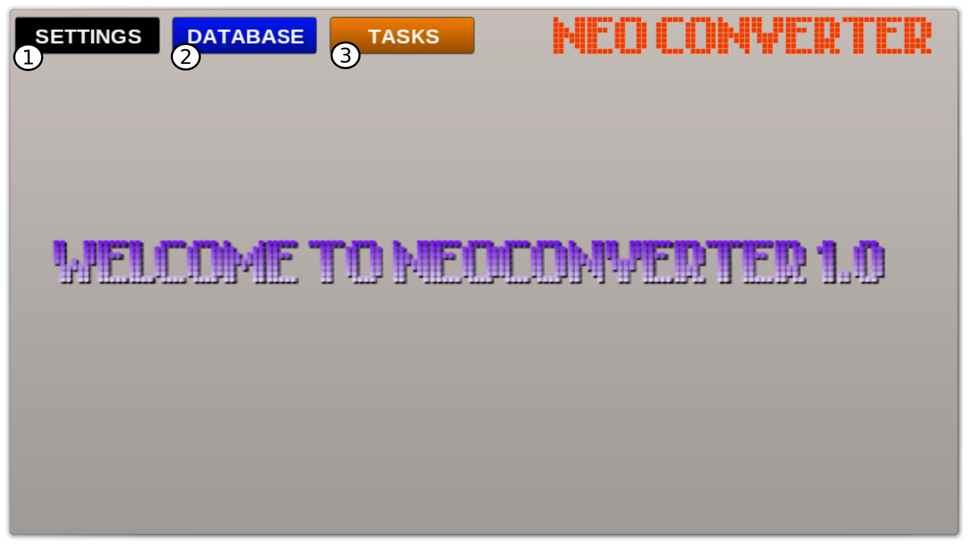

Let's start immediately from the initial screen (the images can differ graphically from the final version) in which 3 sections are clearly seen.

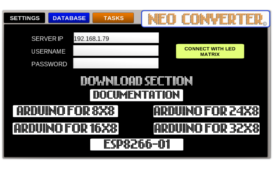

By clicking on the Settings button, the connection screen with the ESP8266-01 card will open. On the ESP8266-01 the server that will receive the commands has been installed previously (see specific section in the manual), there is also a wifi manager (read the documentation on https://github.com/tzapu/wifimanager) to facilitate the connection to your wifi network. To obtain these data it is necessary to connect the ESP8266-01 to a wifi network. At the first ignition
use the WiFi network search from your mobile phone and you will notice a network with ESPXXXX name. Click on this network to connect and wait for the Wifimanager screen to appear on your browser (see Figure 1). When this does not automatically happen, know that the IP of the network card is generally 192.168.4.1 which you can type on the browser in order to access the Wifimanager web page. From this web page you will choose the name of your network and put the access password. Wait for the reference IP to be displayed (if your sign is connected well and the wifi connects to your network for the first time, or look for the screen of your modem / router which IP has been assigned to the network card. screen (provisional) on the management of the connection, fill the data of the requested fields and press the "Connect to the LED matrix" button.
