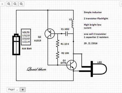

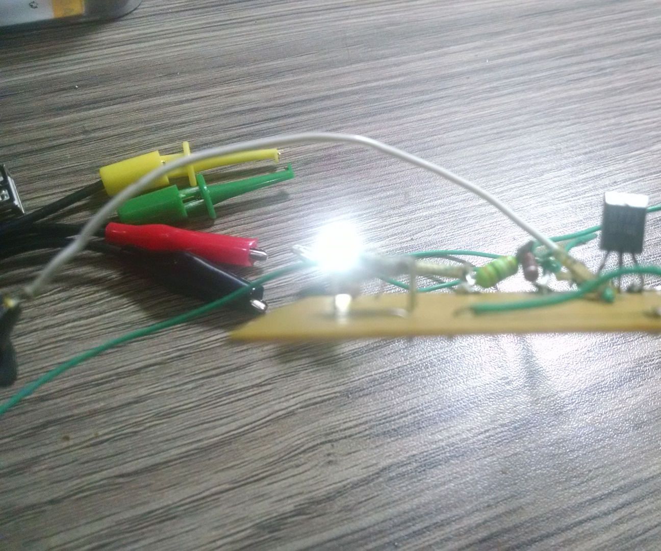

1.Follow the schematics and solder the circuit as shown

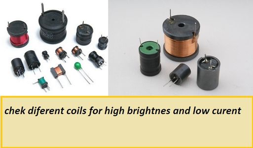

chek diferent coils for high brightnes and low curent
