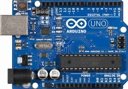

Step 2: Arduino Sketch
Download the Arduino software (IDE) ( https://www.arduino.cc/en/Main/Software ).
The following code is deign to control a servo, rotating it 45 degree from 0 degree to 180 degree with a 15 second delay in between.

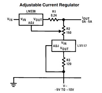

Step 3: Current Regulator Box
  • Image 1 show the schematic of the adjustable current regulator. Depending on how many different value you like to test. That's how many trim pot you're going to need.
  • Image 2 is an example for 4 current option using a 200 ohm trim pot.
  • Image 3 and 4 show how to set up a rotary switch to select the different out put and the rocker switch is an on/off switch to save energy.
