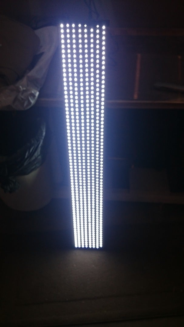

I first stapled the strings to the ceiling to see if it would work. mixed feelings...... i have 2 strips at 16 feet and i feel i would need at least 4 more to get the kind of light I would be happy with.
So i decided to go ahead with the testing and put lighting the whole garage on hold.
I had some clear double wall plastic left overs i cut it ~6" wide and 4' long. Its thin and light and ridged enough for this project. The strip it tells you where you can cut so you don't damage it. so i stuck all the LEDs on the plastic and soldered the connections (you can buy connectors if needed). I opted to mounted the power supply on the back side. Over all its about 1 1/4 in thick picture above it's sitting on a 3/4 hard wood shelf.
I sure there are better ways of assembly, this works for me and what i'm doing here.

This is the information I was having a hard time finding the answer to. how much power does it use? everyone had something different to say and the paper work does not tell the actual draw just recommended. So running over night. ~8 hours this is what the box tells me.
2 X 16.5" or 5 meter strips totaling 33' or 10 meters configured in this meaner use 55 watts and draw a current of .74 amps. those numbers are way lower then the manufacture states.
From what i understand the power supply is rated higher then the LEDs require so I believe this is the max the LEDs will consume. comment if this is untrue.

1. 8 LUX = is temporary lights 10 CFL 100w equivalent
2. 307 LUX= 4X T8 florescent lights mounted across the bench (end to end not side by side)
3. 527 LUX = LED panel we just made together, placed at the same height as the T8s. i know its a dense light panel only 4 foot wide but you get the picture.
Closing if i were to try and attain lighting happiness i think i would need 6 total LED strips and even then I dont know for sure. these LEDS are very bright but is using LED STRIPS to light your work area as well as save money i have to say not for this guy. If all you needed was light to get to and from the car or to find that can of paint for the back room then ya maybe this is for you....
