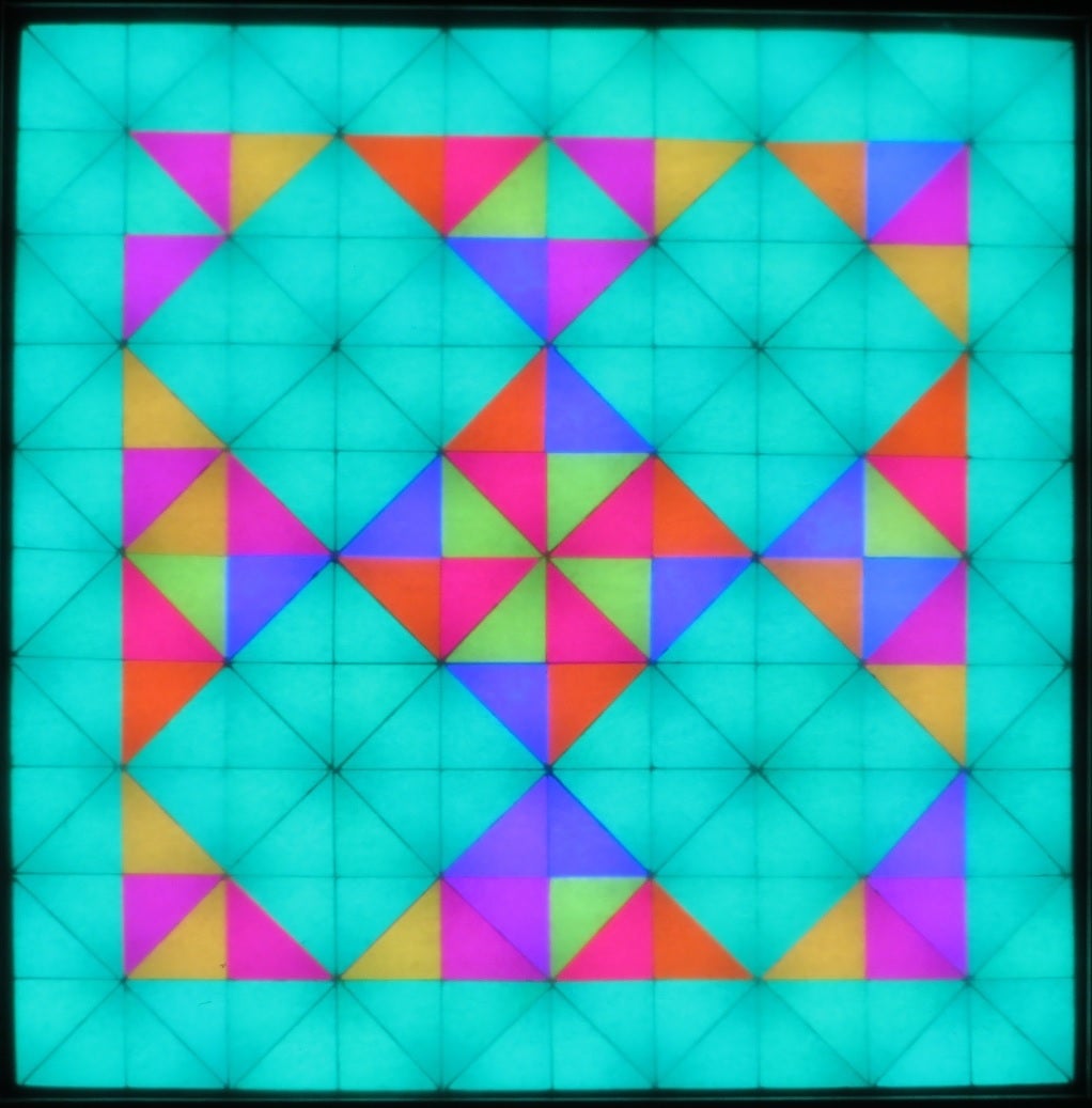

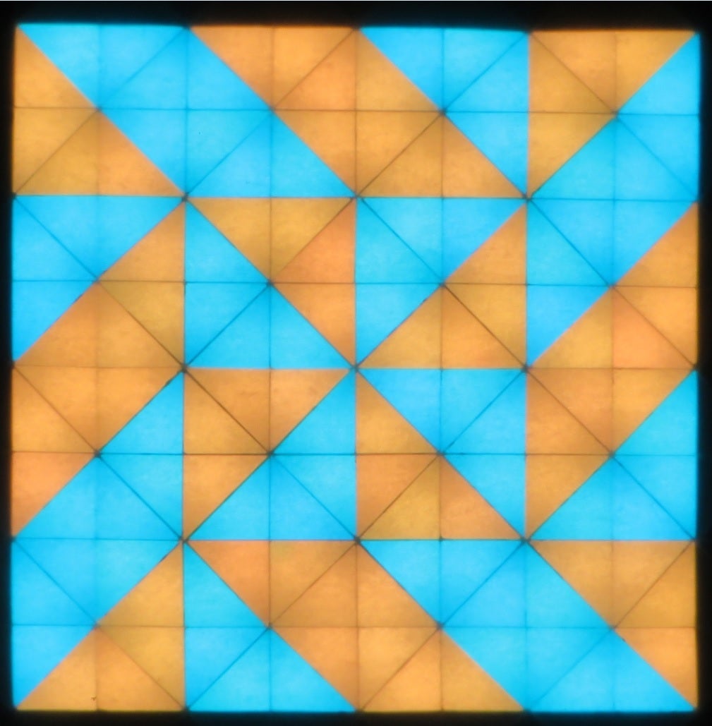

The most beautiful colors can be displayed with the LED strip. But where do you leave them. I wanted to work with it, but then it had to remain compact, the whole house had to be lit.
The idea became something like an LED table but as a panel, so a NeoPixel light decoration that can display various light effects / patterns.
First thought was a NeoPixel board of 16 times 16 neopixels. These are 16 * 16 cm which I found just a bit too little and so I came to a size of 25 * 25 cm.
While searching the internet for possibilities and code for patterns I came across a lot of information.
I found the triangle pattern from https://www.instructables.com/Half-Square-Triangles-LED-Art/ to have something compared to the squares or circles that are usually used.
There is a lot of example code available from FASTLED.
From all this information I put together what I thought would be nice, with or without some adjustment, and added something else.
So if the code sounds familiar, yes most of it can be found on the internet, for which my thanks go to the creators.
I also integrated the code of the triangle and adjusted it in such a way that it changes the foreground and background color every x adjustable number of patterns.
Furthermore, everything can be set via an IR remote control.
The condition was not to be too expensive, so a low budget project, and to be made with simple means. But if you want to have it ready in an afternoon, stop reading because that will not work. In any case, I was able to keep myself busy with it for the necessary hours. I will briefly describe how I made it in a few steps. You are free to make it your own of course.

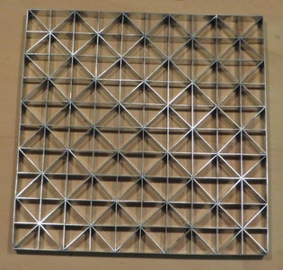

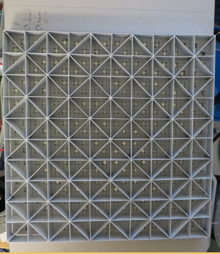

Step 1: The Grid
The grid.
I made the grid from a number of zinc strips of 25 * 1.5 cm and 0.8 mm thick.
In this 9 slots have been sawn to just over half of the strip. These can then be assembled as a square. On the outside you solder a strip so that the square is closed. Then cut the short pieces and put them in.
I was able to solder it in various places so that it became a whole. My soldering iron was actually too light for this job, but just enough to get everything together.
Make sure that the cross connections look as tight as possible because they are always visible in the light pattern.
The strips I used were made of zinc because I thought I could use the reflection to reflect the light from the leds.
But I forgot that zinc dulls pretty quickly after you work it, and it is not to paint.
So iron strips and then just paint white is best.
Furthermore, it turned out that every small slit lets light through to the adjacent compartment, which is not the intention.
I solved this by sealing everything with a little white wood glue. This flows somewhat in the sleds and drys almost invisible.
Top and bottom must be completely flat. That also to prevent light from passing through. I sanded everything exactly flat with sandpaper.

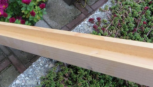

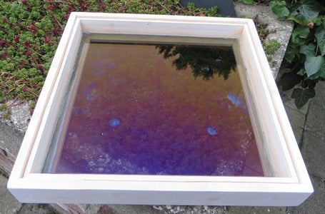

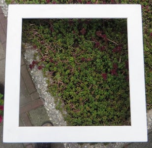

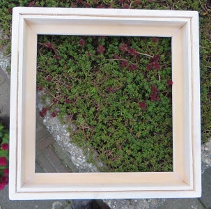

Step 2: Frame Work of the Housing
A while ago I had found a number of U beams by some waste wood, which had served as transport protection, which now came in handy.
I sawed off one side of this so that I was left with an angle profile. Then I sawed four pieces with a length of 32,3 cm so that I got an opening of just over 25 by 25 cm. Glued together, sanded and done. With some white paint on it it looked fine.
Only a piece of glass or plexiglass remains
I still had a conversion screen that used to be placed in front of CRT monitors to get less tired eyes. It consists of double glass with a greenish coating in between. I cut the glass to size using a tile saw / tile cutting machine. The edges were a bit jagged, but since they are not visible, that is not a problem. The glass was glued with silicone sealant.
This glass gives a very good black effect on the Neopixels that are not lit and has almost no influence on the color.

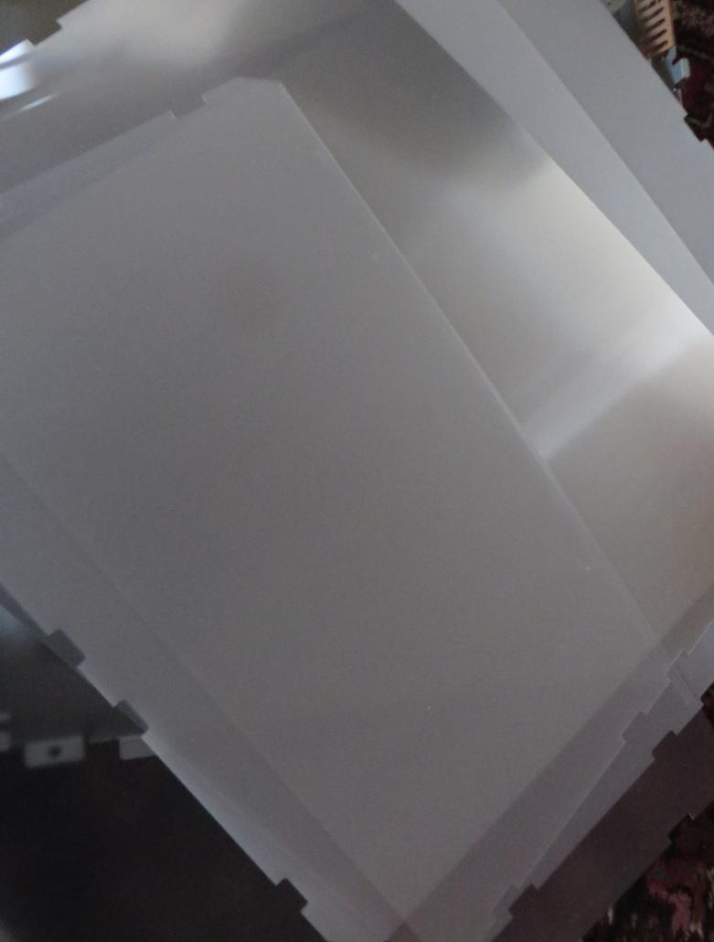

Step 3: Good Light Distribution
To get a good light distribution there must be a filter layer between the glass and Neopixels.
A faulty monitor offers a perfect solution for this. A screen contains a number of plastic foils that distribute the light perfectly and sometimes there is also a thin plexiglass plate, so you have everything complete. Remove them all at once, so you don't have to find out how they should lie to get the best light distribution. Also be careful with finger stains and dirt, plastic film attracts dirt, because everything is visible afterwards. I have added another paper layer. That gives something the effect of stained glass. A number of photos with the effect of rotating the foils in relation to each other.

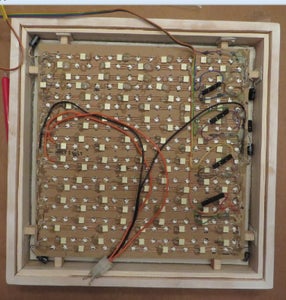

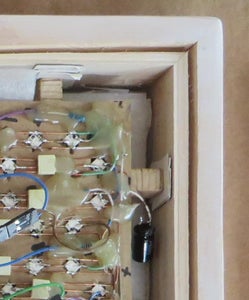

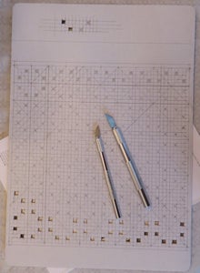

Step 4: Mounting the NeoPixels

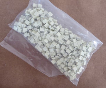

I mounted the LEDs on a piece of cardboard that was almost as thick as the LEDs. First draw the triangle distribution and then see where the center of each triangle is. This is where the LEDs should come. The LEDs are 5 by 5 mm, so I drew lines every 5 mm. Then cut out the cubicles.
Initially I thought to use LEDs on a printed circuit board. But I had ordered 500 pieces of individual LEDs because I did not yet know how much the display was going to be made. But when I wanted to solder it, it turned out that I could not solder straight ahead as was the case with the LEDs on a PCB. The solution was to turn them a quarter turn. I then made notches, but in retrospect it would have been better to make a new cardboard.
Assembly is done as follows, but if you have soldered the last one, you know exactly how it is it easiest to do.
Mark the LEDs on the back with a dot so that you know the connections. Then fill a row, 10 pieces. Secure the LEDs a little less than half way with a piece of adhesive tape. Take a piece of copper wire and place it over the free connections on the outside and secure it with some adhesive tape. Then solder a number of LEDs so that the wire is fixed. Then move the tape on the wire and solder the remaining LEDs. Then you solder the short connecting pieces of wire between the LEDs. When that's done, take the tape off the LEDs, You can use adhesive tape several times, and solder a piece of wire over the other outside in the same way as the first. I can't tell you exactly how to get started because that depends on whether you are handy left or right. In any case, solder in that direction so that you don't get in your way. Also do not solder the outer sides, plus and minus line first, because then the short pieces are difficult to solder. I made the tip of the soldering iron from a piece of 2.5 mm2 copper wire.
For the 5 volt power supply, I divided the LEDs into two groups. I did this to be able to use two USB connections. Connect all plus wires of the top 100 LEDs to each other and of the bottom 100. You can connect all the minus wires.
Because the specs of the LED indicate that there must be a capacitor on the power supply of the LED, I soldered one capacitor per two LEDs. I used what I had lying around. These are a bit on the large side in terms of dimensions. If I had to order new ones they would have been smaller.
Then six capacitors distributed over the whole and a resistor on the first LED. Then everything stuck with hot glue.
You can also use the LEDs on a printed circuit board, can be mounted in the same way and even a bit easier. So if you don't have much soldering experience I would recommend this one.
Step 5: Mounting the Grille in the Frame
Cut the cardboard with the LEDs a bit to size and then stick it on the grid. Do not be too sparing with the adhesive because it must be firmly attached all over otherwise you will get light from one compartment to the other. I glued two pieces of wood on each side to the grid so that it just fit into the frame. Centering was done by pushing a number of pieces of cardboard between them in such a way that the grid was firmly attached and exactly in the middle. You can check this well by holding the back up to the light and looking from the front.

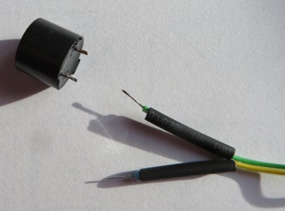

Reuse is the cheapest. An old desktop PC supplied the speaker, the LED, the capacitors for the LED board and the power cables and plug. The remote control is from an old HD recorder.

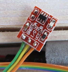

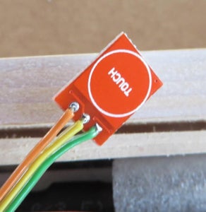

1 TTP223 Capacitieve Touch Switch Button, touch key to freeze the image

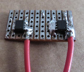

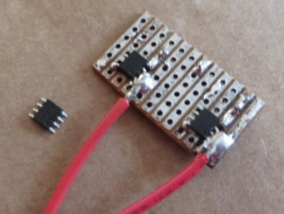

4 AO4409 P-Channel MOSFET
And a resistor of 100 and 2 * 470 ohms and 1 K and 470 K.

Which power supply do you need. Theoretically 5 volts and 12 amps, namely 200 leds * 20 mA * 3 for r g b led = 12000 mA.
FASTLED contains power management. So you can set the maximum power.
During the build I used a 1 amp power supply and had FASTLED set to 1000 mA. This worked fine but was a bit lacking for some displays. As a temporary and possibly definitive solution I now have a heavier USB power supply where I use two connections. I could get 2 amps from this twice, but I have set FASTLED to 2500 mA and this works fine. I divided the LEDs into two groups of 100 pieces each.
Warning, do not buy such a 5 volt 3 A plug power supply for a few euros, which would be multiple protected and which everyone in the review likes so much, because then you will really be disappointed.
I measured the current, see table, and the power consumption is with a full color image between 7 to 9 Watt. The arduino and the other components use 20 mA. The USB to TTL converter that is attached during programming uses 15 mA.

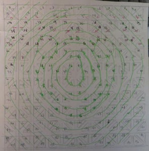

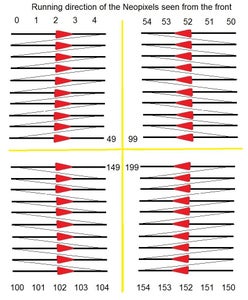

Step 8: Running Direction of the Neopixels Seen From the Front
The running direction of the Neopixels seen from the front is hardware based from left to right to left, etc. Software wise they go:
1) from right to left and then the next row from right to left.
2) back up from back to front
3) From top to bottom with first row of triangles down and second row of triangles
4) from top to bottom triangles alternately so that it is a square
5) back up from bottom to top to bottom triangles alternately so that it is a square
6) from the center clockwise around
7) from the center counterclockwise around
8) 45 degrees up from the bottom left
9) 45 degrees up from the bottom right

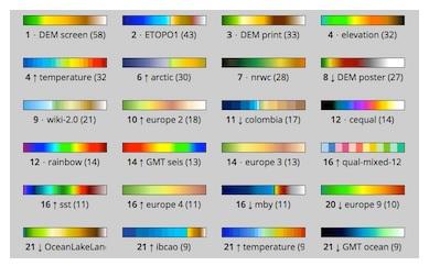

Step 9: How Do You Determine the Colors Yourself
The colors are Rainbow colors or are generated via the PaletteKnife for FastLED color palette.
By adjusting the color table you can determine the colors yourself. So if you want more red, green, blue or whatever color you want, you have the option to decide for yourself. Enough choice.
Adjustments in the table are processed automatically, so more or less color pallets is no problem.
Where one bumps into is the memory capacity of the processor. That is why I opted for pallets that require little memory.

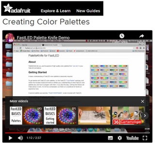

For more explanation with demo video about the PaletteKnife for FastLED color pallets see a.o.
adafruit, Creating Color Palettes
https://learn.adafruit.com/simple-beautiful-color-changing-light-strand/creating-color-palettes
https://learn.adafruit.com/twinkling-led-parasol/assembly

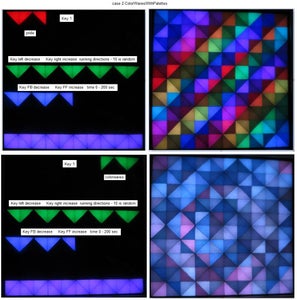

Step 12: Manual for Remote Control Settings

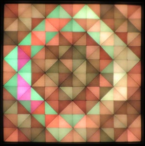

There is a choice of 9 different effects, namely
case 1 : triangels
case 2 : ColorWavesWithPalettes
case 3 : Smiley_Smill
case 4 : ChangePalettePeriodically
case 5 : full_rainbow_color
case 6 : chaos
case 7 : Fire2012WithPalette
case 8 : FixBeeld
case 9 : juggle

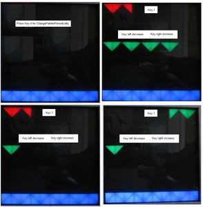

You press a button on the remote control. Then the blue LED turns on, see red circle, and when you hear a tone, press the OK button.
The double button is to make sure that you want to set and that it is not, for example, the TV remote control or similar.
Then a screen appears with a colored band at the bottom and black for the rest.
After that you make the choice 1 to 9. The screen that then appears shows the settings that may be associated with the pattern.
The settings for each pattern are as follows:
key 1 = case 1 triangels
Press key 1 then you can switch between red on the left, no border, and green on the right, with a border
Press key 3 then you can switch between left red is off and right green is random start color
Press key 5 then you can switch between left red is off and right green is random target color
Key 3 and 5 is most visible in the border color
Left and right keys fill the green triangles in the next line. This determines the number of animations, max 20, before the color changes
Keys FF and FB fill the blue triangles in the next line. Each triangle is 30 sec animation time with a maximum of 20 triangles which is 30 to 600 seconds.
T comes on after operating the remote control and then everything is entered correctly. When you press the remote control, the blue LED turns on. It may then take a while for the tone to come to press OK. The current process is finished first. For this reason, the touch key does not work here either.
key 2 = case 2 ColorWavesWithPalettes
Press key 1 then you can switch between left red "pride" and right green "colorwaves"
Key left and right fill the green triangles in the next line. With triangle 1 to 9 you make a choice from the 9 different running directions of the LEDs and 10 determines the direction randomly.
Press FF and FB fill the blue triangles in the next line. Each triangle is 10 seconds with a maximum of 20 triangles, which is 200 seconds.

key 4 = case 4 ChangePalettePeriodically
When pressing key 1, red on the left indicates that you can set the time and on the right green is a random time before the pattern changes. The random time is determined every time between 10 and 200 sec.
Key left and right fill the green triangles in the next line. Each triangle is 10 seconds with a maximum of 20 triangles, which is 200 seconds.

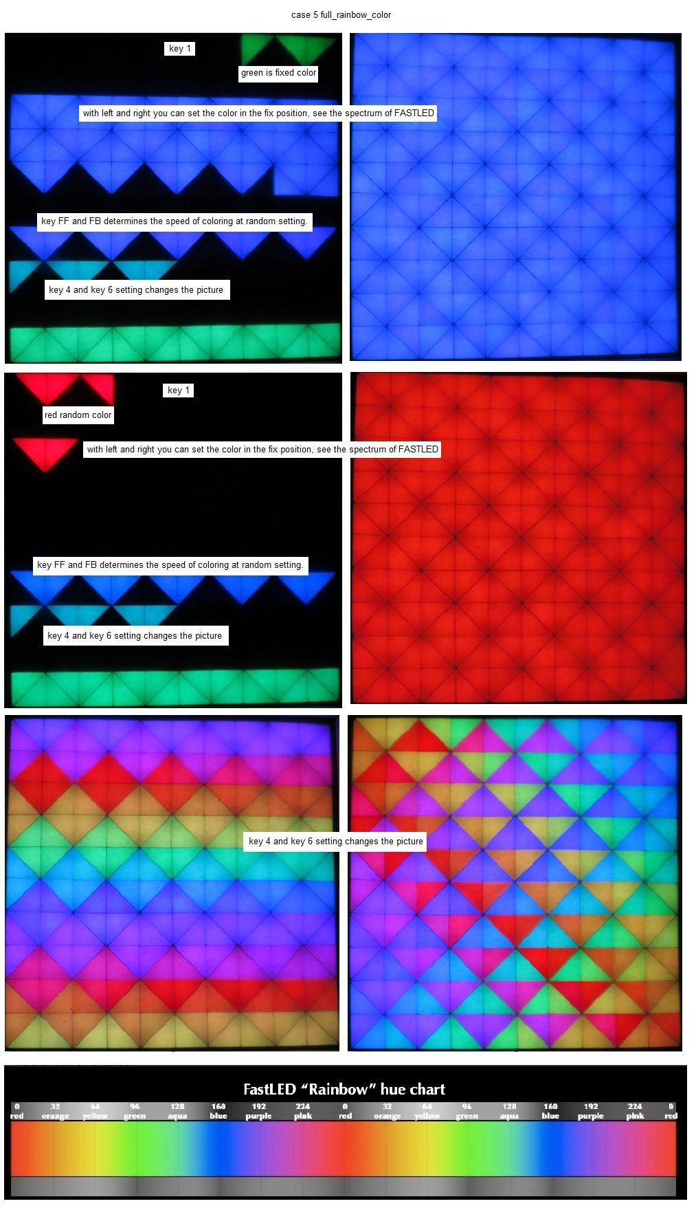

key 5 = case 5 full_rainbow_color
key 1 red random color and green is fixed color that is set with key left / right
key left and right you can set the first bar. This goes from 1 to 80. So in 80 steps over the entire color spectrum. The color you see is the color of the display which remains constant.
key FF and FB fill the blue triangles in the next line. Maximum of 20 triangles which determines the speed of coloring at random setting.
key 4 decrease and key 6 increase the number of colors of the whole image at random setting. Setting to 1 produces a continuously changing color for the entire display. Maximum setting is 20, whereby the image of the triangles always appears slightly different due to the coloring.

key 3 colored dots, which slowly weave together synchronously

I saw a “link” here an example of mirroring the patterns and found it a challenge to get them integrated into my display. I partially succeeded. I've divided the display into four and created blocks from 0 to 49 , 50 to 99 , 100 to 149 and 150 to 199. The four blocks are mirrored relative to each other. Within a block, smaller blocks of 2 by 4 LEDs can be made. In my case, 2.5 blocks fit horizontally and vertically.
Because the processor was already full of code, and could only access very little, I limited myself to mirroring 4 rows. This has been added to choice menu 2.
So the possibilities are
1) Mirror the four blocks
2) Flip 4 rows within a block and mirror it again to other blocks
For the color you can choose from random RGB where the new pattern comes on immediately or for the color palette where the color slowly changes to the new pattern.

1) If you use the MOSFETS connect the power supply directly to the NeoPixel.

1) Quantity here is set to 200 NeoPixels. If you have more you have to adjust this, if you have less no adjustment is necessary.
2) If the series is not fully completed, you run into a defective NeoPixel, replace it.
3) If a certain NeoPixel's color does not light up, it is defective, replace it.

Here the MOSFETS are tested. NeoPixels are turned on and off a number of times. If you first connected the power supply directly, connect them first.
If this doesn't work,
1) Check if the MOSFETS is connected to pin 9.
2) Check the connections of the MOSFETS, drain, source, and gate for proper connection
3) experiment with a different resistor value

Now you can test the touch key. When operated, NeoPixel 0 turns on or off and several other NeoPixels turn on. After 1 minutes the program continues, so no touch is no problem, just wait 1 minutes.
1) Check if the touch button is connected to pin 12.
2) Check the touch button connections.
