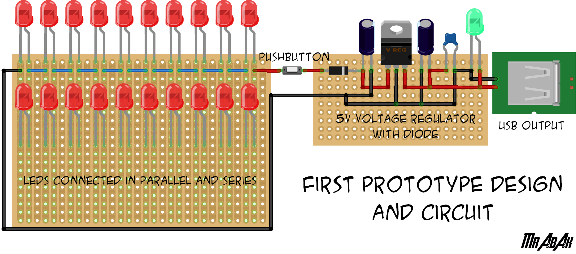

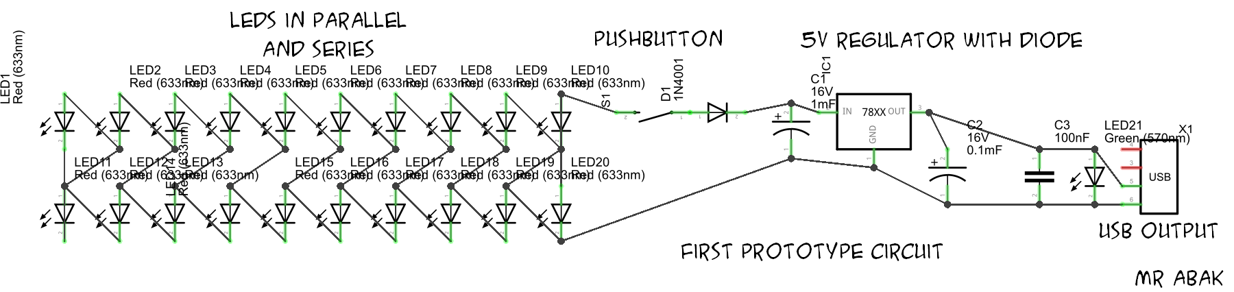

First Prototype:
Design
Circuit
We made this prototype first.In this prototype we needed a lot of LEDs and they all should face in same angle. Constructing this we found that it was a big version and needed some changes to make it more reliable and portable.

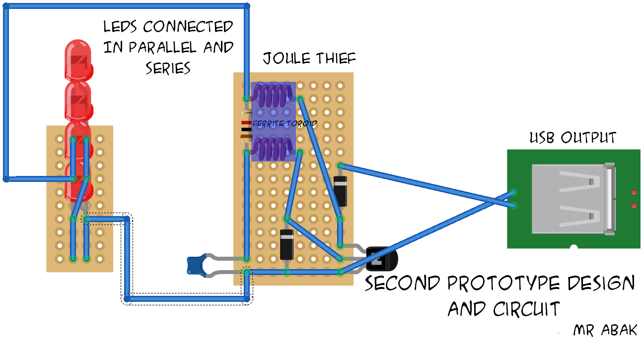

Second Prototype:
Design
Circuit
After first prototype we founded some changes and then developed entirely new circuit with minimal LEDs and minimal components. But what if there is no sunlight around? To find this answer we made another prototype.

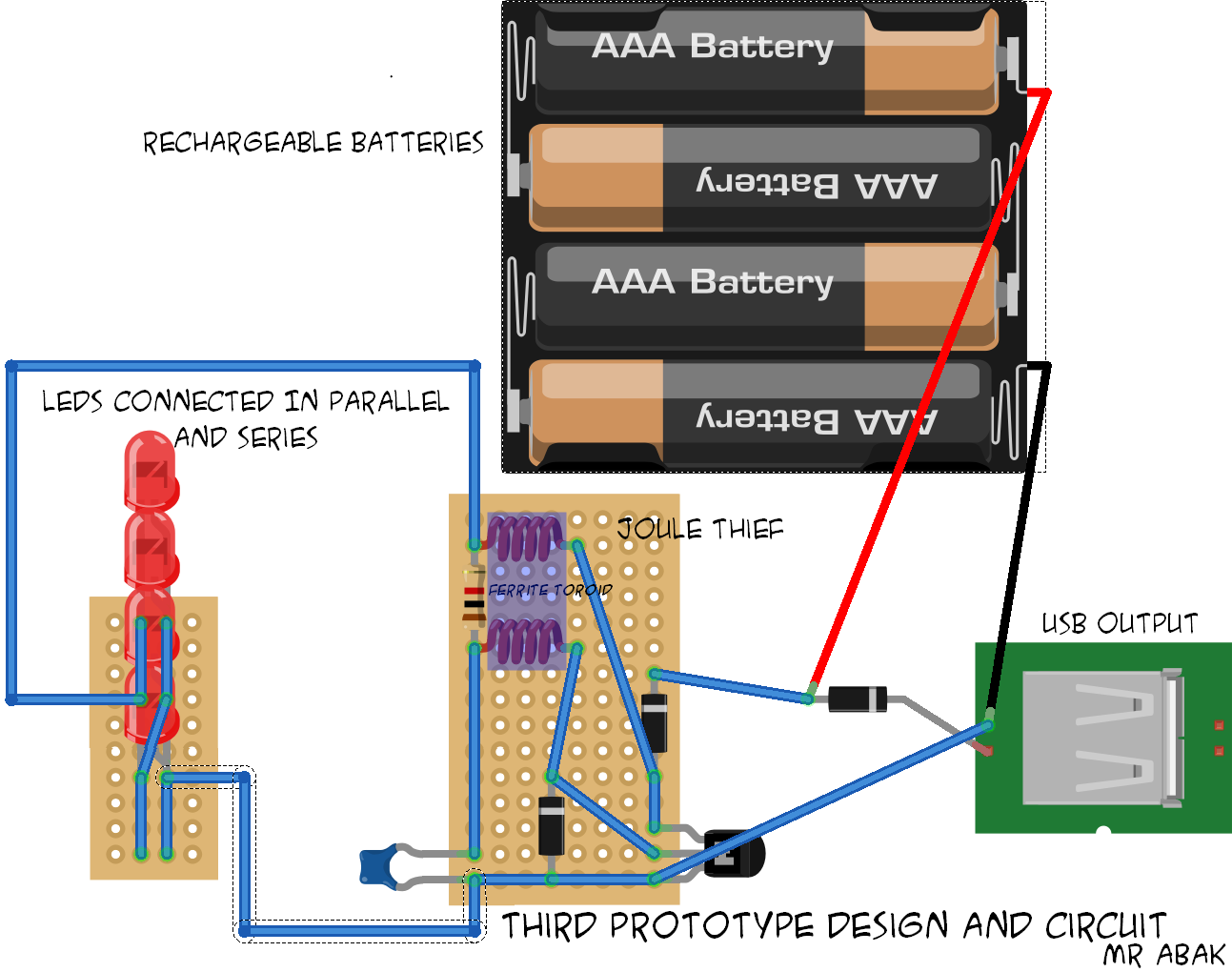

Third Prototype:
Design
This was the final prototype of LedUSB which gave output of 5.2v in minimum sunlight.This circuit is just same as second circuit but we have added rechargeable cells to improve its working. This is the circuit we are going to make in this instructable.

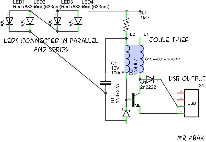

Step 8: Making the LED Circuit
Now let's start making the first and very important part of our project that is the LED Matrix.
Just take all four LEDs and solder each two in parallel as shown in the images.
Then solder the two groups in series and take out wires for positive and negative.

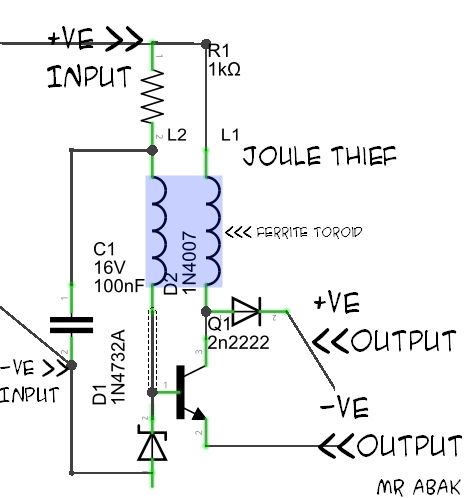

Step 10: Making the Joule Thief Circuit
First of all, place all the six components including the ferrite toroid on the perfboard. Make sure that everything fits perfectly on the perfboard and the perfboard should be of dimensions 2*3.5 = 7cm².
Then turn the perfboard and solder all the components as shown in images.
This completes the joule thief circuit.
Circuit-
Video Tutorial-
Step 11: Completing Circuit
Now take the LED matrix and solder its positive and negitive terminals to the joule thief circuit input.
And now take the USB port and solder it to the output of the joule thief as shown in images.

- It was a bigger version with around 25 LEDs
- It had indicators to indicate charging and working,etc.
- It had an on off switch
- It had some space left to store something like 9v batteries.
- It could charge 2 or more devices simultaneously.
- It wasted energy as it didn't used joule thief and used 7805 for regulated 5v output.
Future Prototypes-
- It needed ferrite toroid.
- It needed only 4 LEDs
- Less wastage of energy as no 7805 and use of joule thief.
- Little in size; can be stored anywhere like in pocket.
- It can charge only a device at a time.
- It needs OTG Cable or something like that.
Step 17: Using It and Testing
For using it just grab your OTG Cable or something like that and plug your phone and LedUSB into it.
Then place it into the sun for charging. But what if there's no sunlight or you want to use this in the evening. Remember about, an extra battery cap and 4 rechargeable cells??
Just connect them in series and connect a battery cap to it and then just plug it into the battery cap of the LedUSB.
